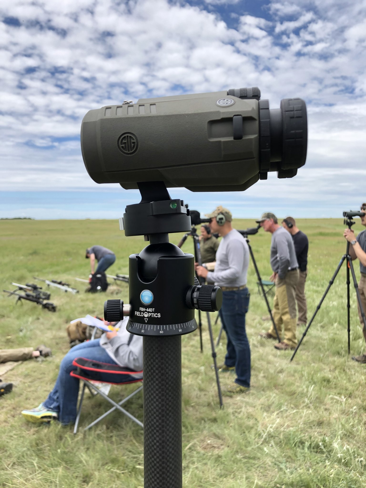

I have been using the Vortex ReconRT 15x50. It is a monocular with a mil based reticle. It has been handy to measure out targets before getting on the rifle. I would highly suggest looking into it.

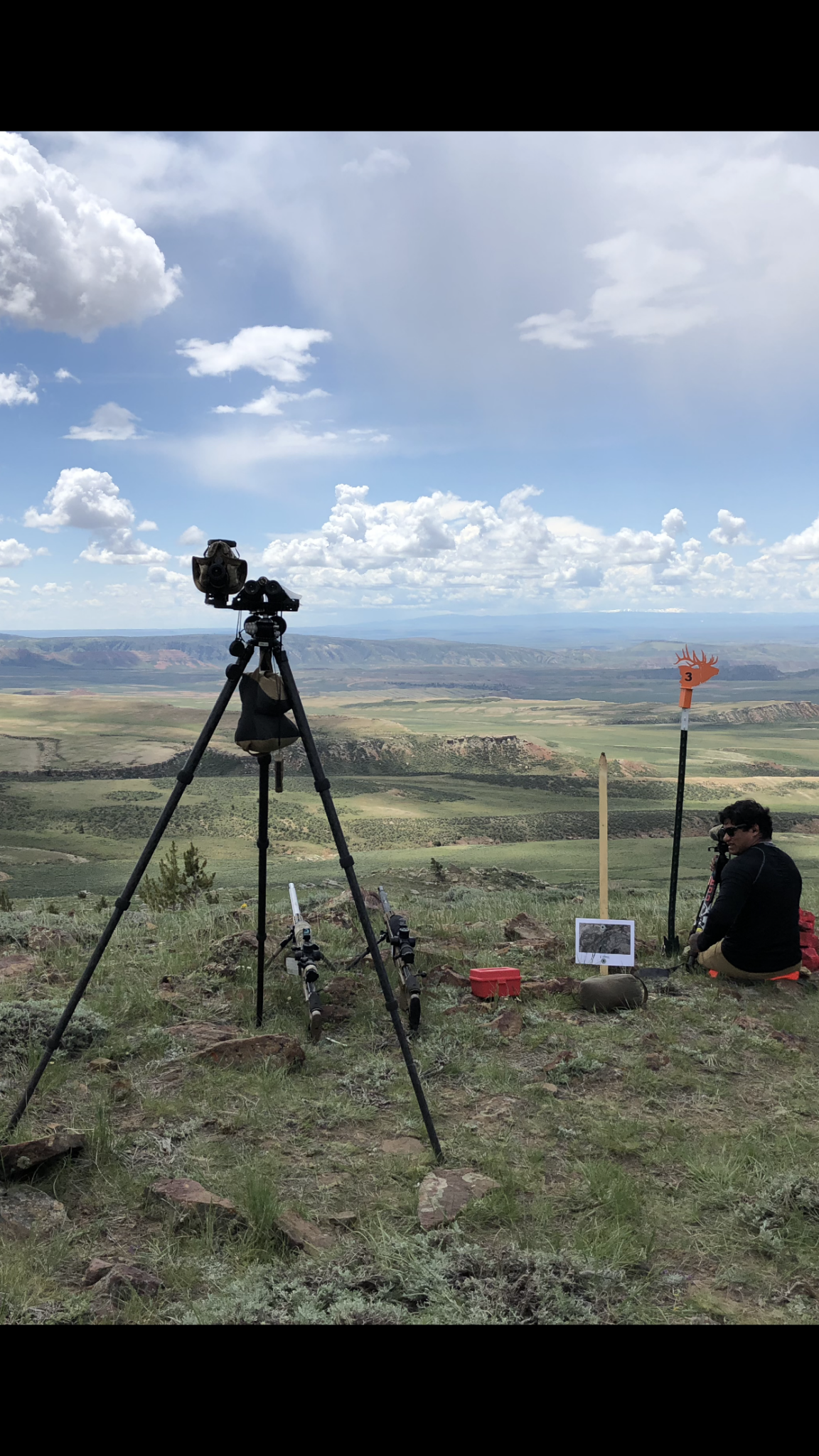

wyoming is high on my list of places to move to. really, there are only 3 places i was considering...new mexico, wyonmng, and idaho. talked to two gents from new mexico, and after talking to them, that has kinda been scratched off the list.
And to the OP, swaros can be had below your budget. Easily. And to my mind, if you are going to spend that much, why not get them? I picked up a pair not too long ago for under that.
