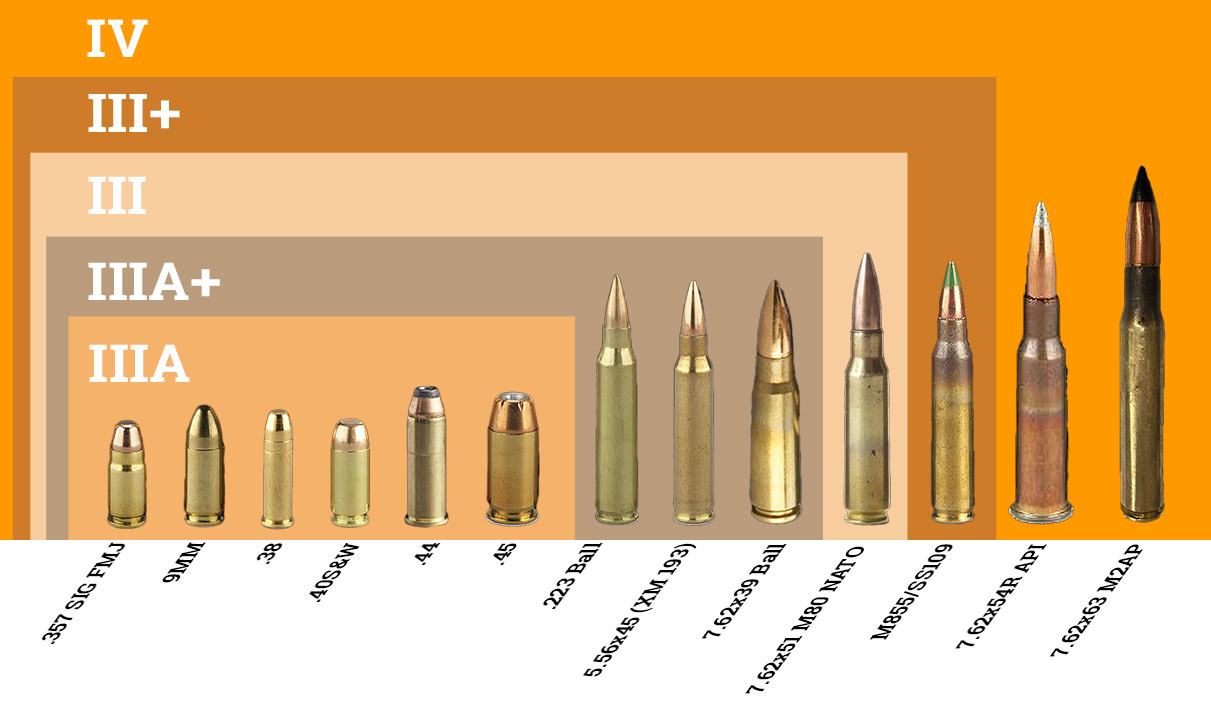

M193 and 7.62x39 will be stopped by lvl 3A.
M80 ball will be stopped by lvl3 plates.
Lvl3+ (not an official NIJ rating yet) will add M855 protection
Lvl4 will add 7.62x54R and 30.06 AP
The question here is lvl3+ or lvl4 and the weight difference.

One thing to watch is m193. Most armor limits m193 protection to 3150 fps, while there are a lot of 3300 and 3350 fps m193 out there. The same with m855, lots of hot loads out there. I run 2 different vests depending on what I am doing. Level 3a for running around and rma 3+ (level 4 side) for shtf. I figure there is little chance I will meet on ap 3006, and the multihit of level 3 makes more sense than single hit rating of level 4.
The bottom line is some body armor manufacturers make their own "threat level" system and grade their body armor
individually.
Level 4 does not always stop the same things.
Just a matter of paying attention to what you are buying.

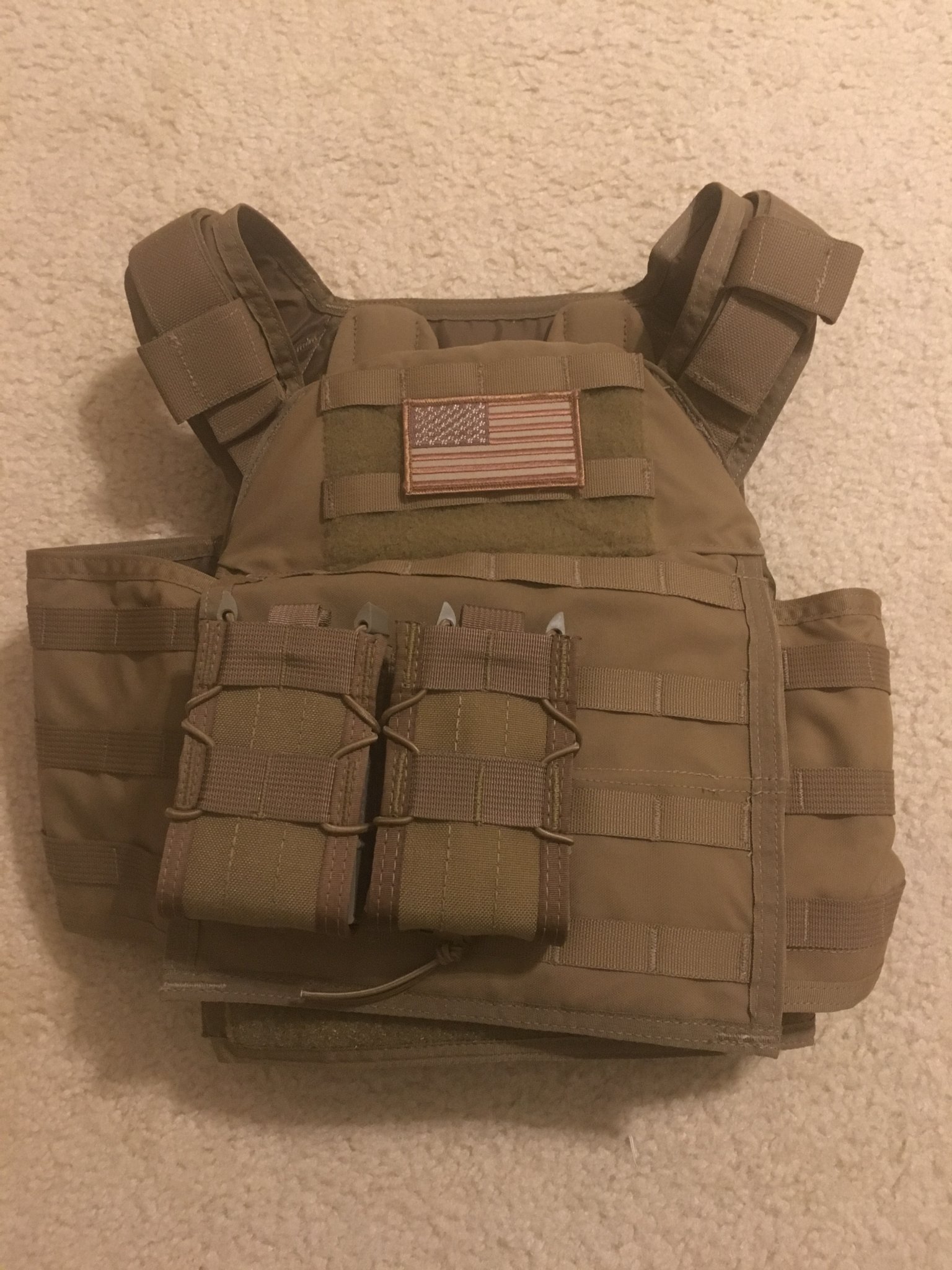

LMT, Crye, Ferro, Spiritus - all make slick/lower profile/minimalistic quality rigs that are reasonably priced and would pair perfectly with the plate specs above.
If you buy Rothco/Condor/wtf ever other airsoft carrier for your armor, then you deserve to choke on your e-cig after your shitty AR500 plate tears a hole in the bottom of your carrier and breaks 6 of your remaining 9 toes.

EDIT: 3.29.20: Got a set of Hesco L210s in and put them in a BFG v2 carrier. No live shooting in it yet, but do 100 yard to half mile sprints in it with zero complaints one the carrier broke in. The Hesco plates are very thin and lightweight while protecting from most rounds you may see.
Later this year or next year I plan on getting a Spiritus Systems LV119 Overt carrier with Hesco U210 plates.

I’m 6’ 210ish myself. The jpc 2.0 fits me perfect. I did not get the swimmer cut. The CPC is a full plate carrier and load bearing rig. 2 different use cases.
Get a Crye Precision JPC or JPC 2.0 (but you won’t have for at least 6 months unless you can find one in stock somewhere) then some Hesco L210’s with some IIIA as a backer. That will stop the majority of things you are likely to come I contact with. And, it won’t cost you $4000. I’d still expect to spend around $1000 tho for a set up by the time it’s all said and done.
Ac
actually is just ordered a new 2.0 recently and I had it in 3 weeks. Bought on Black Friday in my hands on 12/18.
