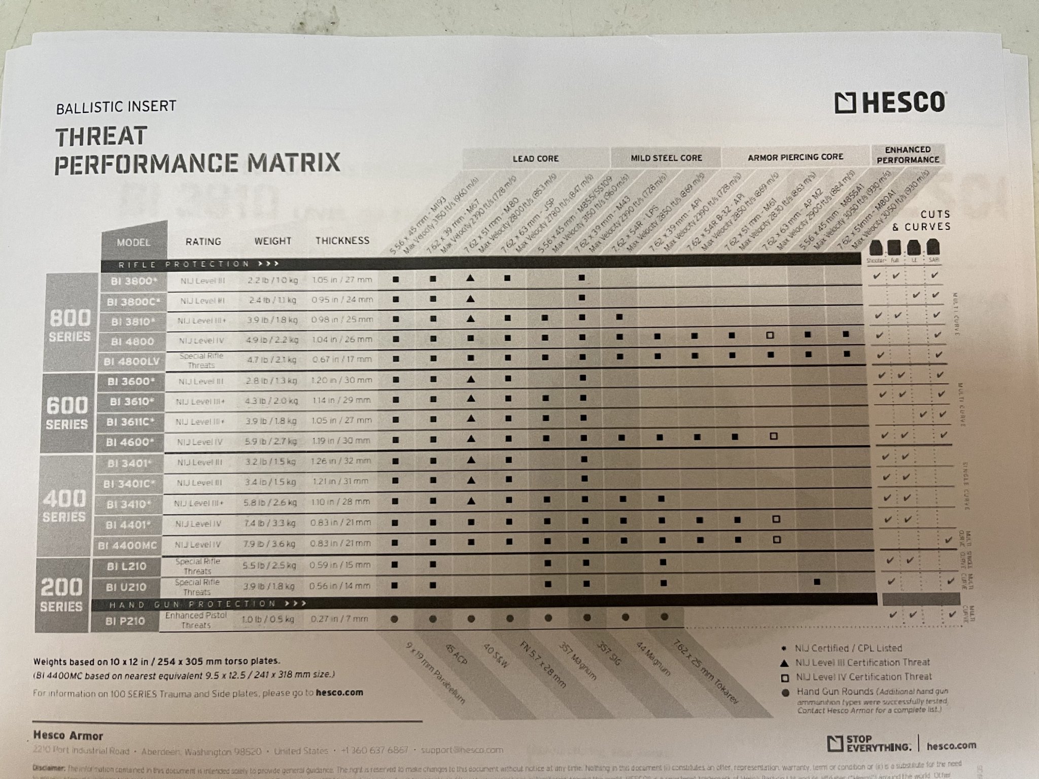

Are the Hesco L210’s NIJ certified? It really doesn't say on their website, just that they are special threat plates.
IIRC, the 210's are a "special threat" plate, and as such, meet no NIJ standard
Does that matter? What exactly is "special threat?"
It defeats AP 5.56, but not AP or point blank .30 cal (again, IIRC). Level IV defeats AP up to .30-06, Level III doesn't. L210's fit somewhere in the middle and are also not rated/tested for multi-hit suvivability (again, IIRC).

L210’s stop 5.56 Green Tip minimum 6x. They are in between level 3 and 4. But as mentioned they aren’t rated for .30 point blank AP. They are rated to stop 7.62x39. Pretty sure there are plenty of videos out there testing this stuff. If you want anything better than L210’s you are looking at north of $850 per plate. Just FYI. And I’m thinking with level III behind them it might stop a .30 AP even tho I’m not going to try it lol. Everything is a give and take.
Yeah I’m not spending $800 so these should work fine. It’s only for home defense (hopefully.) Is there anything special I should get with these like SAPI or non SAPI? Cut? I just bought a Crye JPC 2.0.

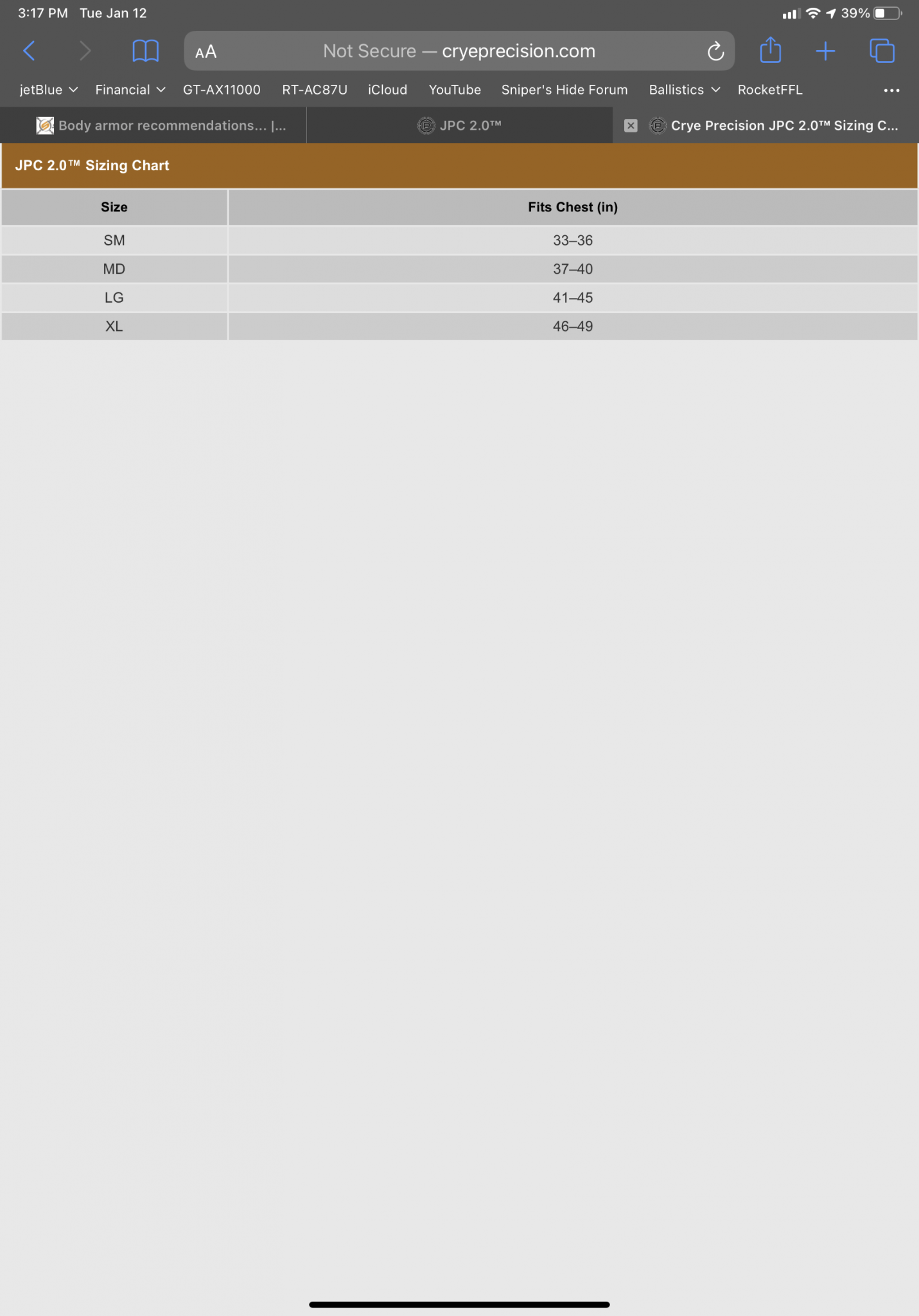

I measured my chest and it's 47. The Crye JPC 2.0 XL is between 46 and 49.
You did it backwards and probably want to cancel your order. 10x12’s should be used in a Medium carrier. You might email Crye and ask if they have any Medium Swimmer’s Cut carriers in stock, I bought mine at the worst time and they had them in stock. Swimmer’s cut aren’t as high demand and that’s what the L210 plates are.
I wear XL shirts, and I have a Medium plate carrier with 10x12’s. I’m going to switch to a more full featured carrier with Large SAPI’s just for the sake of my two setups needing to be more diverse than they are.

Actually the L210 says this, so it's not a swimmers cut: Enter the Hesco L210, a lightweight, single curve, multi-hit, standalone Special Threat Plate in Shooters Cut.
Shooter’s Cut is Swimmer’s Cut, just two different terms used by different companies - all plates that aren’t SAPI have slightly different cuts so it describes the style more than exacting dimensions. The L210 is a perfect fit in the Swimmer’s Cut JPC 2.0.

That is not how crye does it. If you look at their sizing guide, they base it off chest size.

You need to size the Crye PC for whatever Plate size you are buying. I know they have the sizing guide with chest measurements for some reason, but like was stated before, if you order an XL and put medium or 10x12 plates in them, there will be a lot of extra room in the plate bag as the plate bag will be sized for an XL SAPI plate.
We use Crye Carriers at work and they are sized based on the size of our SAPI plates.
Most companies size their carriers on SAPI Plate sizing, so a medium carrier will fit a medium SAPI plate and so forth. It gets more complicated because you have SAPI plate sizing, and then you have the civilian plates which are usually 10x12 with different cuts ie square, Shooter, Swimmer. Most Plate Carrier manufacturers make their medium carriers be able to accommodate a 10x12 plate also, since they are so common in the civilian realm.
