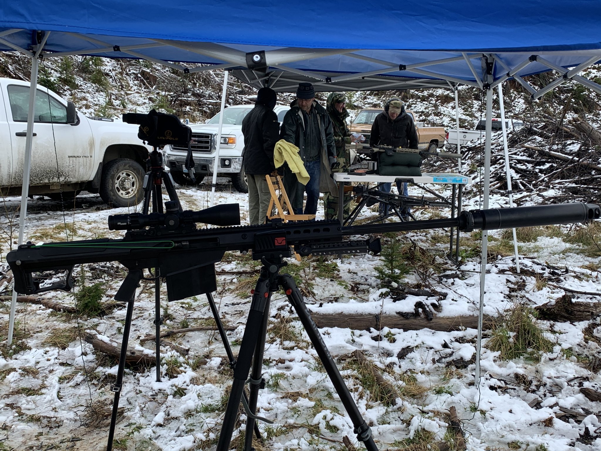

    I used a big death grip not to long ago. Seem to work decent. I don’t shoot much prs so don’t see the reason to spend 500+ on a tripod. My 300 win is 13 pound and sat in it pretty stable. The Barrett m107 was a bit of a challenge for it but I works.
