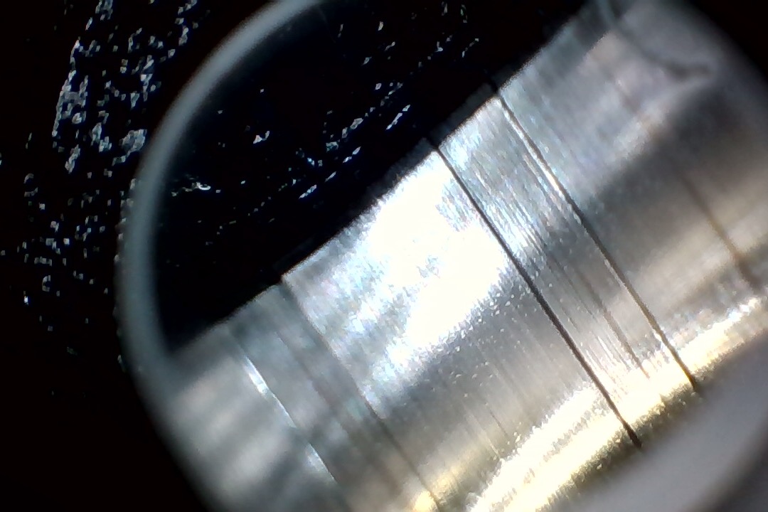

start of throat.

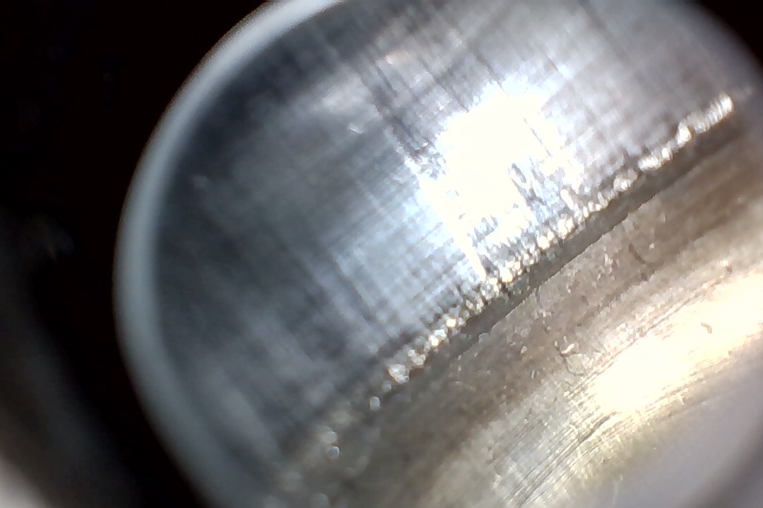

Crown, before brake

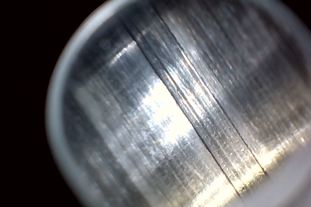

middle of bore
Should the entire bore be shiny?
As you put rounds on it the first 6-10" will get black no matter what. You can clean with abrasives to get it shiny again but it's not worth the effort. Does nothing other than look different (and potentially abrade away too much bore).
What causes this darkness?
Carbon fouling
Is it detrimental?
If you let it build up, yes. It will cause accuracy and pressure problems.
Did i ruin my barrel by only having ever cleaned with hoppes during break in?
Most likely not, but the more you let build up, the harder it is to clean out. I suggest cleaning every 100-200 rounds (depends on caliber, some overbore and/or magnum chamberings could handle every 50).
Carbon causing pressure signs?
Yes.
This puts my mind to rest...and my wallet...i had bartlein on standby.

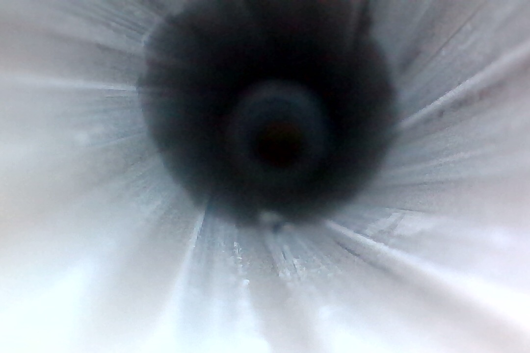

One more question.
Wth is this?
This is before cleaning and it is not a shadow...last 2" of the barrel.
