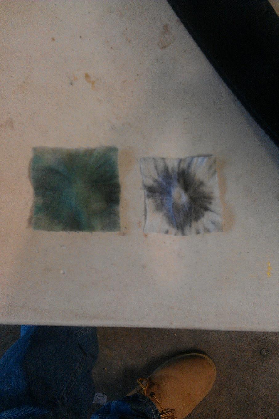

I'm pretty new to Long Range shooting, and thus long gun cleaning.. But my bore NEVER comes clean.. Can I get your opinions on my situation, please?
I am shooting a Savage Axis .308 (inexpensive but accurate starter rifle). I have put 338 rounds through it lifetime, and wet patch / dry patch after each range session (30-40 rounds), until the patches come out 99% clean. This time I decided to bronze brush it this time, and patches keep coming out dirty as heck. I wet patch with Hoppes #9 (wait 30 min), 10 strokes of the bronze brush, dry patch, and I am on my 30th cycle of this method.. Below are my first patch (LEFT), and latest patch (RIGHT), so you can see how dirty the patches still are.. Will this ever end?
However, before this deep cleaning project, the rifle was still shooting sub-MOA, so am I overly concerned about this?? Thanks :)
As info, the green patch wasnt that green when it first came out.. the patches seem to turn greener as they dry.. not sure why.

Hoppes #9 is an mildly aggressive, (arguably) nasty smelling, copper removing, solvent.
Guess what the above will do to a bronze brush? It will eat it and leave traces in your bore giving you a false positive that there's copper still in the bore (or the gun is still dirty no matter how many times I stroke the bore with a bronze brush).
Switch to non-bronze or copper brushes...more specifically, nylon brushes when using copper removing solvents.

Punkwood--step away from the cleaning solvents. You are killing your barrel with kindness.
I used to clean pretty much after every session...it just seemed to make sense. Then I found The Hide. Turns out my efforts were well-intentioned but almost counter-productive, and possibly damaging if taken to an extreme.
Give that pipe a good cleaning when accuracy drops off. For me that is somewhere north of ~250 rounds.
You will never get a 100% squeaky clean barrel...nor do you want to.

Ya, that is your barrel...
What do you think that solvent is sitting there eating for the 30 minutes you leave it too soak... When there is nothing for it to remove it will start in on the barrel.
Barrel cleaning solvents that turn blue/green aren't getting that color from barrel material. Just accumulated copper that's filling the "valleys" in the barrel groove finish.

Guys, stop worrying about a slight discoloration on the patch after cleaning. Brass Jags / Brushes will always leave a slight bluing on the patch no matter how clean your barrel is. More damage is done cleaning than shooting but there are a few rules to follow.
1. Stop cleaning after every range session. 1-200 rounds and clean is more than good enough
2. Only use a one piece coated rod like Dewey and a quality bore guide like the Mike Lucas
3. Use cotton flannel patches and brass core / bronze bristle brushes
4. Use a quality bore cleaner like Butches, Hoppes #9, Bore Tech eliminator etc.
5. Stop cleaning to bare barrel steel, it's not necessary

the copper starts to oxidize and form a green goo in the barrel... Don't really want to put 60k psi in front of it so generally do a quick clean every range trip to be safe. Am I worried for nothing?

The OP may now have a rough bore, the green is from the brush. I have all but given up on brushes. The only time I use one is when I purchase a used rifle and don't know if X bullets, lead bullets or coated bullets were sent down the bore. Sometimes I end up cleaning a turd but other times I find a diamond in the rough!!

The black you are seeing is the steel, cleaners don't care what you feed it, if you feed it stainless steel it will eat stainless steel which looks black.
Your barrel is not that dirty... I use no more than 8 patches start to finish, and only 4 strokes with a nylon brush and they come out fine.
