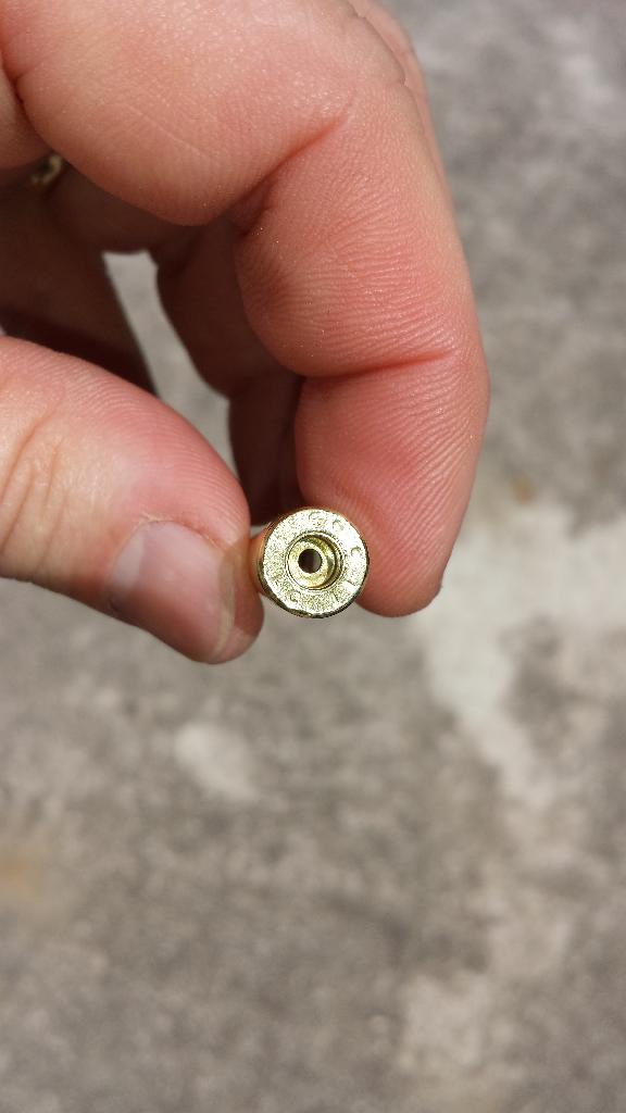

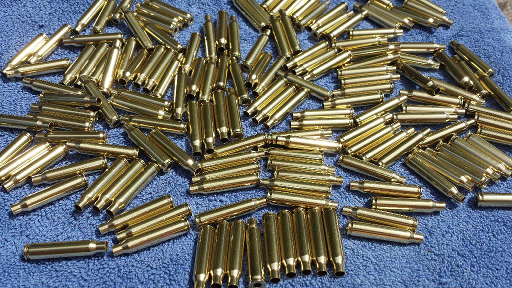

Looks like the Rebel 17 is a newer version of the one that I have. They addressed issues people were having with the original. If you think you will use it, get it IMO. I shoot 100% suppressed so the brass is dirty as hell. The pics show what come out on the other end. Not something I will have to replace so the investment was not a problem for me to justify. Hope this helps. If you have any questions, call the guys at SSM, they are very friendly and very helpful.

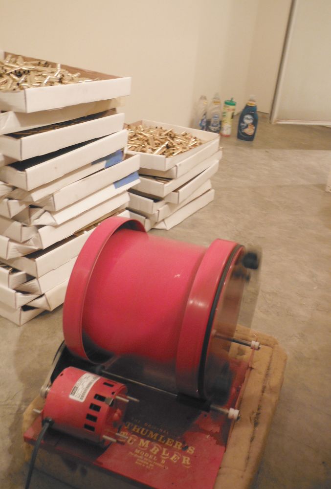

I just ran ~36 loads of brass through the Thumber's Tumbler, stainless media, Dawn, and Lemi Shine I heard about here on SH reloading ~~ 2.5 years ago.
Thumler's Tumbler Model B High Speed Rotary Case Tumbler 110 Volt
I replaced the wing nuts with 5 knobs from ENCO
328-2259 1/4-20 A5 LOBE GIBRALTAR SOFT TOUCHKNOB 6 1.54 $9.24
