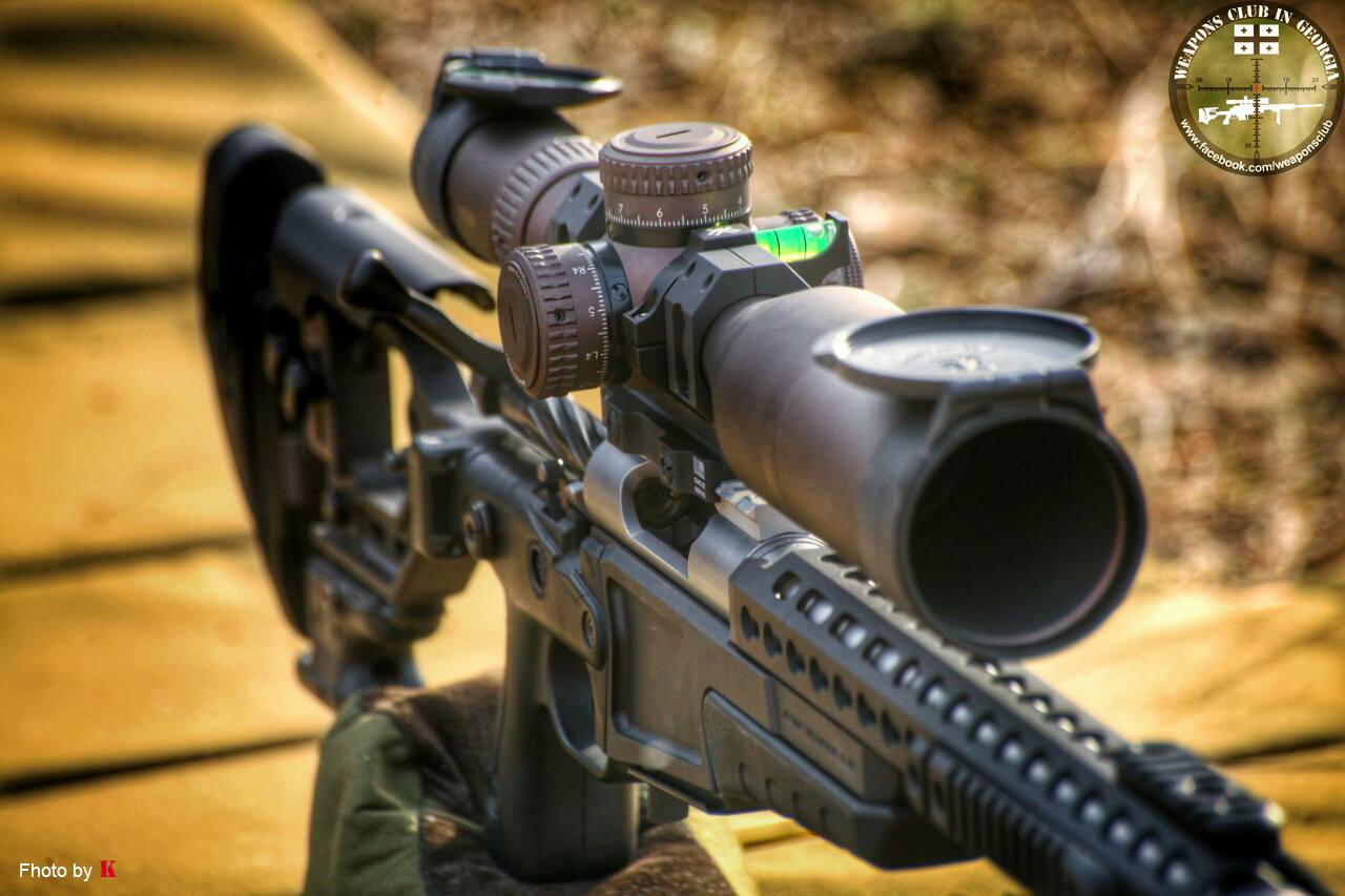

I found the level helps with my body alignment
Since my shoulder op, I've struggled to be aware of my posture.
Filmed myself prone, was surprised how kaka my positioning was, and the skew on my rifle.
Since the bubble level went on, it's helped me immensely.
There are varying opinions, but it works for me.👍

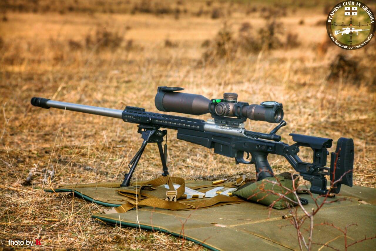

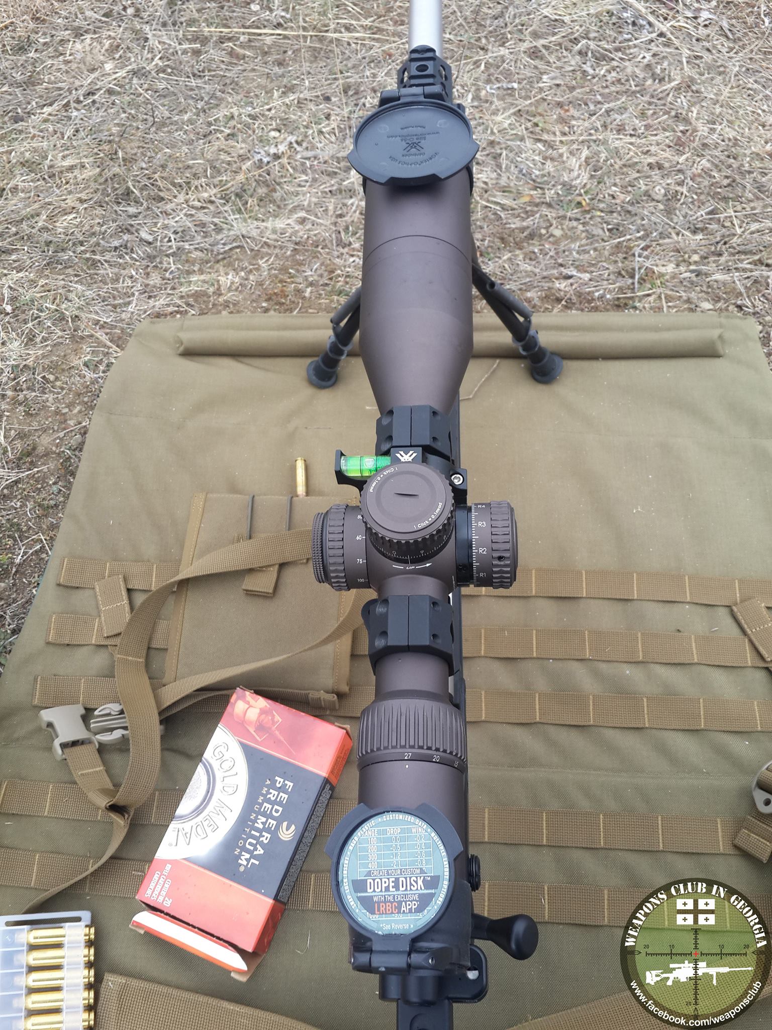

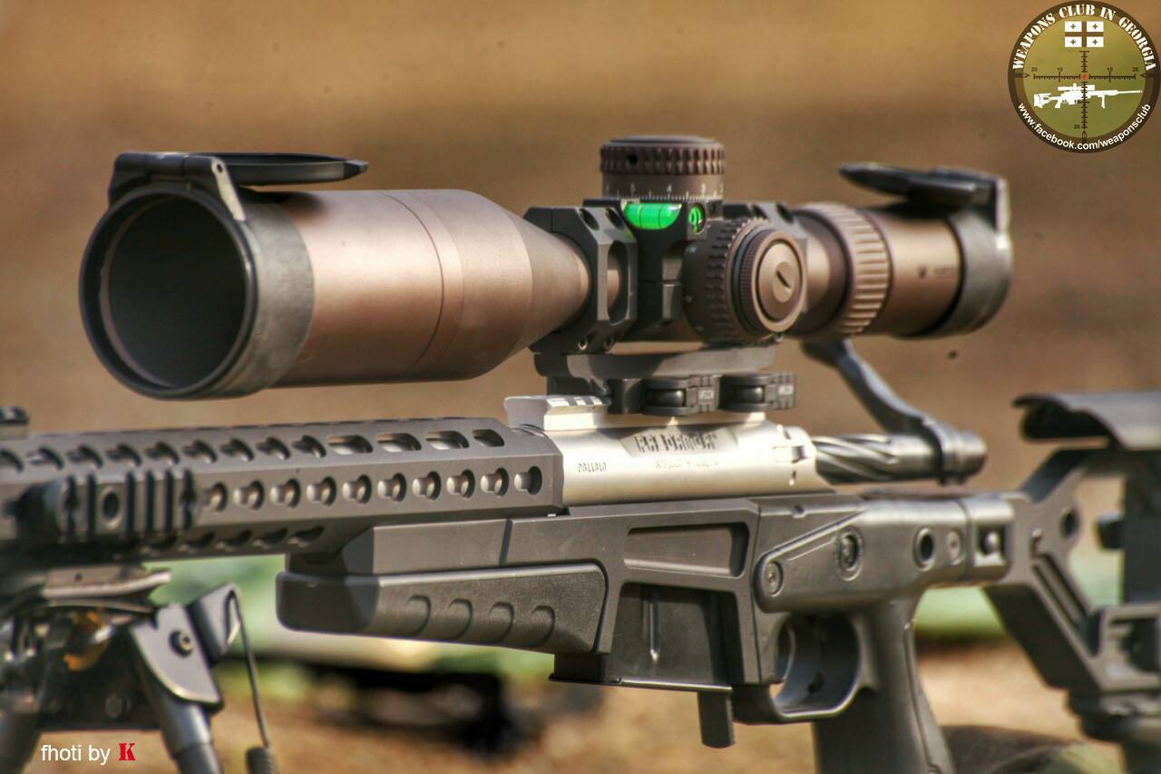

I have all my scopes with the bubble behind the turret on the left-hand side. Now I've upgraded to a Vortex bubble that is unfortunately more "massive" in its frame. This prevents me from seeing and adjusting the parallax knob on the left side of the turret easily. I'm thinking of moving the bubble in front of the turret. What do you all think? Any advice or cons to doing so?

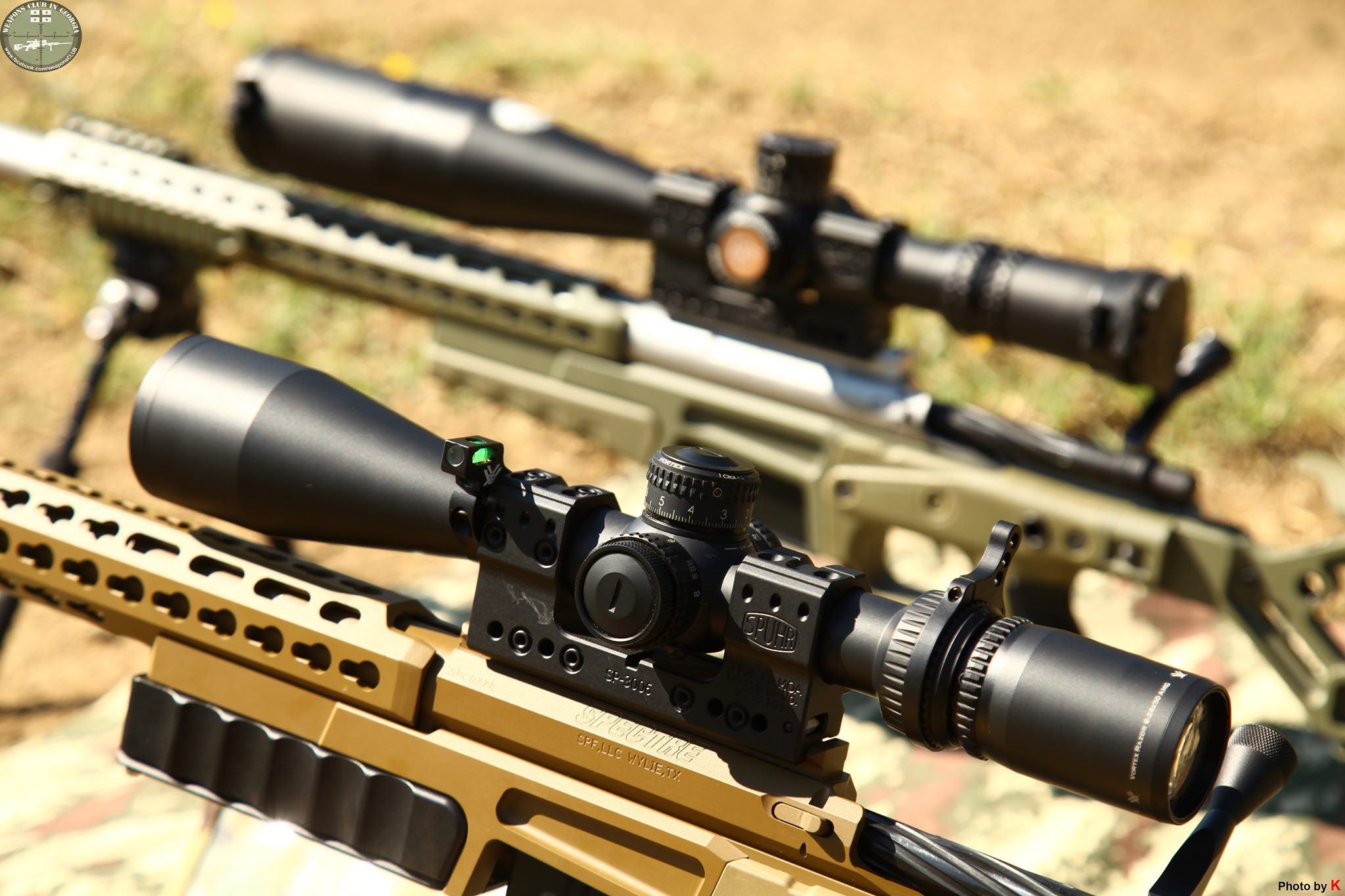

Wheeler make rings with a fold up level on the rear ring check them out. the rings screw together at an angle flat on one side and bubble folds down. Stiener has level in the middle bottom of rings. there are alternatives out there.

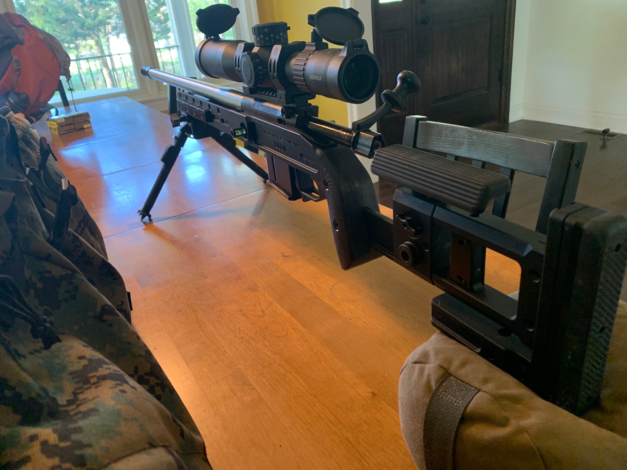

My levels are all in front of the turrets and suite me fine, but I've never tried them behind the turret so don't know if I'm a qualified comment. I learned to keep both eyes open with one eye on the level and one in the glass, but as I've aged I've reverted to the one-eye squint through the glass.
Answer to OP - Yes in front of turret as far as possible for my aging eyes. Upper left side for scope mounted (I'm a righty).
My favorite level is very expensive, but the chassis is included.
Honestly I thought it was a bit gimmicky at first but damn if it isn't in the perfect spot.
I can see it with either eye while in the scope. Same applies to lefty shooters since it pops out either side & or stows flush when you don't need it.

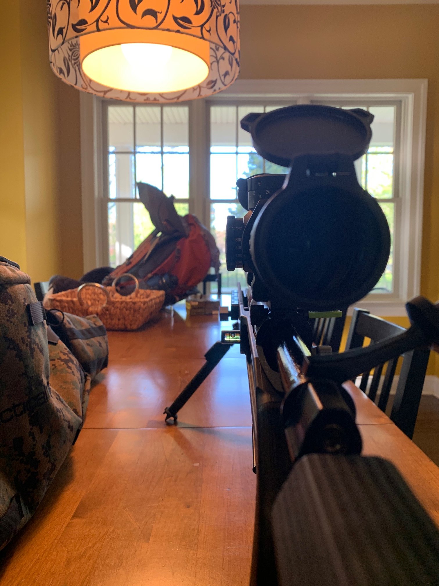

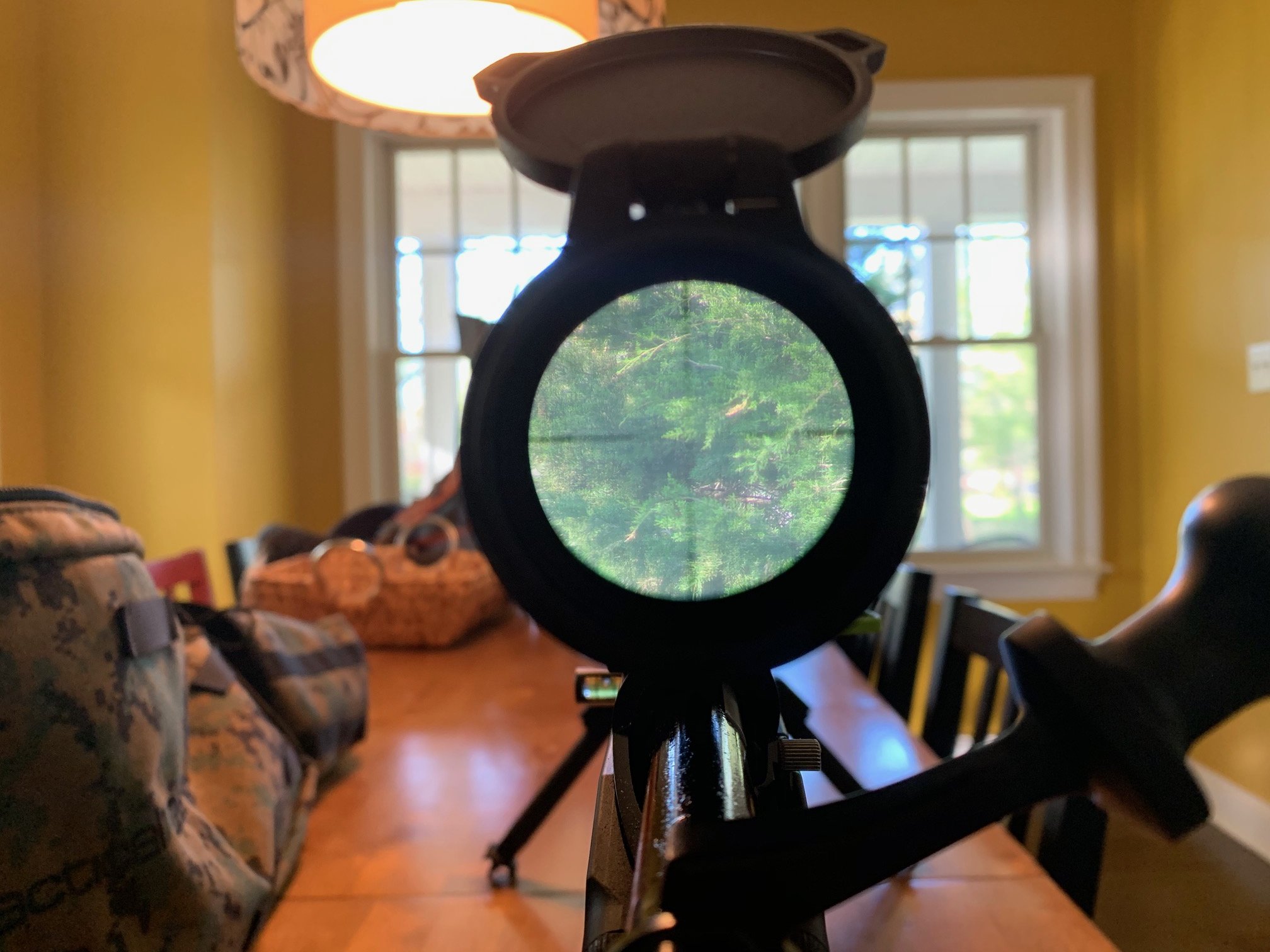

I'm pretty Green to precision rifle; so for me anyhow, levels have a utility. Shot my first PRS match last weekend & used the level on 3 of 8 stages. 2 were at 700 with position changes. The other was my first time shooting off a tripod & there where 2 targets with about a 100y swing between them, 1 shot move back and fourth. The tripod was set up with the head about 5- 7 degrees out of level & I shot with the ball head just tensioned, didn't lock it, so it really helped me on that stage in particular. Even on the tripod stage I wasn't checking the level every shot. Used it at the start 1st target to get frame of reference as to what level looks like through the scope, then took a quick glance at it about 2/3rds the way through the string second/far target to make sure I wasn't out to lunch.
Eye in the scope view.
Off eye view.

For the OP: I prefer the level out in front of the turret and further away from my eye, I shoot both eyes open and I think having it further away makes it easier to monitor the level just by switching my focus. I actually hate when the level is closer to the back of the scope.
