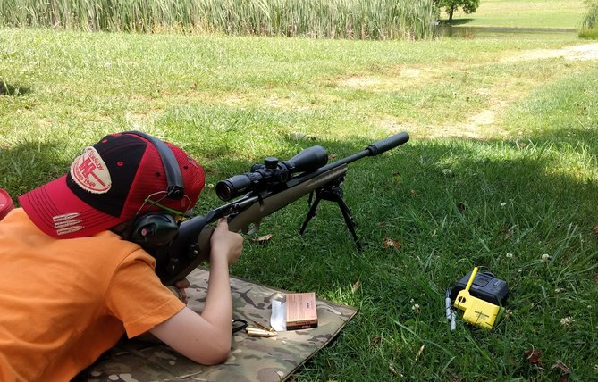

Finally got him out to shoot this thing! I still think the LOP is a tad long for him. He had fun though.
Question: I've little to no experience with the .223/5.56 cartridge outside using it in an M16A2 while in the Corps. We had a helluva time connecting on a 12" plate at 473-yds Saturday with PMC 55-gr ammo.
Is that to be expected? I am just starting to investigate reloading for .223...what's a good load/bullet to start for his gun? Thanks in advance!
473 yards is getting out there a good ways, especially for bulk fmj ammo coming out of a 16" barrel. Reloading will make it way better but its still a good distance chip shot.Reloading should tighten up your groups and loading a superior bullet will help it preform better at range.
That rifle has a 1:8 twist so even the 75-77 bulk would be better at distance over the 55 grain.

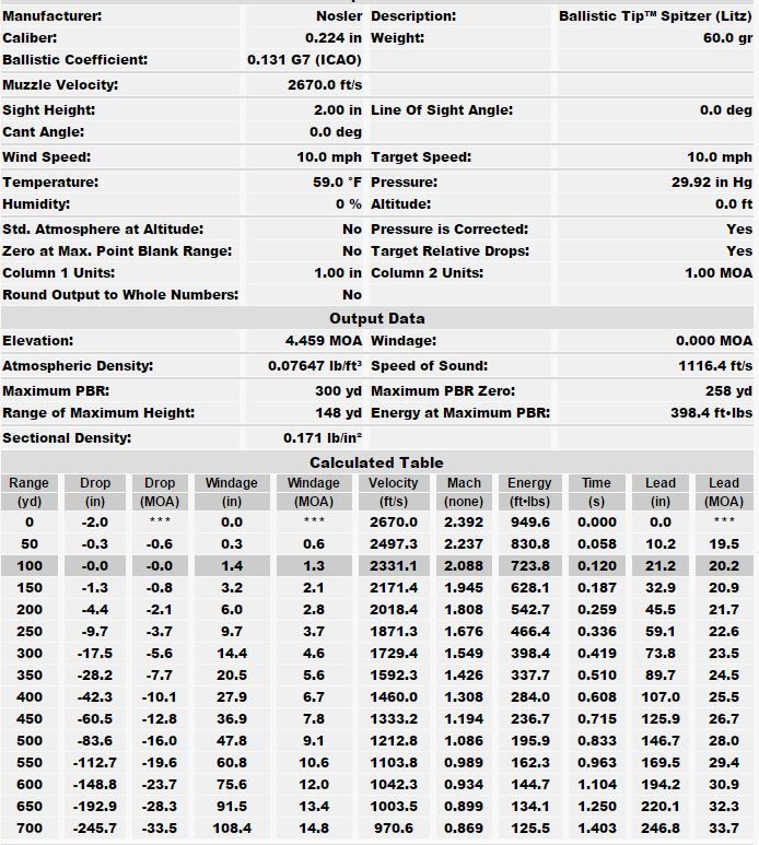

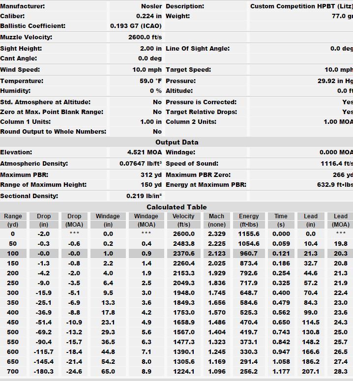

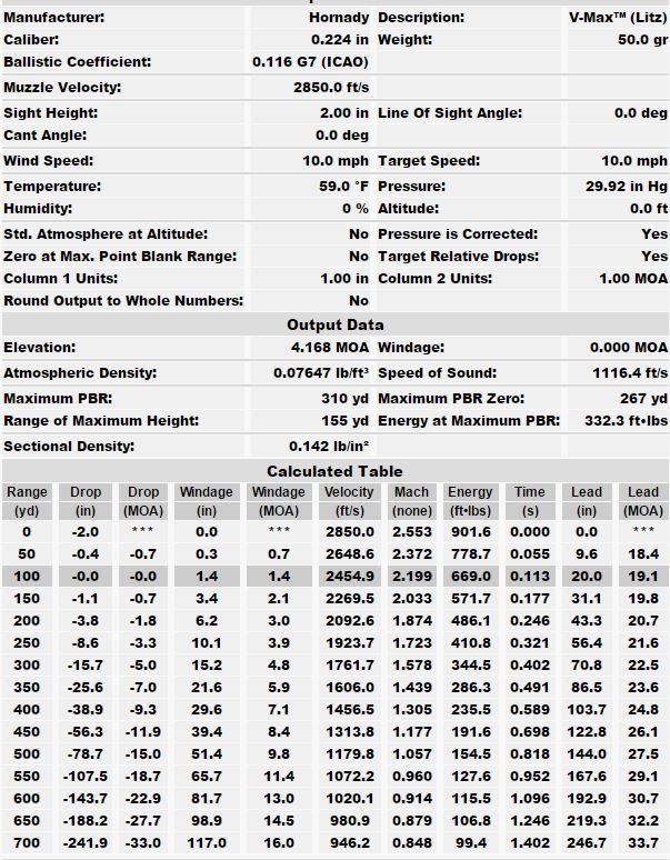

Run some different simulations on here and see what looks best to you. Here are a couple samples, bullet and velocities being the one thing that changes
http://www.jbmballistics.com/cgi-bin...j_simp-5.1.cgi

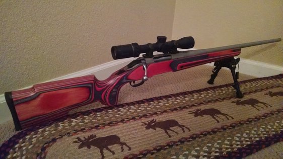

This rifle will fit the youth and be upgradeable with this stock when the time comes for it to fit a full-sized young shooter. In the meantime, I hope your youth shoots the heck out of it, so the barrel can be reasonably replaced with one of these.
I can't say for certain that the 75gr HPBT-M will do OK in the 20" barrel, but I'm pretty sure that 69gr match loads would. At 600yd, the 69gr doesn't need to make excuses to anyone. I don't expect to be using my 75gr load at 1000yd. I have a .260 for that distance.
Yeah, it's pink. I recall the Johnnie Cash song about a boy named Sue. Pink is just another color. If it means anything, I use pink as an identifier color for my own property because, well, who else would use it? When I see that pink, it's a pretty safe bet I'm looking at my own property. Besides there's the little Sister to consider. Really, the rifle will serve them both, and when the time comes, the boy's either gonna be done with.guns, or worth buying another one, full size. If he faces adversity for it, well, character gets built in many ways.
