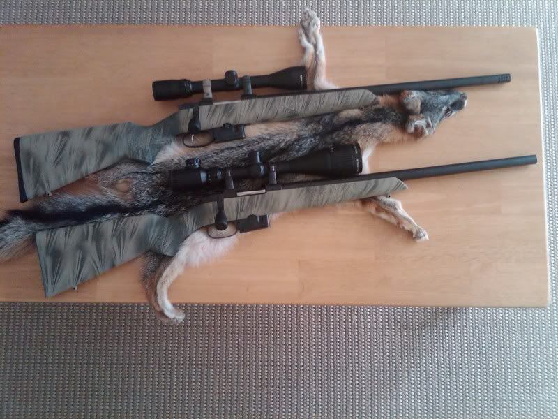

The top is a CZ527 in .17 Remington, and the bottom is a CZ527 in .223. They aren't exactly tacticool, but they will both shoot the lights out of every custom I own. 5 round mag, tiny action. I cut both down to 18", added badger knobs, bedded them, etc. the .223 started out as a varmint kevlar, but I want them to match, so I sold the stock on got the wooden American.
If you are looking for a real use rifle in a lightweight platform, this is how I would go.

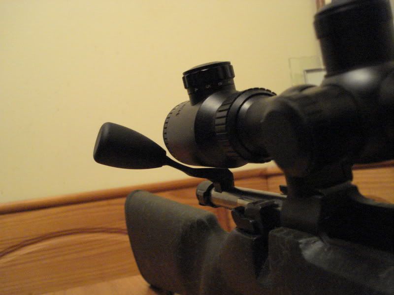

You will have to modify the bolt handle like this in order to clear large objective scopes.
