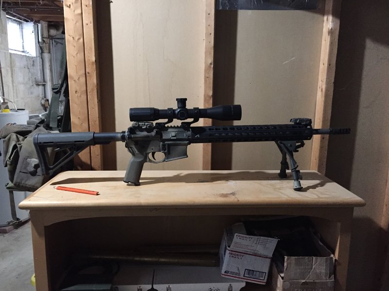

I built this rifle on a rainier arms 18” Wylde barrel, with a geissele national match trigger. The rest of the lpk and the bcg are PSA. Shot well for 60rds after which the trigger locked and would not discharge rounds. I’m of the opinion that the bcg is the issue. Any thoughts?

Have you disassembled the rifle to see if there are any obstructions in the fire control? I hate to be super-basic, but given the provided information, that's where we'll need to start.
So you pulled the trigger. The round discharged and the bolt remained closed? Did the round exit the barrel? Can you manually cycle the bolt?
I would first try to manually cycle the weapon.
i would then take upper out and remove bcg
inspect the barrel, bolt face, and trigger group

no, round loaded but would not discharge as the trigger was locked back. I manually cycled the bolt but again the trigger would not release.
It does fire without the upper installed. I called Geissele about the trigger, which is installed correctly. The BCG is also assembled correctly. I was wondering if the PSA bolt is the issue.
I'm going to pull the trigger on another BCG and see what happens. I have removed and re-installed the trigger also. Unless I let the BCG slap into place it doesn't always go into battery. I will report back as soon as I can and probably contact PSA also. Thanks guys.

I stripped and reassembled the BCG again and could find no issues there, it was clean and assembled correctly. I noticed before the incident occurred that letting the BCG slam into battery was the only way it would function. If I let it slide in gently it would not go into battery even with the aid of the forward assist.
I reported the issue to PSA and they sent me a form to fill for a return so they could generate a label, that was two days ago and I haven't heard back from them yet. I wonder if it is a problem with the finish on the BCG as there is no way my Rainier Barrel or Geissele High Speed National Match Trigger are at fault, at least by my reckoning. I did order some LPK's from Sons of Liberty and a Toolcraft BCG which arrived today. The next time the weather permits me to get out to the range I will report back.
