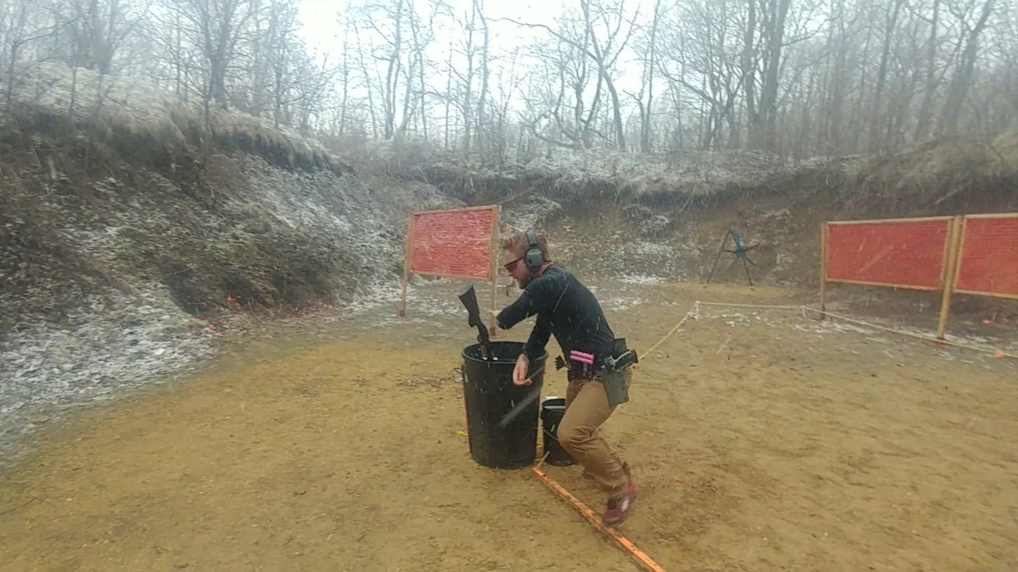

My new build ran like a champ yesterday. Very flat shooting with a slight push straight back.
Ps don’t hate on my fishing shirt. Kept me cool in the sun.

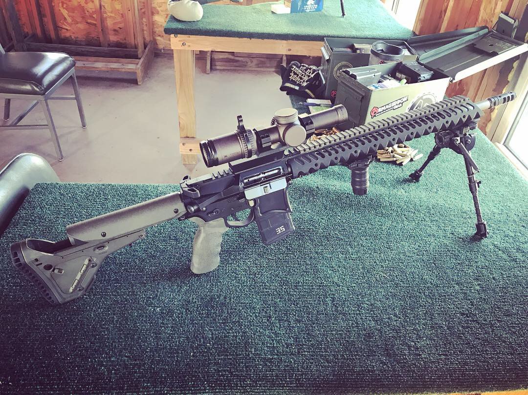

Something like this... a little heavy for some 3 gunners, but man it is stupid accurate with that Rainier Ultramatch barrel! Perfect for those longer shots too. Specs are: 18” Rainier UM barrel, Lantac dragon brake, JP/Syrac adj gas block, Diamondhead handguard, Seekins Precision Upper/lower receiver set, Geisselle SD-E, Badass ambi safety, Ergo grip, AXTS Raptor charging handle, Magpul UBR stock, JP SCS, JP LMOS BCG with JP bolt...?
