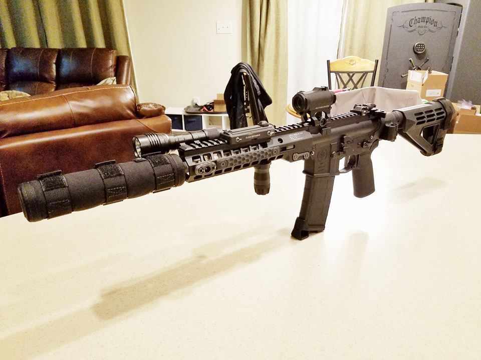

I'd say always include a budget. Building AR's can get nuts. Also are you aiming to be as clone correct as you can or doing your own variant? I did my own version of a MK18.
BCG - Sand Cutter. Bootleg Adjustable if you want options and convenience. SOLGW. FCD.
Lower - Aero at the minimum. PWS. SOLGW. FCD. Noveske. Can get a little fancy if you want. Radian.
Trigger - Geissele. ALG if super budget.
Parts Kit - SOLGW LPK. The bare one without grip or FCG.
Flash Hider - Will it be suppressed? Then QD. Would you want a foregrip? It is possible to hit the 26.1" OAL pinned/welded to be "other firearm". Not familiar with your state on that one. If suppressed, that limits your options. Definitely flash hider for the short barrel, I prefer something with mitigation (options). So Surefire flash hider that can use the Surefire Warden and eventually host for a Surefire RC2.
Tube/Buffer/Spring - FCD/VLTOR A5 and Sprinco Springs. I think I went with a JP SCS in mine with adapter and bottom plug for length.
If you're interested in my build list, let me know. I have it on a spreadsheet somewhere, just can't access it right now. Since the picture I did get the matching front sight and melted that suppressor cover.
