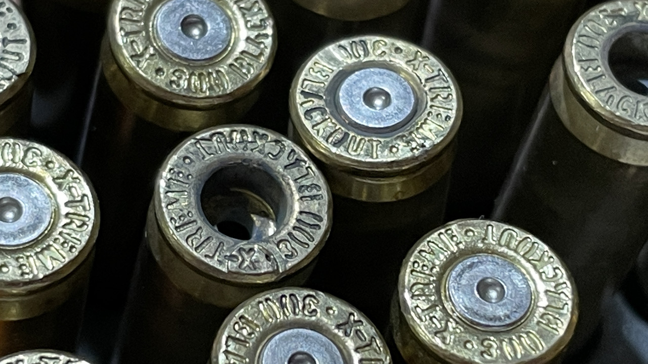

    Having an issue with bullet setback in the case, Hornady Sub-X, 190gr. 300 blackout.
    I was getting ready to load a bunch of rounds and was experimenting with neck tension and crimping. On a whim, I loaded up a dummy round with the bullets in question and dropped the bolt on it. After ejecting it there was significant bullet setback along with a gouge in the bullet (see photos). I tried crimping the bullet, really crimping, same result. So I pulled the firing pin and loaded a factory Sub-X round. Same thing, bullet setback and the gouge.
    I then took another sub round, S&B 200gr. FMJ. I've shot just under an MOA at 100 yards with the S&B's so I know they work. Did the same thing, dropped the bolt on one and no bullet setback, no gouge.
    Interestingly enough I did shoot the factory Hornady Sub-X load and was sort of surprised at how inaccurate they were in comparison. There are very few expanding 300 blackout sub bullets that are available and somewhat affordable so I went with them figuring I could improve on the factory load.
    Barrel is a Faxon match grade stainless/nitrided. The gun shoots everything and I've never had a FTF with it. I've also shot a bunch of hand-loaded Berry's 220gr bullets and I haven't notice any issues with them and for the price, they're pretty darn accurate, enough for fun plinking anyway.
    I tried two different bolts, same results. I'm guessing it's down to the bullet's profile? Anything I can do short of changing the barrel? I have about 800 of these suckers and it'd be a blow if I couldn't use them. The rifle is also a form 1 so I'm stuck with the length at 10.5" which really limits my options as well.
    Solutions?

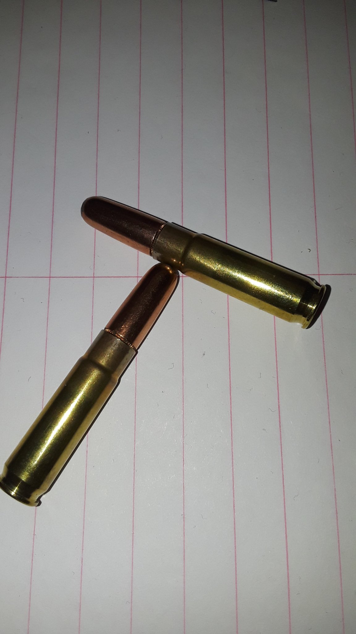

    Photos...my load, super crimped (intentionally).

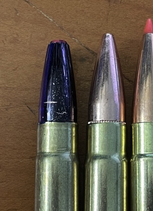

    S&B's, one on the right has been chambered.
    Factory Hornady round chambered

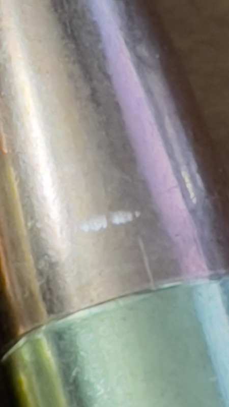

    Weird for me, to see horizontal gouges.
    On a long shot... can you permanent marker one half of the case head face , and carefully rechamber a round ( taking note of where the marking is ) to see if the gouges are from the top or bottom ?
    Could the entrance to the chamber be "sharp", at the radius in ?
    And what is the "comma" looking mark on both the Hornady bullets, at the top of the brass neck, on the bullets ?

    I would polish the edge in question... a over sized bore mop ( so it can't go in chamber ) , at that edge , with polish has worked for me. Spun via a piece of USGI cleaning rod.
    There are horizontal marks which are light scratches and not deep. The comma is where it's digging in to something and causing the bullet to set back into the case. The longer I seat the bullet, the smaller that mark but it's always just before the case neck. I cleaned the barrel/throat just to make sure there wasn't something in there but it did it even after cleaning. The gouge/mark is definitely deep enough to catch a nail on it.

    The nose of the bullet kinda gets bounced around (almost flicked downward) and I think it's slamming onto the lower portion of the throat, causing that mark. It seems to happen, if I'm doing this in slow motion, right as the round pops out of the magazine completely, past the feed lips. Maybe I can try to shoot a slow motion video of it.
    Duly noted Im2bent! I'll remove as little as possible when polishing.

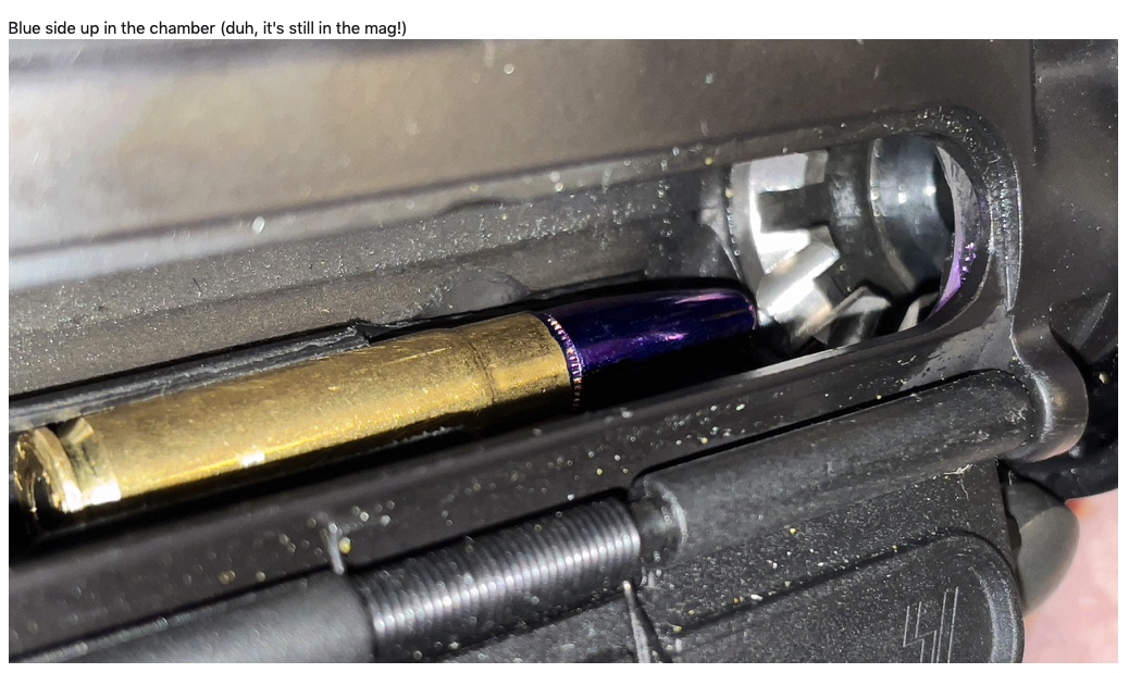

    Ok...the marker test. I did half black half blue. Sharpie. Loaded the blue side up on a cartridge with the bullet seated to factory depth (2.065).
    Blue side up in the mag.
    Blue side up in the chamber (duh, it's still in the mag!)
    I dropped the bolt and tried to pull it out as slowly as possible and it appeared the blue side was still mostly facing up.
    The horizontal "ring" marks were mostly on the black side but bordering on the blue side (up).
    The normal big gouge wasn't there (I reused a round that already had the gouge) but it appears as though it did it to the neck this time.

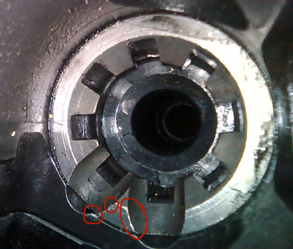

    Just a stab in the dark here. Does your EJECTOR have sharp, squared-off edges? I have been told that square ejector edges could catch on the cartridge base for just an instant during the feed cycle and hold the cartridge at too much of an upward angle and cause issues with the bullet entering the barrel extension/feed ramp/chamber area. Which causes the cartridge to catch a sharp edge that it would normally slide right on past. I don't know which brands, but some "enhanced" bolts come with round-faced ejectors for this reason. I have removed my ejectors and chamfered the forward edge by chucking them in a drill and holding them against a sharpening stone. This seems to be more problematic in large frame ARs.

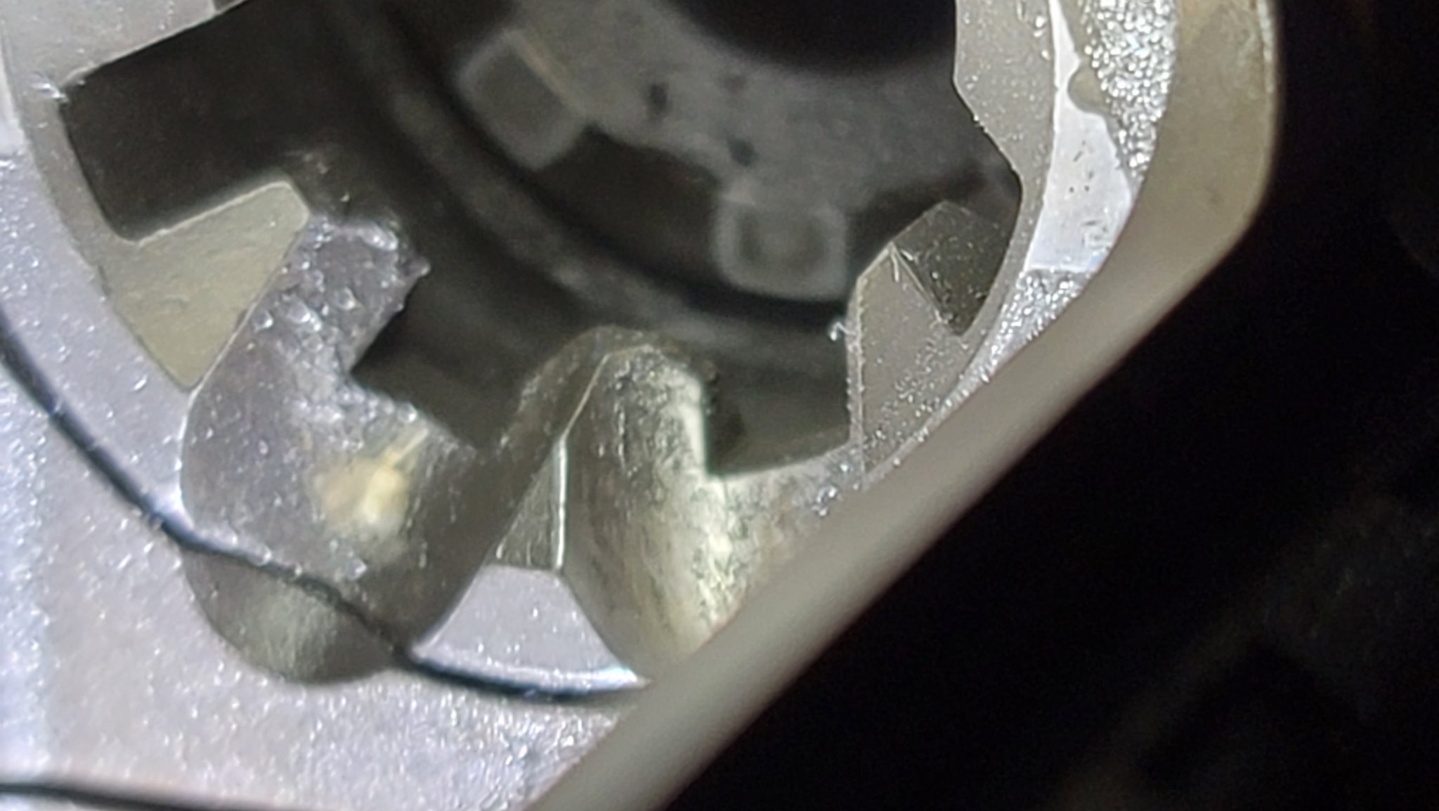

    Chamber photos. Completely forgot I had a bore scope.

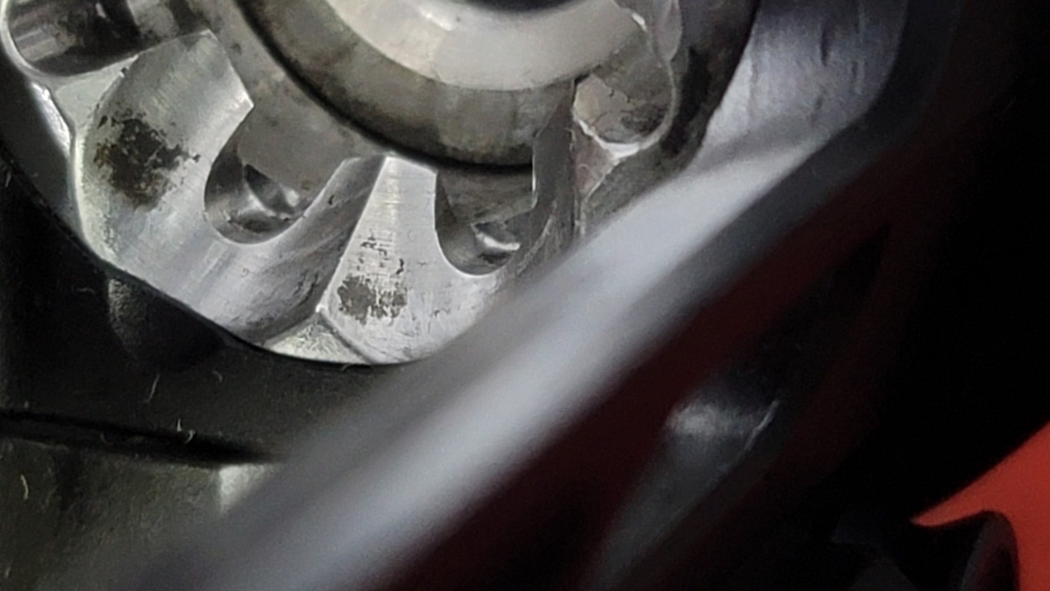

    Ok here's a series of photos moving the bullet out of the mag by hand. Had to use my pinky and it was still difficult to get a digit in there. This is in consecutive order.
    So the above sequence was moving the cartridge really slowly. What I think is happening is the cartridge, when being pushed faster is nosing up off the ramps and catching the throat. At that point the bolt is still slamming home so it pushes the entire cartridge UP, the bullet hits the lugs, leaves marks, and ultimately pushes the bullet back into the case. Here's me pushing the bullet a bit faster and at the critical point where the nose of the bullet is actually on the outside wall of the throat.

    Going left to right: 1st circle looks like a burr, 2nd circle looks like a burr, and I think one or both of these may explain your longitudinal gouges. The 3rd circle looks like coppering on the feed ramp edge, and I think this may be where your horizontal ring marks are coming from.

    The Ranier and JP both appear to have well rounded edges. I was just thinking the ejector could be causing a hiccup for a millisecond and allowing other geometry to get a bit out of sync during the feed process.

    I remembered why I didn't run any sub-x, they are not flat base. I belive flat base to be more accurate in subs.

    Look at the impressions on the case heads -especially the bottom middle case with brass flow into the ejector plunger hole. With this being factory ammo, you think maybe excessive headspace? He has been swapping bolts.

    Those are not Sub-X rounds. Those are 125gr. FMJ supersonic rounds, factory loads. I didn't have the same issues with anything shot AFTER those rounds, factory loads from different manufacturers or hand loads.
    And there are numerous rounds from the same batch that failed that didn't have the ejector marks and the primers weren't blown out.
    I will check headspace.
