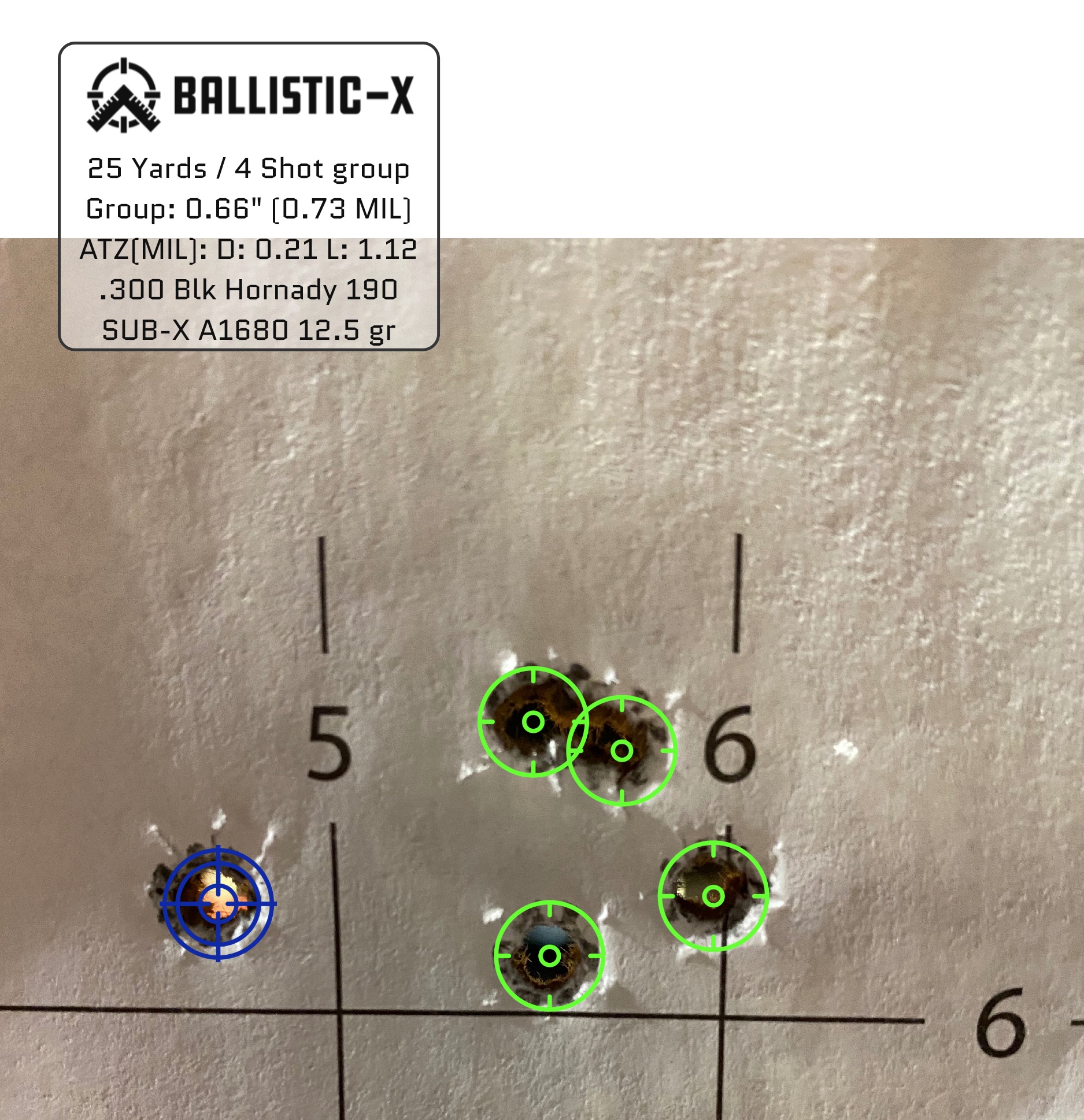

Here’s some data Seekins 8” and Omega can and Seekins AGB
Hornady 190 Sub-X
AA1680
Fed 205M
COL 1.345
COAL 2.140
BTO 1.625
12.4 gr 1094, 1083, 1064, 1057, 1063
12.5 gr 1119, 1115, 1096, 1106, 1086
12.6 gr 1106, 1116, 1132, 1107
25 yrds and EoTech sight fwiw
