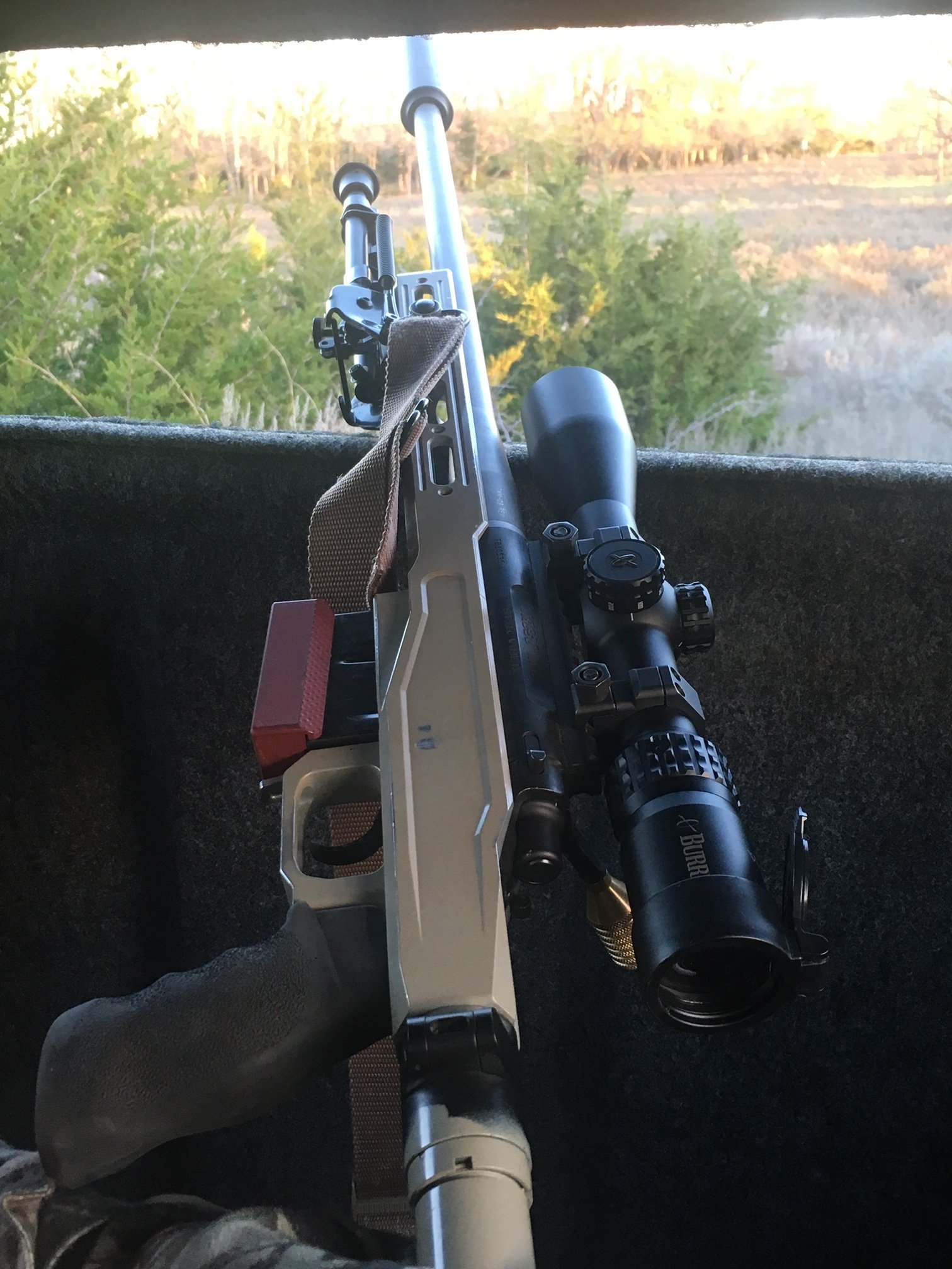

I have the 200625 model (5-25, SCR MOA, FFP, mads) that I like for the price point. The glass isn't fantastic, but pretty good for the price. I've read here the glass supposed to be the same as, or very similar to the XTR2. The image gets a bit dark at higher magnifications, but that was comparing it to more expensive scopes. I don't recall any real issues with eye box or CA.
The myriad of knob/turret configurations is a bit frustrating to figure out when comparing. My model's low profile exposed knobs are really nice, and the zero stop is super simple and should be very robust. Although, this knob and turret combination only provides one rotation (24 MOA) of adjustment; you can remove the knob's pin to gain full travel at the expense of the zero stop. I also like the included alternative short covered knobs and may change to an exposed elevation and capped windage configuration.
Also, this thing is super long compared to other scopes. It may not be a negative, but definitely check the dimensions.
