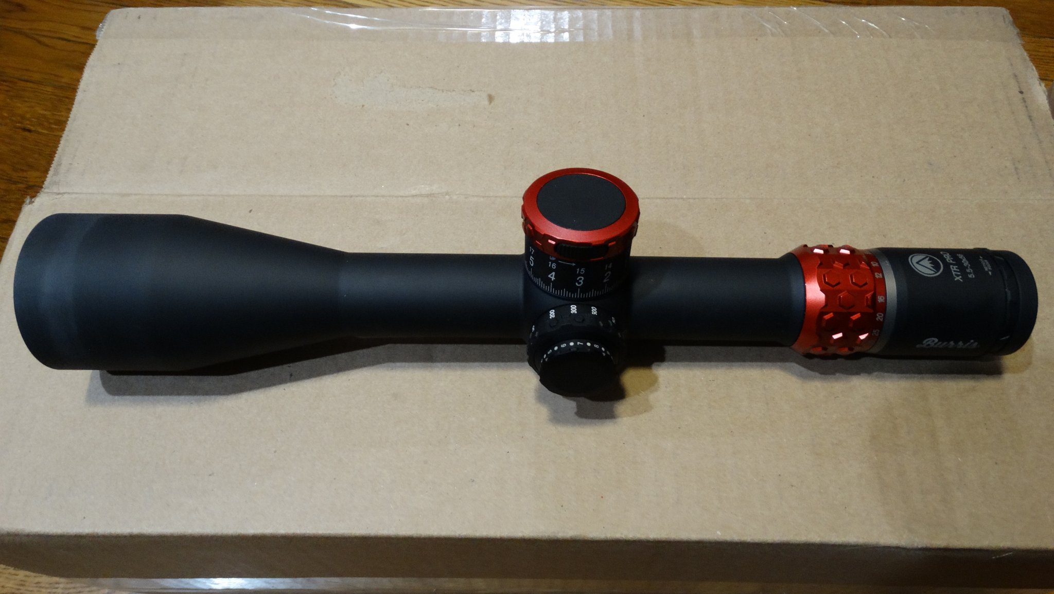

So I recently received my XTR Pro with Tremor5 reticle. In looking at all the features of the scope I discovered that the illumination seemed to only work at 5 or 6 and above. I remembered reading something about the illumination be NV compatible so contacted Burris Customer Service, beside missing the zoom throw lever and battery.

Have any of you XTR Pro owners had this same issue? As a side note my scope may have been an early build as it had an anodize zoom ring. Also, when illuminated, the Tremor5 seems to have a different illumination pattern. Only the mill dots marking seem to light up, none of the hash lines.

Crazy that you got an anodized one. I wonder who's been sitting on that 🤣
It looks anodized to me:
Apparently I got the last one Camera Land had.
