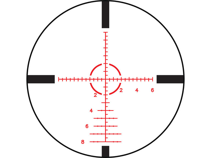

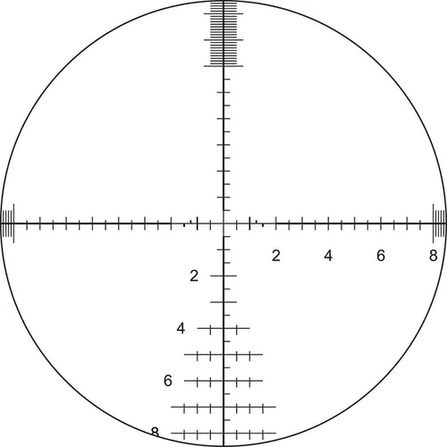

BTW, What is the difference between the earlier LRHS and the current LRTS scopes?
The LRHS has a capped windage turret.
LRHS has the gH2 reticle reticle with the 2mil circle of doom for easy viewing at low power.
7102006
The LRTS has an exposed locking windage turret and a magnification lever.
The LRTS has a g3 reticle. Its missing the big circle and has a 1.25 mover dash on the horizontal axis.
7102005
In both of them the illuminated model has a cross hair that maintains the full thickness for the entire reticle.
The non illuminated has a center section where the reticle goes to half the thickness for a finer center aim point (you can kind of tell that in the g3 image).
Not sure if there are any LRHS with 100 spline turrets and covers like the LRTS. With the LRHS you may end up .1 off when zeroing the turret cover because there are less splines than possible positions. The LRTS also has a built in cat tail.
