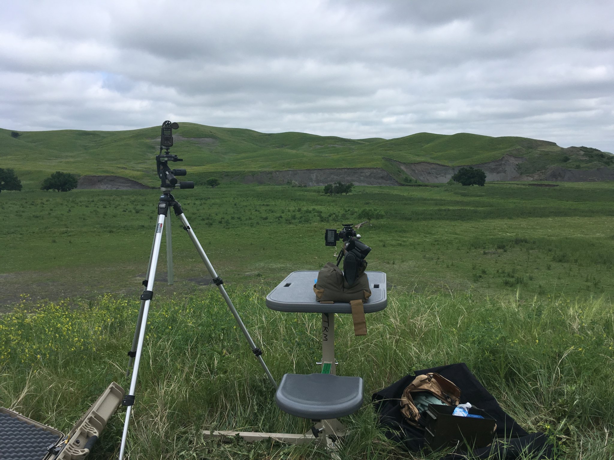

So I got something interesting in the mail yesterday.....

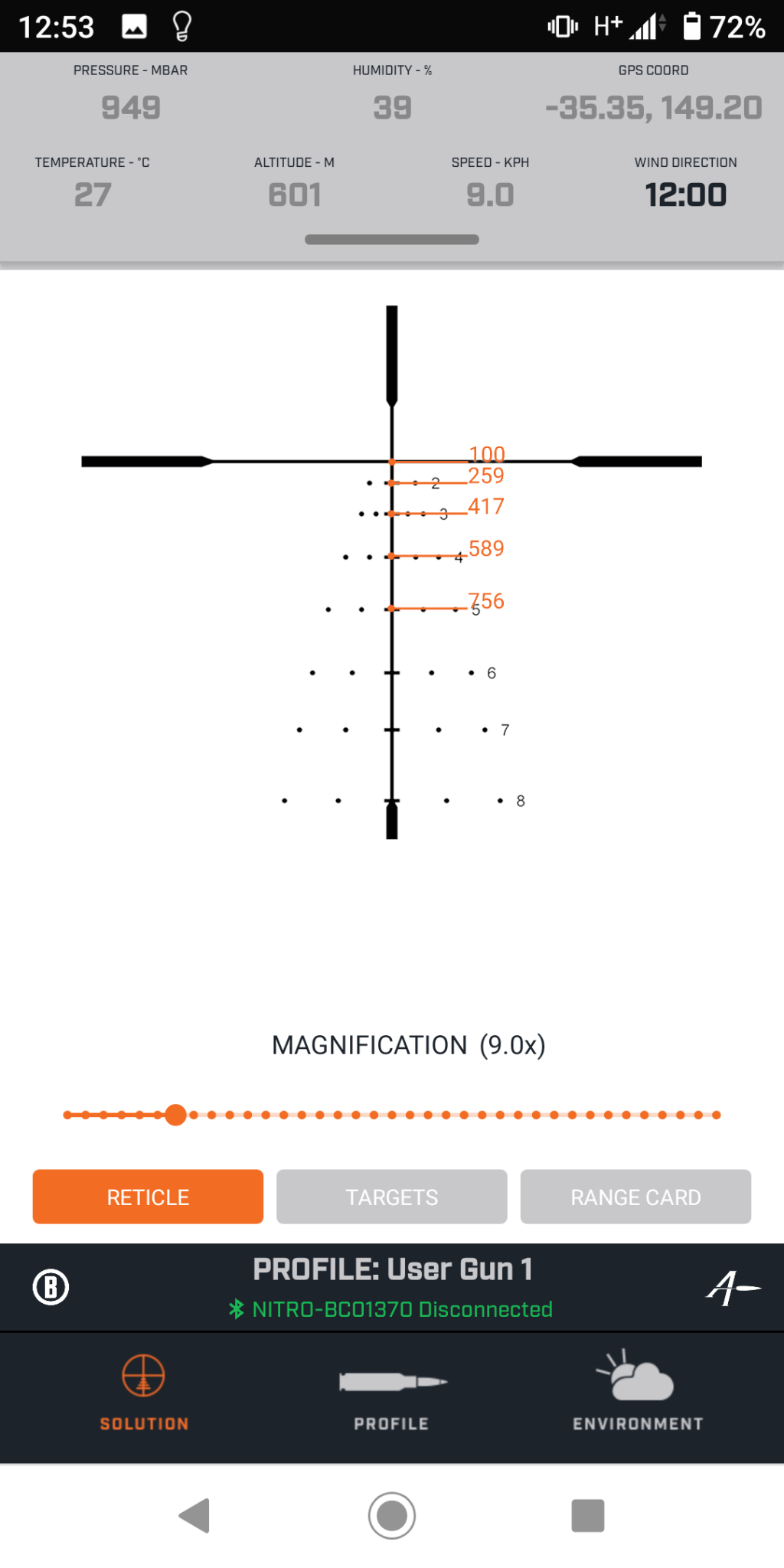

So mine finally arrived from Optics Planet tonight and it is MUCH smaller than I was anticipating. Glass looks good,very clear, and the focus ring works great. Overall not too shabby for the $$$.
A few things I've noted for anyone just getting one:
  1. There is no manual in the box NOR is there one available online currently.
  2. There are several Youtube video's from Oct2019 showing how to pair the LRF with the Bushnell app but either the App has changed or my version is bugged. (see below)
  3. ABE is the mode you want for pairing to a Kestrel 5700, ABU is the one for Bushnell's App. Zero issues pairing to a Kestrel!!
  4. I'd love to know what the other modes are, but see #1
So the grey "Bluetooth" and the orange "Gun Profile" boxes on the profile page are completely missing for me. I deleted and re-downloaded the App, no change.
The manual is linked on the actual Nitro 1800 product page.
Are you using an Android phone or iPhone?
Hm. Not sure how much I can help on the app issue, since I run Android. I will say that I had to enable GPS for some stupid reason to get the pairing to work. That's not the only app/device I have had to do it with, though, so it's not something with the Bushnell app, but Android itself.
No worries on not being Tech support. Although I thought the App had some interesting features, it wasn't really overly impressive.

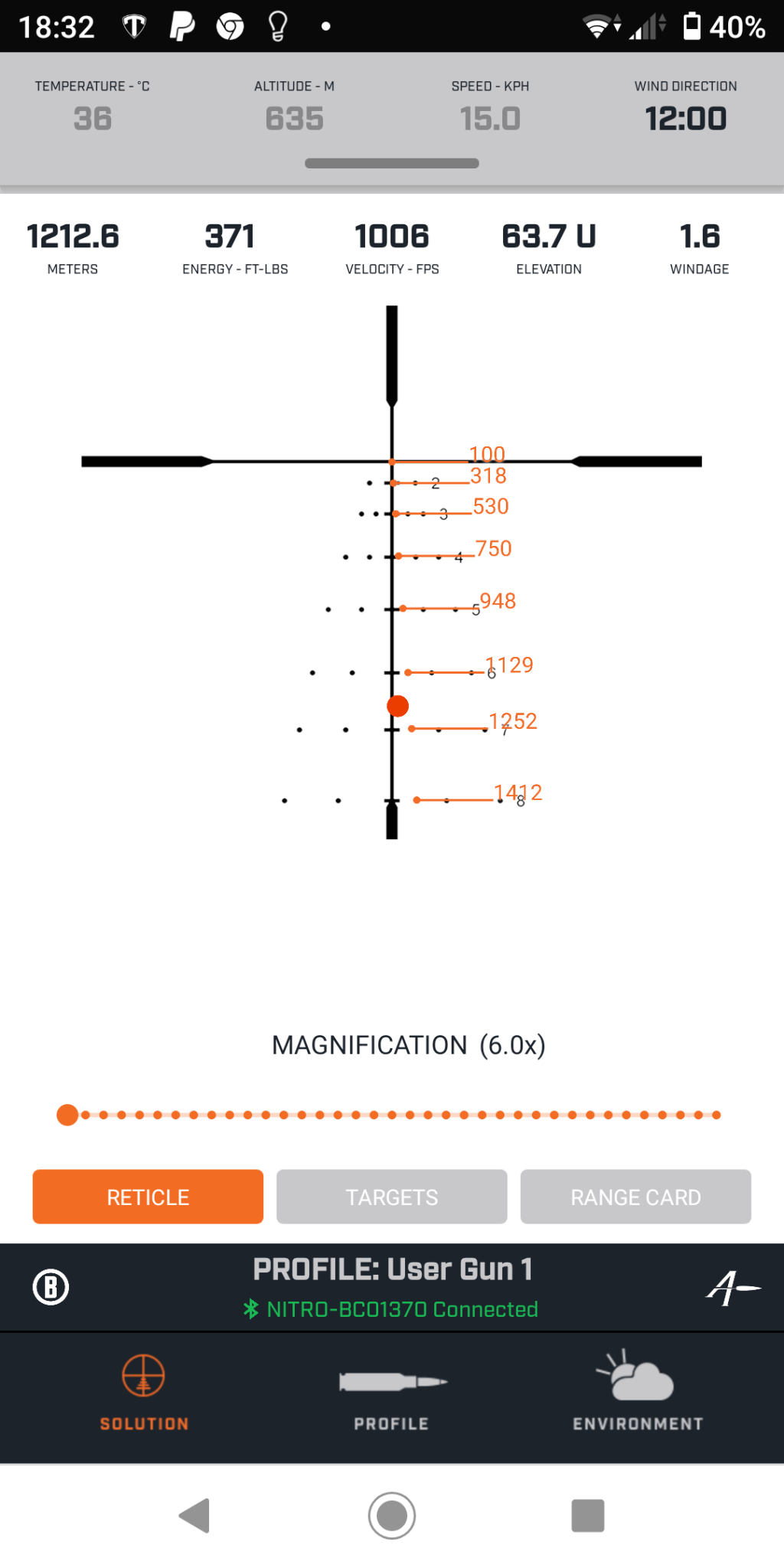

More results from this weekend (Sadly without pictures):
Ranging steel out to 1060 yards was no problem. Unfortunately, most of the targets were in front of berms, I don't have much to work with where I can isolate a target without a berm immediately behind it. I'm going to try to find some places/objects around town (maybe on the water) where I can get skylined objects and see how well the Nitro picks up there.
At 800+ yards, I was really happy with the speed. Other LRFs I have used, I needed to be able to keep the LRF on target for a second or more to really get a good range, especially in the bright sun here in FL, but the Nitro didn't have any issues there. As a result, I was still able to get good ranges on most targets just offhand, no tripod support.
Linking to the Kestrel is easy. It might need a little coaxing once the LRF shuts off to get the link reestablished, but that's something I have seen with other Kestrel connected LRFs I've tried, too, so I can't really call that a knock against the Nitro.
Internal AB seems to be functioning well, also. No issues I can see there so far.
For the price, I think it's a pretty solid LRF. It's not going to compete against the $1k+ stuff obviously, but for the money I'd say it's a pretty damn good LRF.
If anyone has specific things they'd like me to test out, let me know. I will try to get those done and get them on video or at least photos for you guys.

I've had my nitro 1800 for a couple weeks now paired with the app, so far very happy but I have one question, how do I get the app to display my firing solution as a point of aim on the reticle once I have lased the target? i.e. On the app in solutions where my specific scope reticle is how do I get it to show a dot where to aim?
Pretty much. If you have a known distance target, you can do the same thing in the app (out to 880 yards) without even using the LRF.
How do you actually do this. I've been using the app for about 6 months and my targets don't reflect in the reticle solution. I now have the range finder and it also doesn't show shot placement as you have mentioned above.
Honestly, I haven't played with the app and LRF integration enough to be sure of how to do it. I will try to play around with it this week or weekend and get you an answer.

The Nitro should definitely keep the profile loaded from the phone app when disconnected and in ABU mode. Give it another try tonight after making sure your app is up to date. If it's still doing it, shoot me a PM with your email address, and I will get you in touch with the right person.
As for the data with a Kestrel, are you in external mode on the Nitro? I think it shows as ABE in the display, but I'd have to grab mine and look to be sure.
I just upgraded Mine to sportsman but the app hasn't updated. Do you need to pair it to the LRF for the update to take effect on the app? Also will the upgrade allow you to change your twist rate?
My understanding is that you need to change the settings between Abu and Abe depending what you are connected to. So if you pair to the kestrel the app is no longer paired and providing the gun profile but the kestrel will be.
That's correct, but ABU will retain the profile loaded from the app.
Update on my experience. I upgraded to the sportsman and this unlocked the main critical setting of barrel twist rate and some other too which are already mentioned on the bushnell site. Also this unlocks the ability for the app to give you an aim point on your bushnell reticle once a target has been lased. So far I am extremely happy with this LRF and the app. So far just from my front door I have been able to range trees well beyond 1000m very quickly and the app makes it perfect for beginners to either aim off on the reticle or dial in the turrets for a firing solution.
Reactions: Hollywood 6mm
