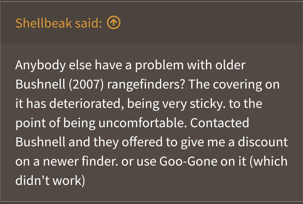

^^^^^ That was your reply to this:

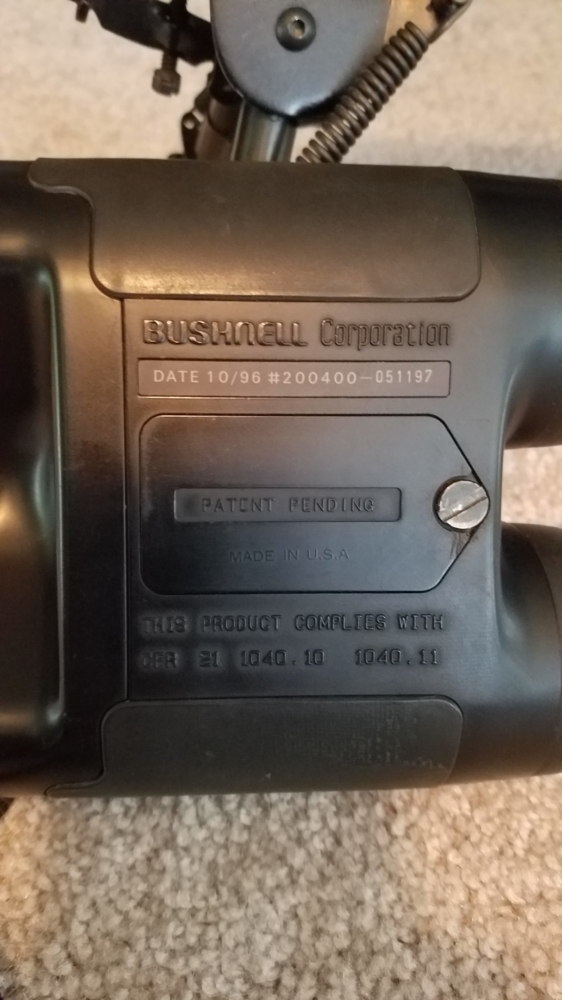

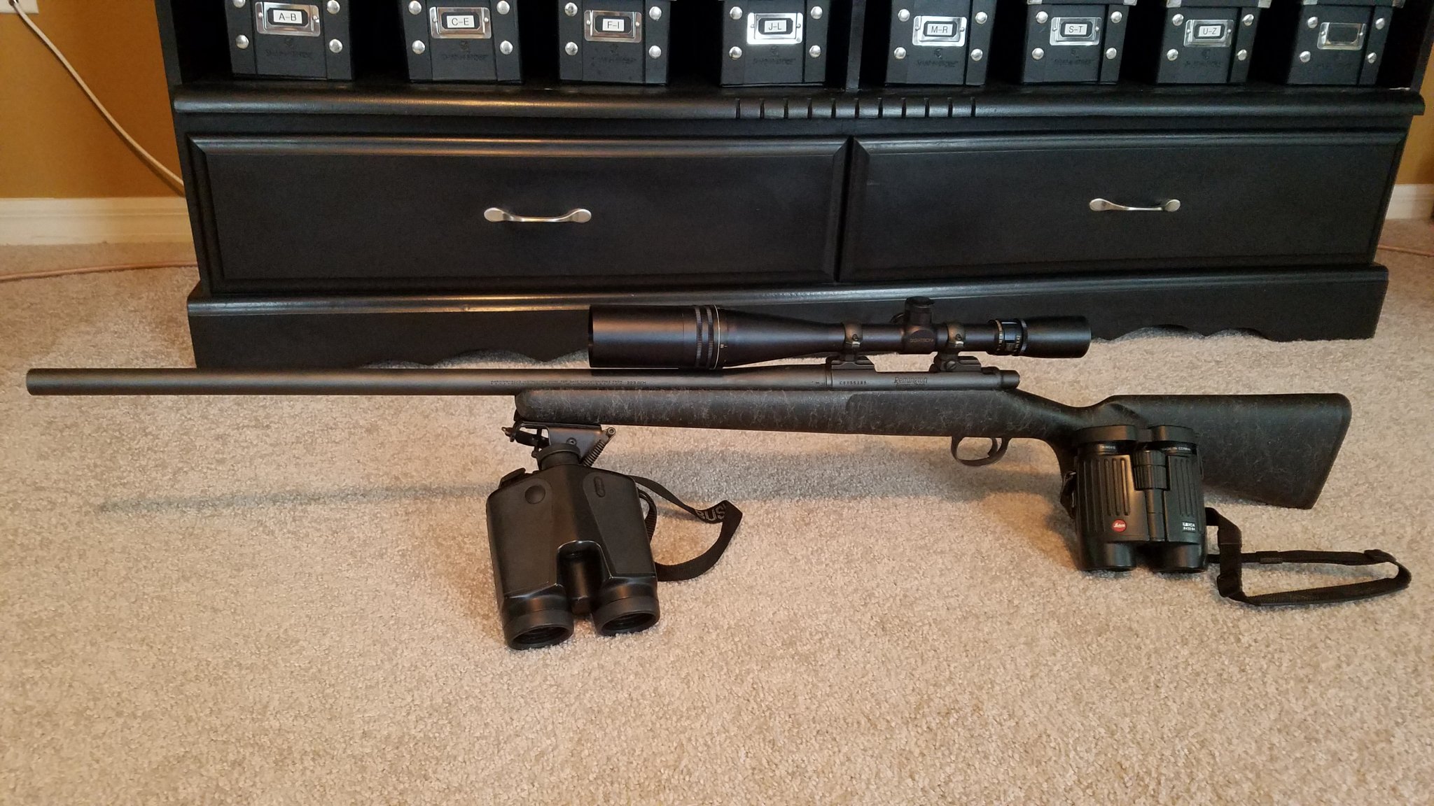

Ha!! 2007? I've got the original, made in the USA Bushnell 400 and it still works better than advertised.
Here's a pic of it.
Sitting next to a 700VS from that mid nineties era.
I brought the Bushy out to a friend's lease a few months ago and was able to range cattle out to 625.
It's big, it's old and it's still performing. Crazy, right?

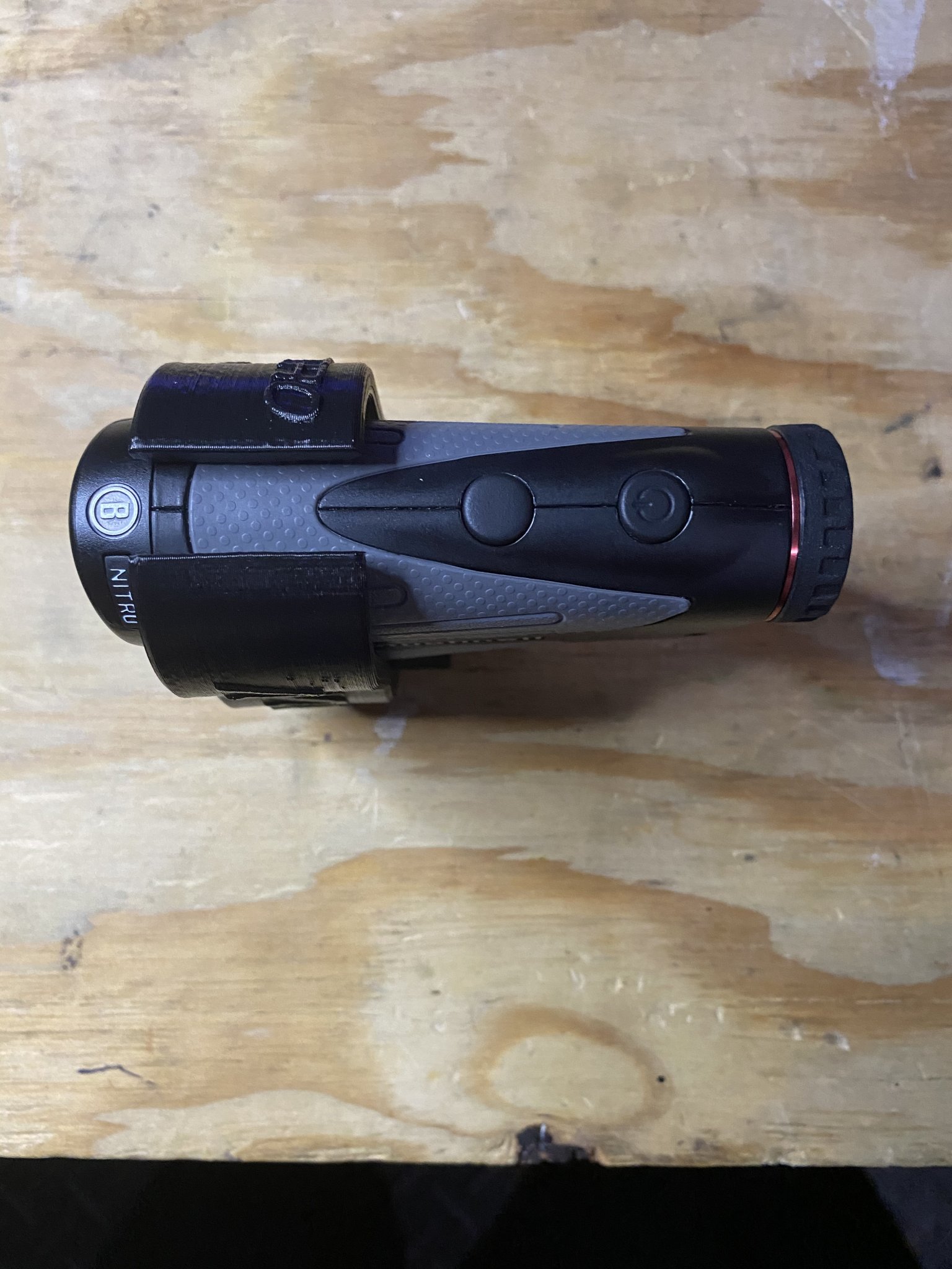

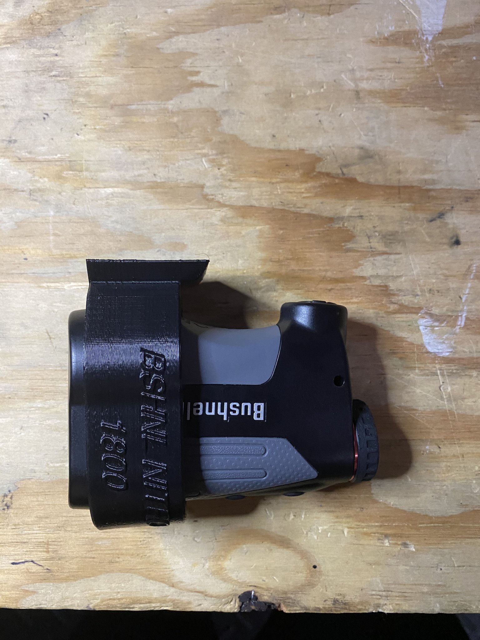

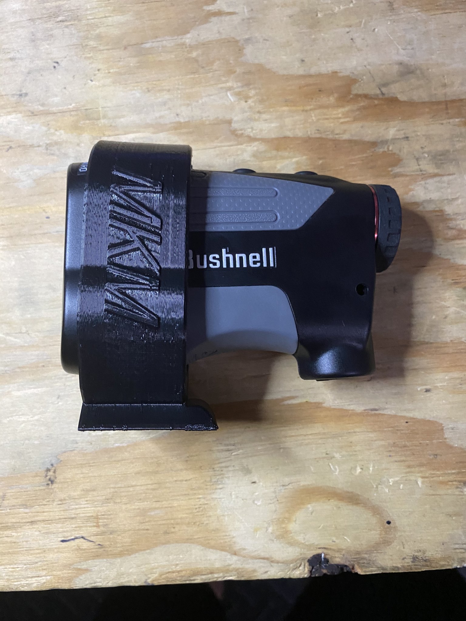

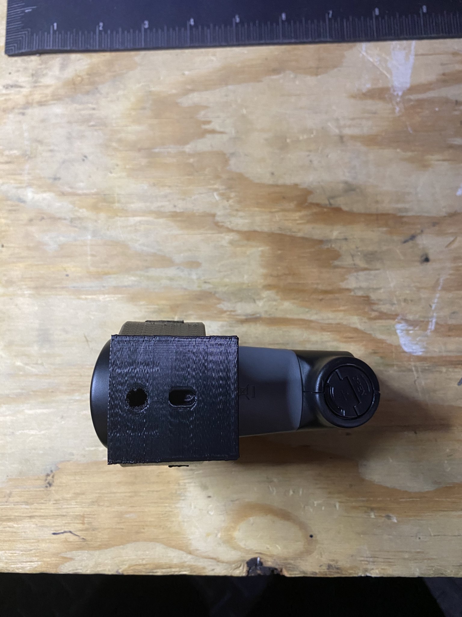

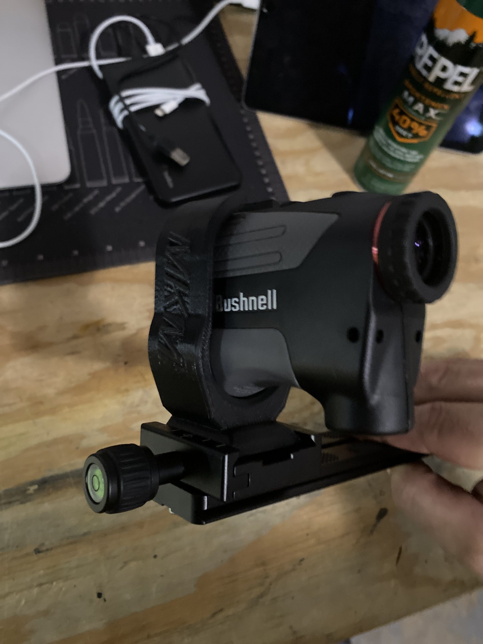

MK Machining (@Tyler Kemp) makes a tripod mount for the Nitro. He actually borrowed mine to do the test fitting, etc.
Yep, it's printed!
No, you won't break it. It's a nylon 6,66, a far cry from standard printing. Imagine a zip tie about 30x as thick :)
The mount will only fit 1 way on an Arca clamp due to the limitations of FDM printing, it wouldn't turn out nicely without a flat surface for printing.
We could print this via some more expensive tech, but the mount would likely be $60, however would look better than molded and allow Arca all around.
Yep, it's printed!
@Tyler Kemp please don’t get me wrong... super excited to get this mount up and running. Its for sure a solid piece. Thank you

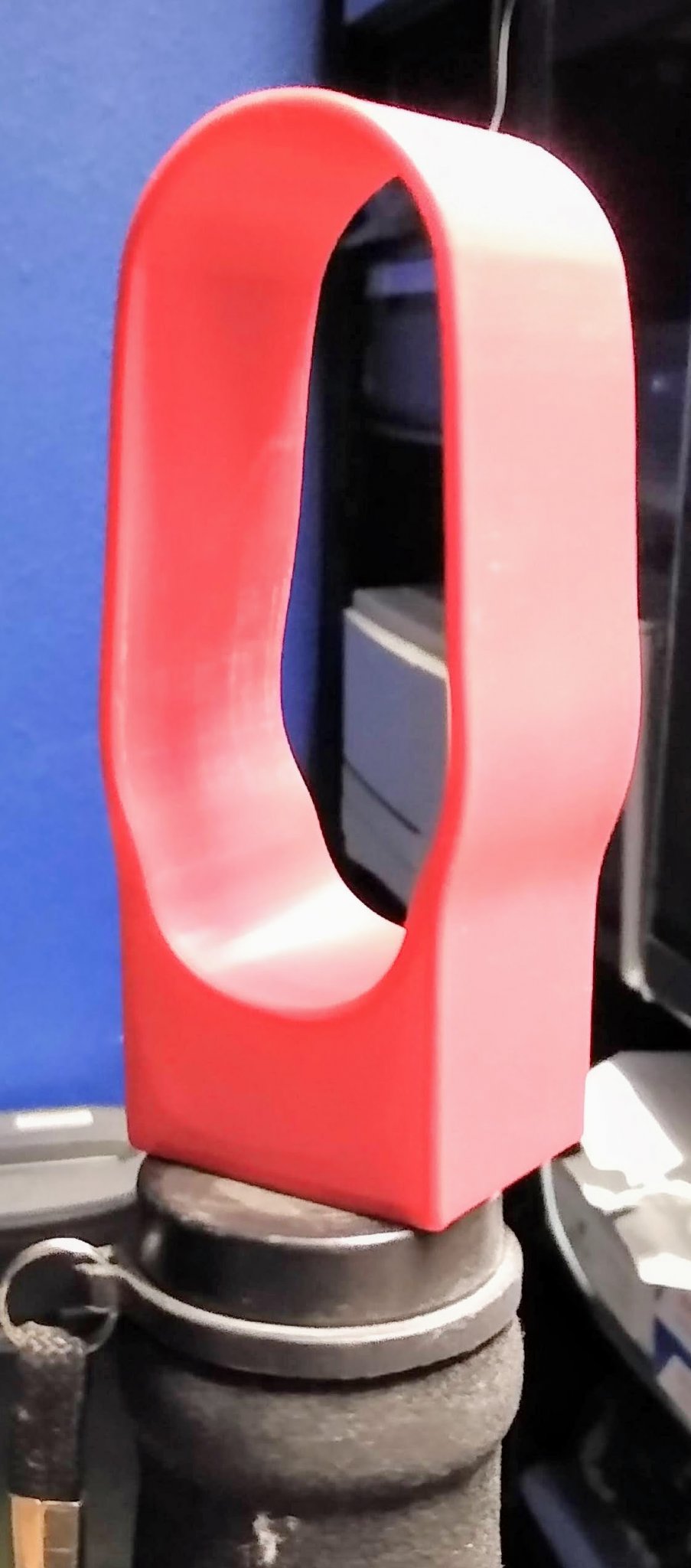

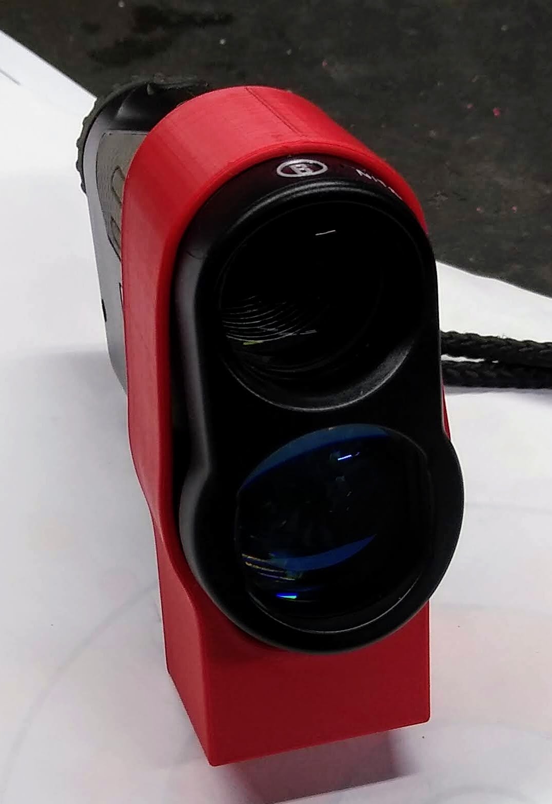

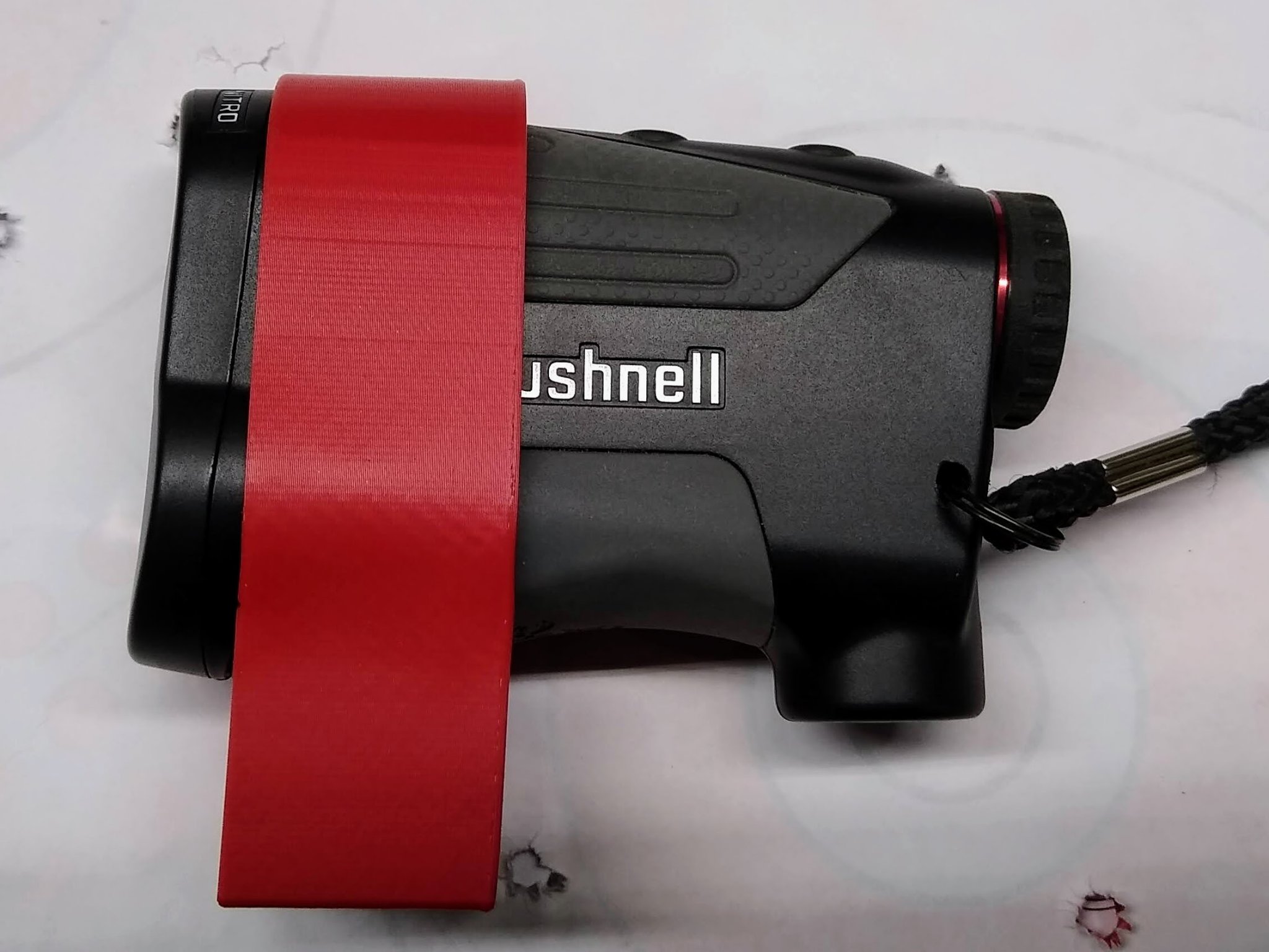

If anyone is interested..you can 3D print the Sig Kilo mount and tweak it with a propane torch to fit the nitro 1800.
