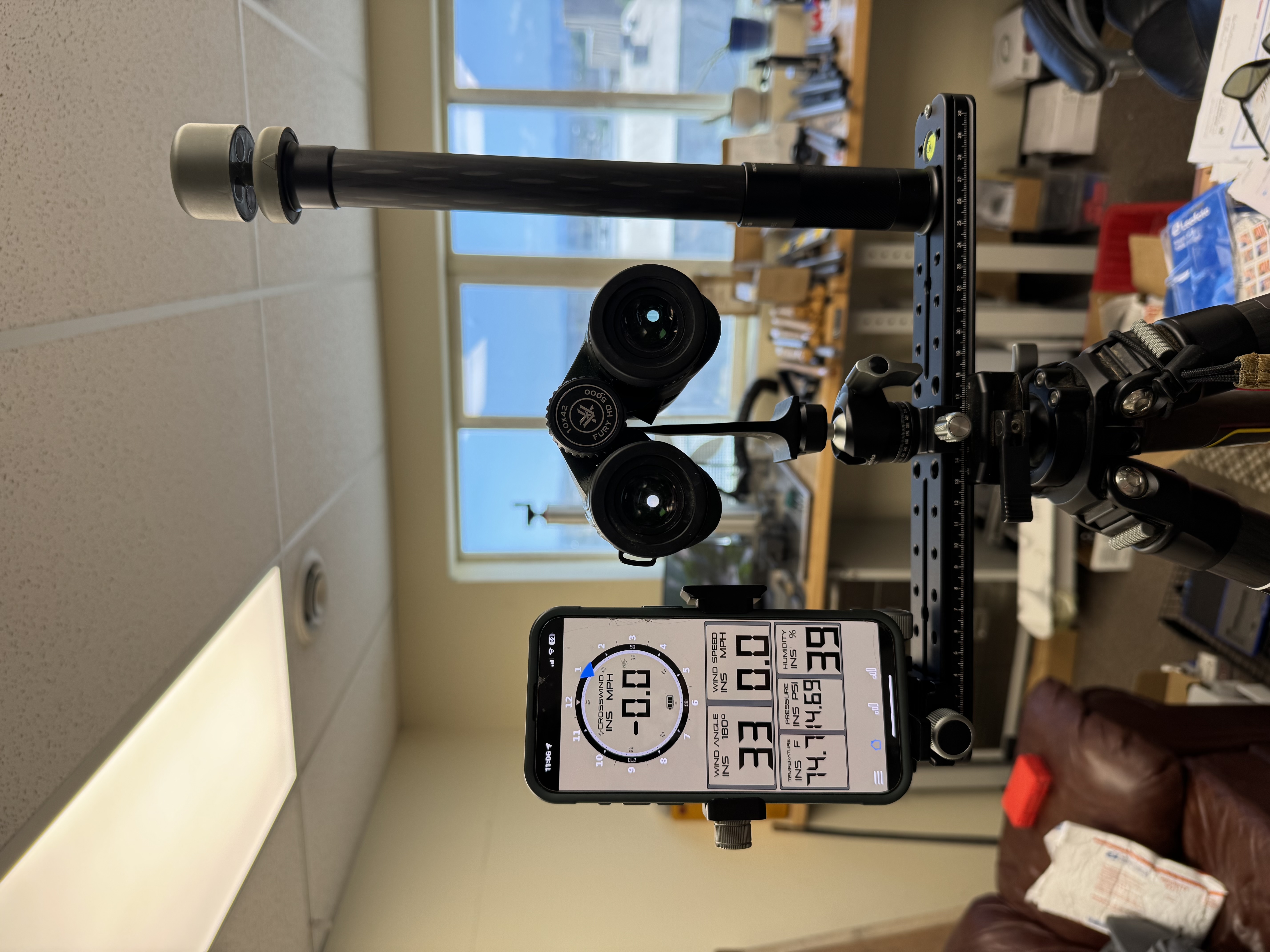

I recently switched to pairing a Calypso Mini AB to Quantum as a means to more accurately predict and manage wind calls for ELR and PRS type matches.
It seems like a Bluetooth nightmare to:
1. Pair the calypso to quantum to get your wind and update your range card (sector)
2. Disconnect the calypso and pair the kestrel 5700 to export the range card
3. Disconnect your phone, then pair with the HUD to update the range card on the gun.
4. Do it all over again for the next stage.
Is there a better way to do this? Seems like the ability to go straight from Quantum to the HUD would be ideal or at least the ability to connect to multiple devices at the same time like you can in GeoBallistics.
