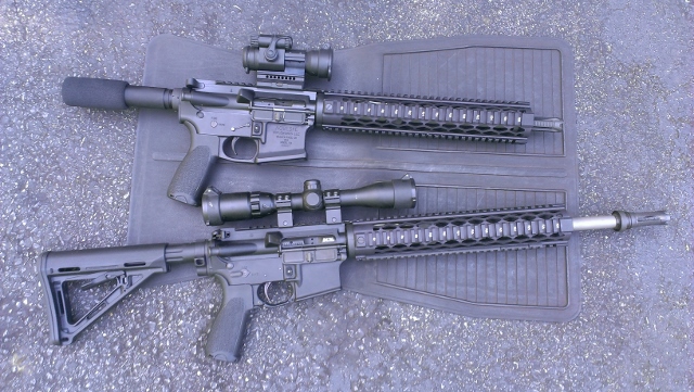

When I ran my 16" and 12.2" 300BLK (Noveske barrel, pistol-length gas) unsuppressed and suppressed, I absolutely HAD to swap springs and buffers for reliable operation.
Unsuppressed - Wolfe XP spring and T2 buffer (16").
Suppressed - Standard carbine spring and H buffer (16").
Come to think of it, the same combo worked with the 12.2" as well.
