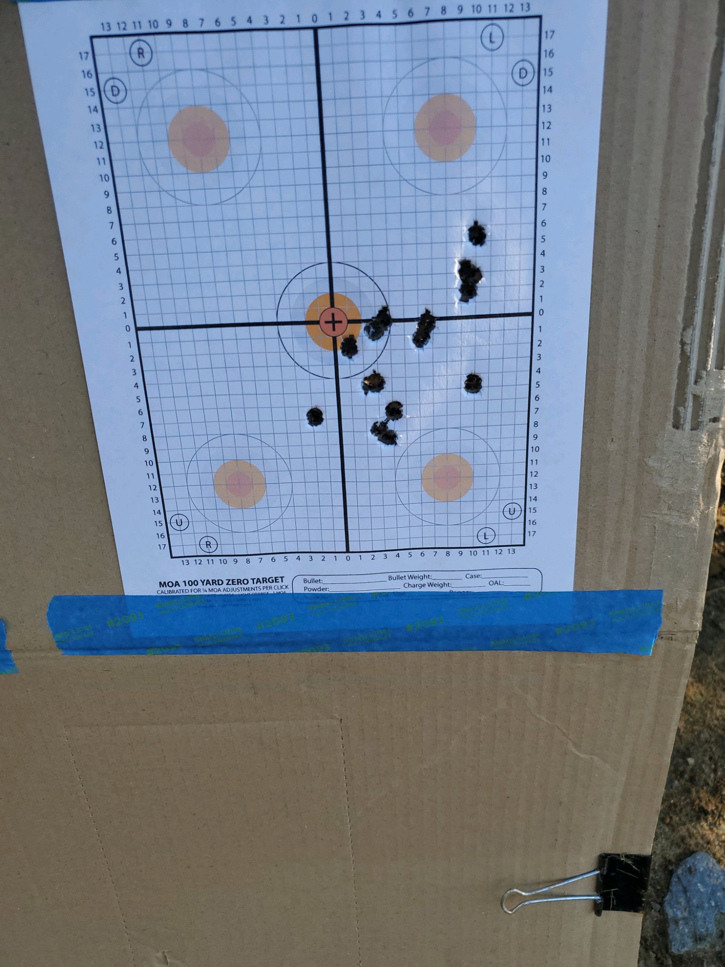

My buddy has a Remington 700 in 300 WM. He had a POS scope on it and we were able to zero it and get a decent group. Shot that way for about a year. He had a gunsmith mount a new scope while he installed a pretty beefy muzzle brake (not sure which brand). The scope is a Viper PST G2 5-25. We both shoot RPRs, his in 6.5 CM with a Razor 4.5-27 and mine in 308 with Viper PST G2 5-25 and can get sub MOA groups at 100 yds. Neither one of us can get the win mag to hold a group. We can barely keep it on a sheet of paper. We're shooting prone, on the ground, with a bipod and a rear bag at 100 yds. With the brake on it, there's not much more recoil than on my 308, and I can maintain sight picture through recoil to see impacts. I suggested to him that he put the POS scope back on it and we try again this afternoon. If we can hold a group, it would definitely point to the scope in some way, if it can't , it could be the muzzle brake. I've checked everything I can think of except the torque on the rings. Figured the gunsmith should get that right... I don't know what else to try. Any thoughts would be appreciated.

Sorry for the delay in following up, but we just shot the rifle for the first time since the original post yesterday. This rifle was a tack driver before my buddy sent it to a gunsmith to thread the barrel and install a brake. After a bunch of rounds down range with nothing hitting a target from 100, then 50 yds, we somehow got one on paper. Cleary, the bullet was tumbling when it hit the paper because the hole it made was about 1.5 inches long and in the shape of the bullet. It has to be the brake. I can't see any obvious signs of the bullet hitting the brake, but can't think of anything else. I need to get a barrel vise and then we're going to remove the brake and try again. Thoughts??

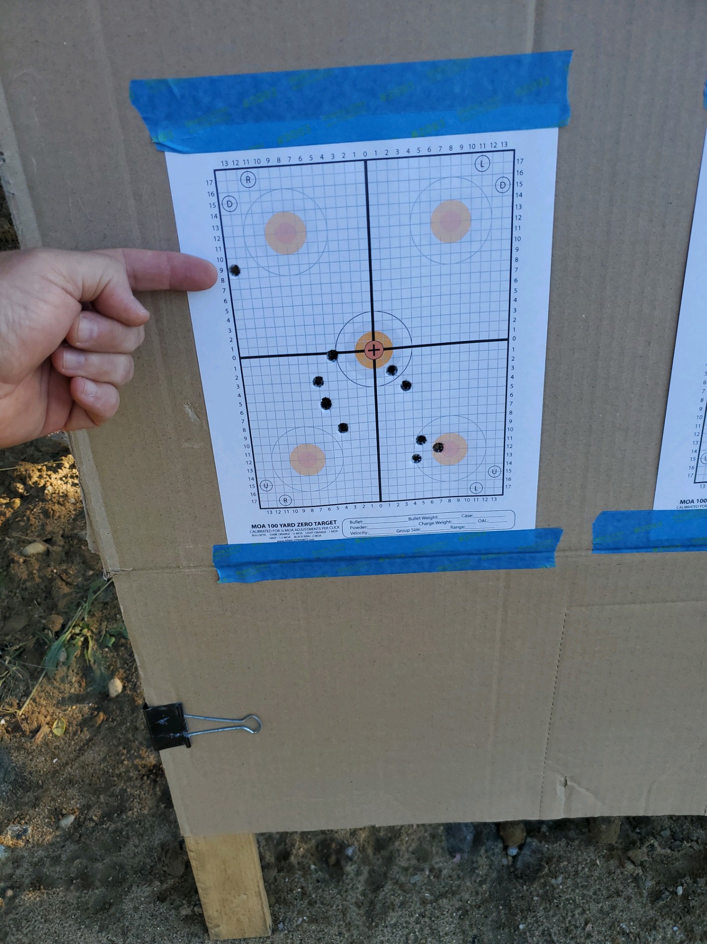

Removed the brake, installed a new viper pst gen 2 5-25 and got this at 100 yds. First shot was my finger. Couldn't get a good cheek weld and without a brake it packs a bit of a punch, so I was a bit all over.

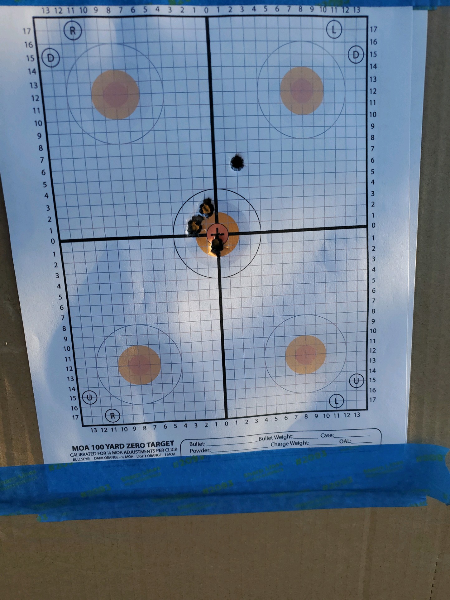

Adjusted the scope, installed a precision armament M11A2 that I had lying around without crush washer or anything, and shot this while adjusting the scope.
Final 3+1 shot group (mosquito got me just as I pulled the trigger on the high one)
Ended up using a spare rear bag to get a decent cheek weld and it worked ok. Next step is to contact APA and ask them what they can do about the brake.
