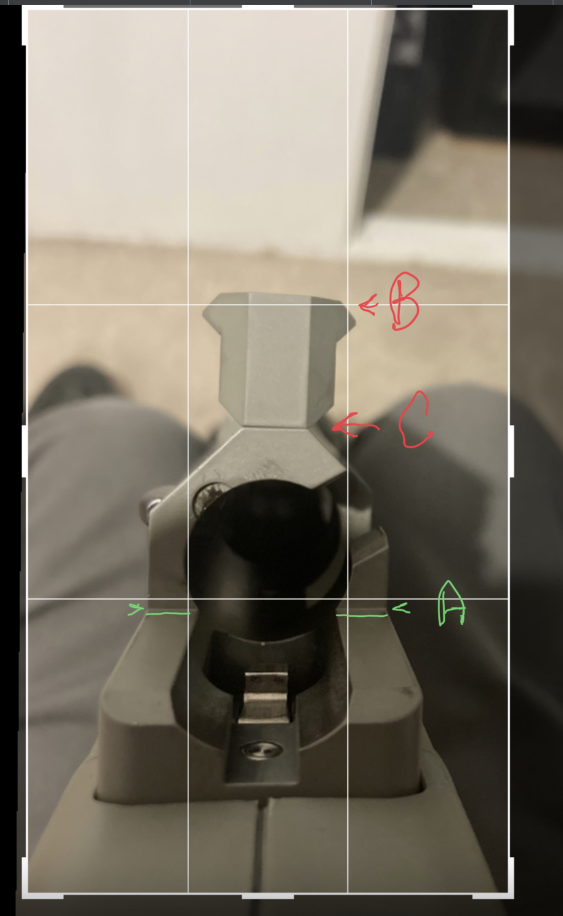

After going back and looking carefully at Smat’s iPhone grid picture more carefully (yes I did see according to the grid picture, the pic rail was not square the first time I looked). I think this rifle has a significant problem…
Look at his grid picture (see attached) that I’ve marked with planes A, B and C. Smat lined up parallel the grid line “A” to the bottom base line of the receiver, see how the grid line is parallel to the receiver? Grid line “B” clearly shows the pic rail is absolutely nonparallel.
What the real concern is grid line “C” that shows the top of the action appears to be milled out of square. When you take the out of square pic rail and the the top of the action out of square too, that results is some very significant stacking errors.
I would take the rifle to a competent machinist and have him measure how out of spec the top of the action “C” is to line “A” and generate a report send it to AI and tell them you want them to fix and refinish the action or replace it, if the evidence confirms the picture. If AI gives you crap then go see an attorney.
Of course, I am basing what I am seeing from an iPhone grid picture, it does look convincing though that the top of the action was milled out of square and if confirmed to be true then the new pic rail does not fix the problem.

Chad, did you read his post only or did you look at his iPhone grid pattern picture as well (See my post #58 with the marked up pic)?

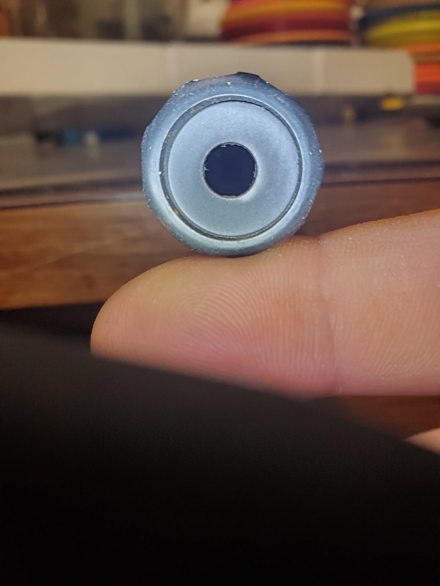

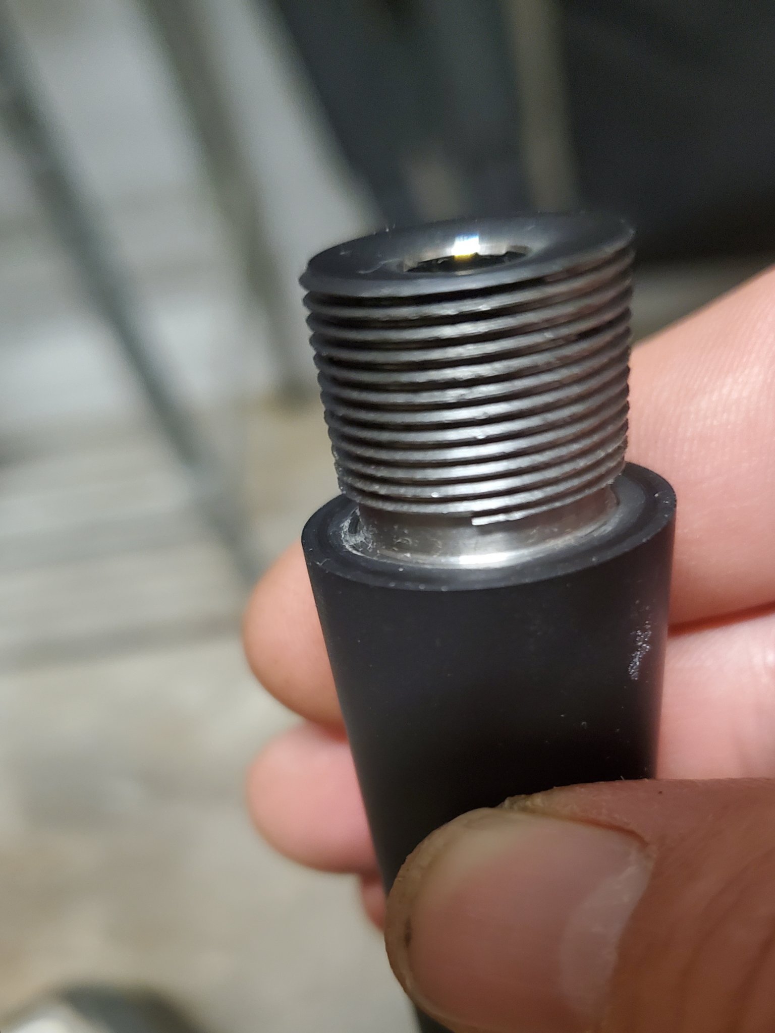

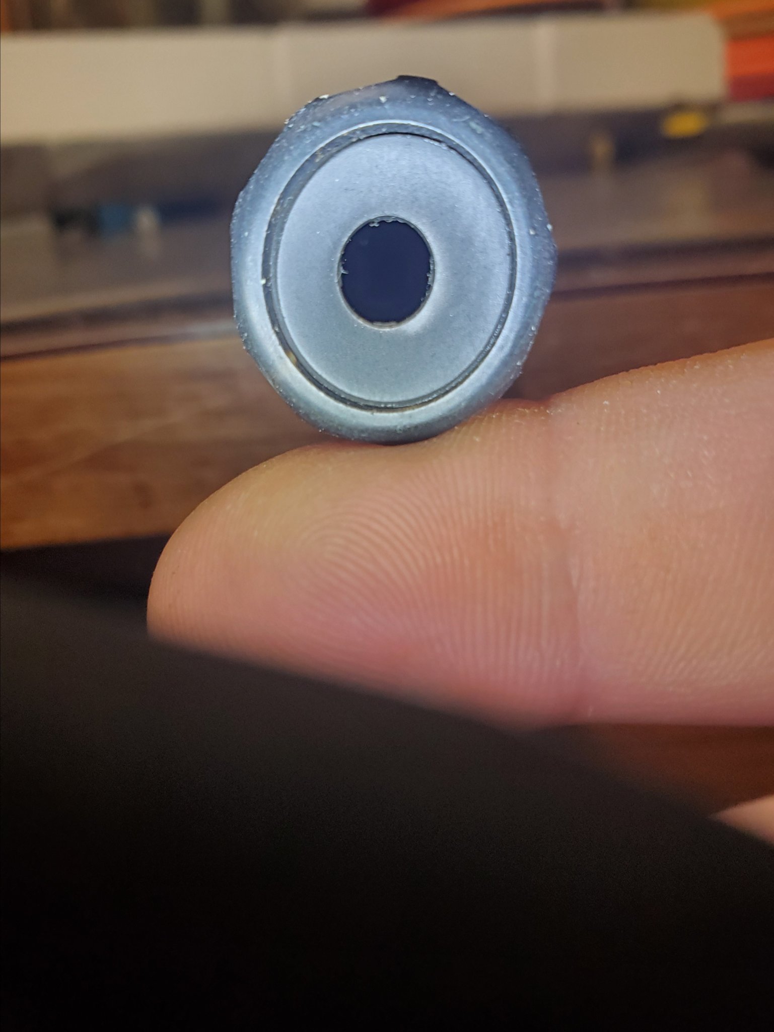

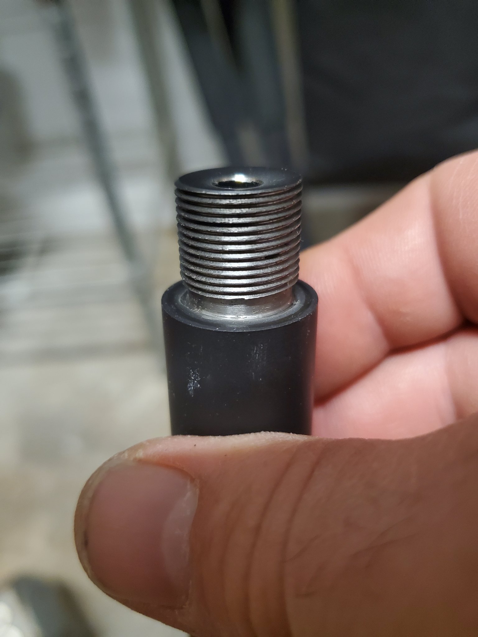

Here are some pictures for example where I have rotated the photo.

Why do you suppose the bottom left hand corner, is biased the opposite way of the upper right hand corner? You can clearly see that the grid does not line up where the bolt inserts into the action.

I was talking about my photos of the barrel. One normal and one with center line tweaked.
If you look at the line up the center of the stock, you can see it is slanted the same direction as the rail also.
If the photo of the rifle and the grid were lined up straight, the grid would be the same on both sides of alleyway for the bolt.
