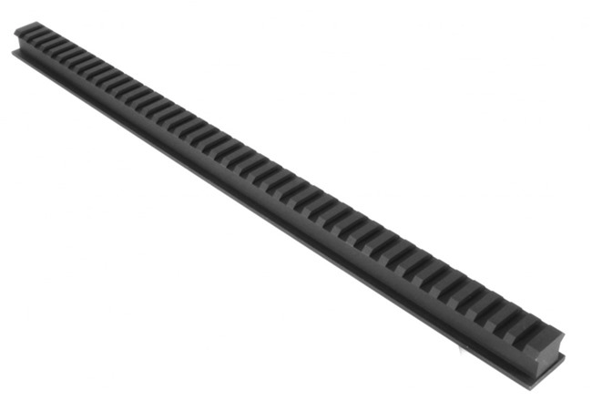

    I think the thickness will be the biggest issues. Most pic rails are awfully thin along the axis it would be bending on.
    I know brownells has picatiny blanks that come in foot long lengths etc and are more square sized vs the thin typical low profile as possible.

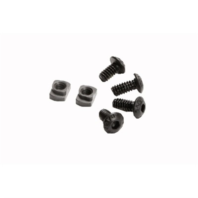

    Not sure how you would need to go about drilling it to attach to the chassis. Maybe just holes and some of the cheap little mlock backers.
    https://www.brownells.com/optics-mo...k-16-sku296000273-44961-188873.aspx?rrec=true

    https://www.brownells.com/rifle-par...ement-screws-steel-black-prod73012.aspx?dym=y
    7077969

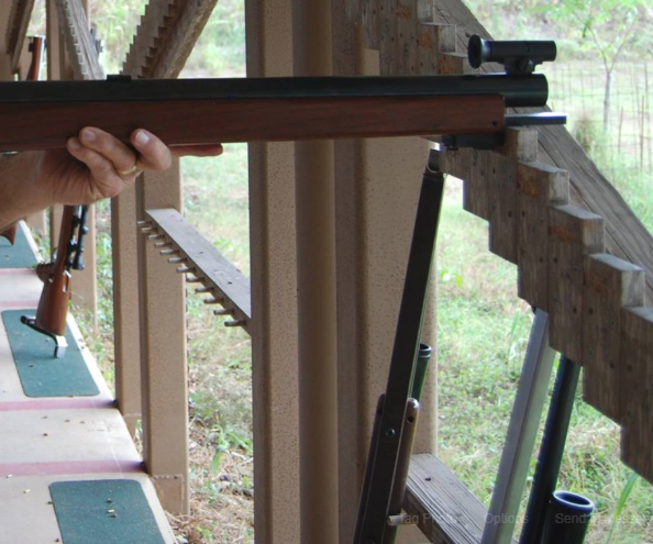

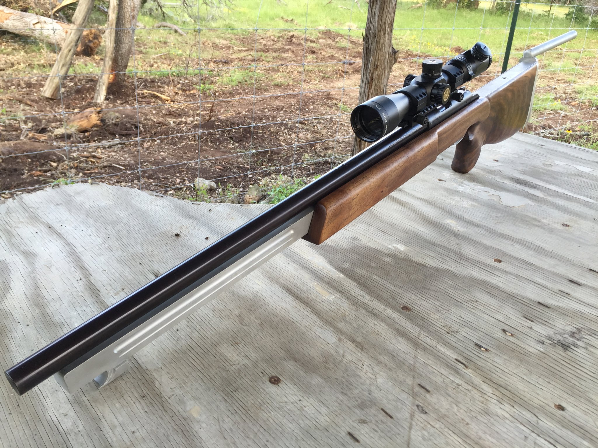

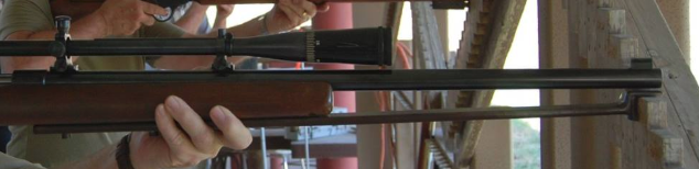

    It’ll look dumb but practically it wont be that different than what we do in my schuetzen club with a front cleat an inch back from the muzzle to push into the front rest barrier. Most arent as nicely integrated into the stock itself with the same rod extending from muzzle to butt like in my Wayne Young stock and rather they just screw into the bottom on an anschutz rail or are simply bolted on through the stock.

    7077978
    7077984
    7077985
