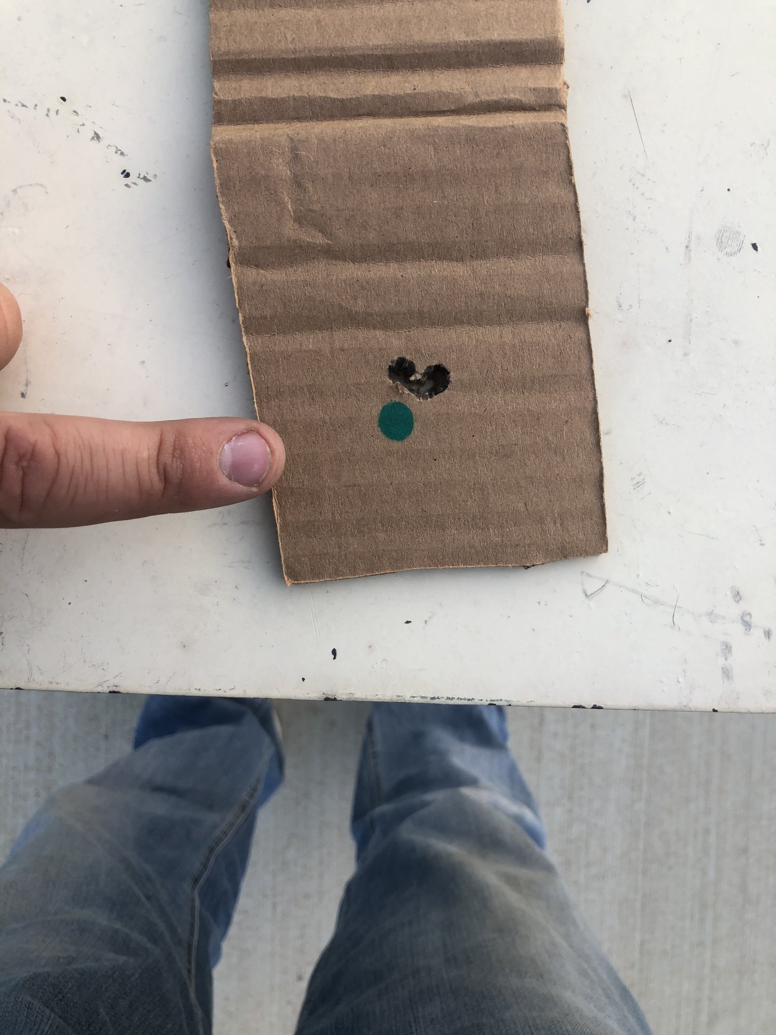

So I’ve been running a couple C6 barrels my most recent being in a 7mm rem mag, I’ve got to say these guys are incredible smiths. My 6mm Creedmoor I sent to Gene and they went ahead and trued the action barreled it up for me and it shoots lights out. My 7 mag though I just got a couple months ago, called them up and had them cut me a barrel for an untrued remmy cut to there recoil lug. We installed the barrel and the headspace is absolutely perfect! Now this is where it really gets interesting. I am running Nosler brass. I loaded up my first set of rounds using N565 I loaded all rounds 10k off the lands and started at 60 grains and worked my way up to 62.5 grains in half grain inc. I also loaded up 5 rounds to get my scope on paper running NF 7x35 Milxt. Second round bullseye. I did not follow any break in procedure I just shot this thing. Every group I shot with it from 60 grains to 62.5 grains looked like this.
