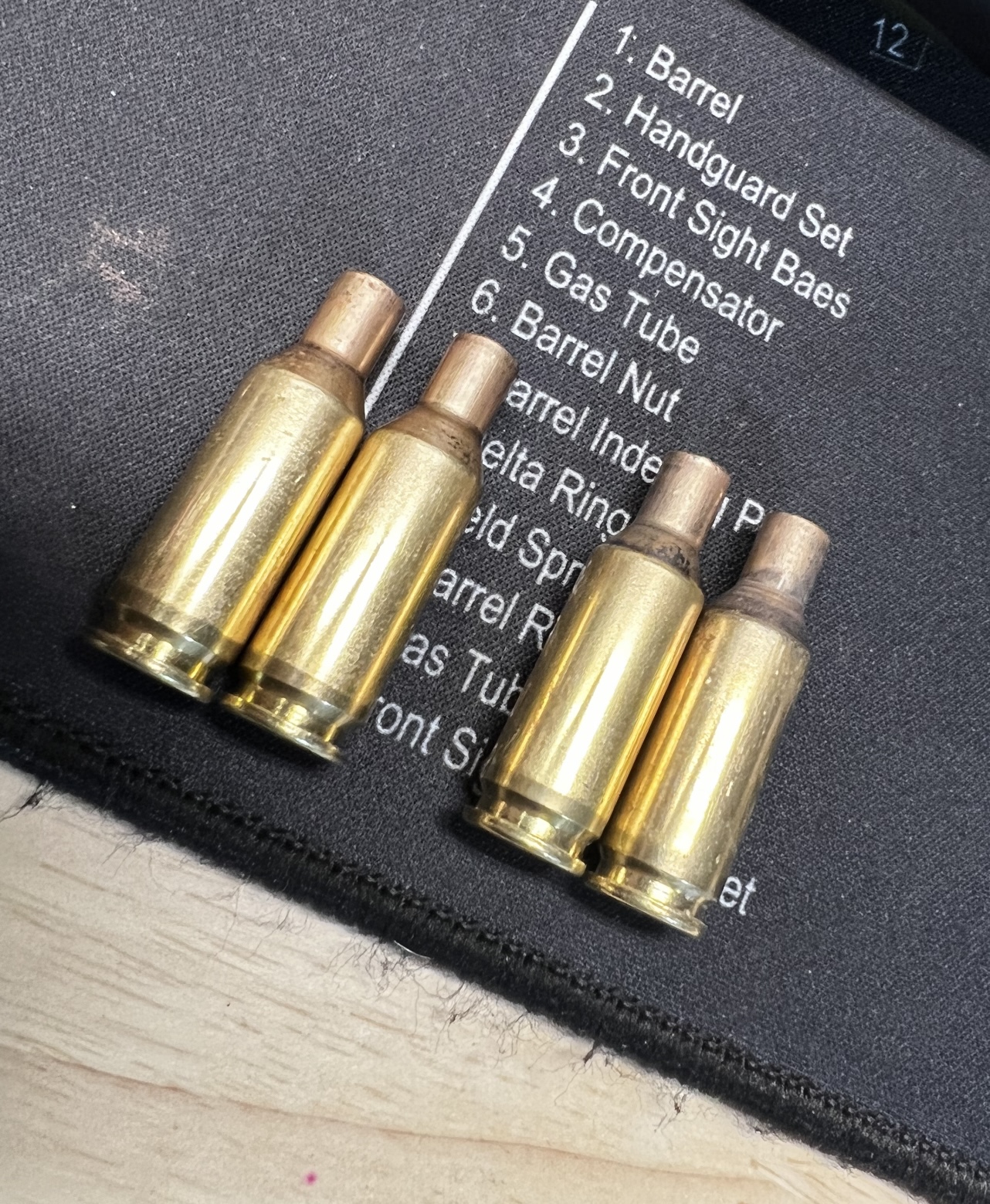

Shooting a 6 BRA, had great success fire forming with Lapua brass. Primed them, charged them with 29.5 of H4895, seated Berger 105 vld .020 into the lands and blasted away. ES almost into single digits and 1 hole groups common with 5 shots at 100 yd. This was the case for my rifle and my dad’s, I built them both with almost identical components.
After fire forming I cleaned the cases, annealed them with my AMP on code 153, sized them bumping the shoulder .001, opened the necks with .2400 mandrel, trimmed on Giraud, and found that .040 off the lands gave me a generous POI window with excellent accuracy, and 30.3-30.5 of H4895 all seemed to shoot well, leaning toward 30.4.
My problem is velocity. Accuracy is commonly in the 1’s-2’s with 5 shots, but ES on those 5 may be 20-30fps. SD from 10-15. I don’t find this acceptable. I noticed on my FF cases there is very little carbon, and it’s almost all on the neck. On my reloaded cases that have been processed, I’m getting a lot of carbon all the way down on the shoulder. I have a large suspicion this has something to do with my inconsistent velocities. Is the AMP code I’m using incorrect? I’ve burnt several cases and it keeps giving that code. I am wondering if the brass isn’t getting sufficient annealing? Any thoughts are appreciated. Picture is of FF cases on the left and processed cases on the right; you can see the difference in the carbon between the two.

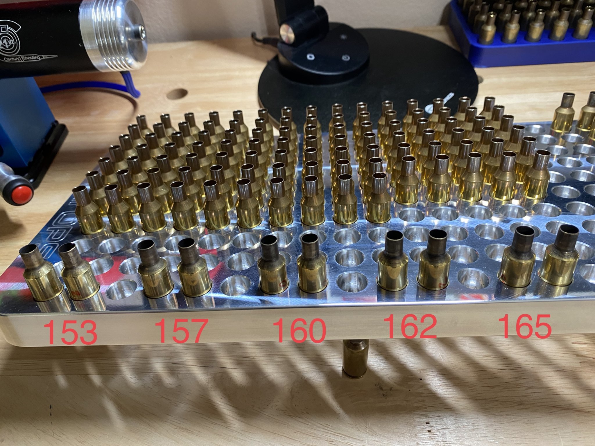

I have 10 rounds loaded up for tomorrow… 2 at each of the following anneal codes: 153, 157, 160, 162, 165. Going to shoot them tomorrow and see if I can tell the point where they start sealing up at the neck. I can say I’ve already noticed a difference in sizing the cases; 153 has a lot of springback whereas the higher codes have much less. We’ll see what happens.

I was able to fire the 10 rounds I loaded at different annealing settings; wind was blowing over 20 mph but that doesn’t really affect this testing. Accuracy is still good, still not sure what to think about the neck sealing up properly. Lowest amount of carbon seemed to be at anneal code 160. 153 and 157 still had carbon rings, and oddly enough 165 had the most carbon of them all. I figured it would seal the best. I’ll post some pics.

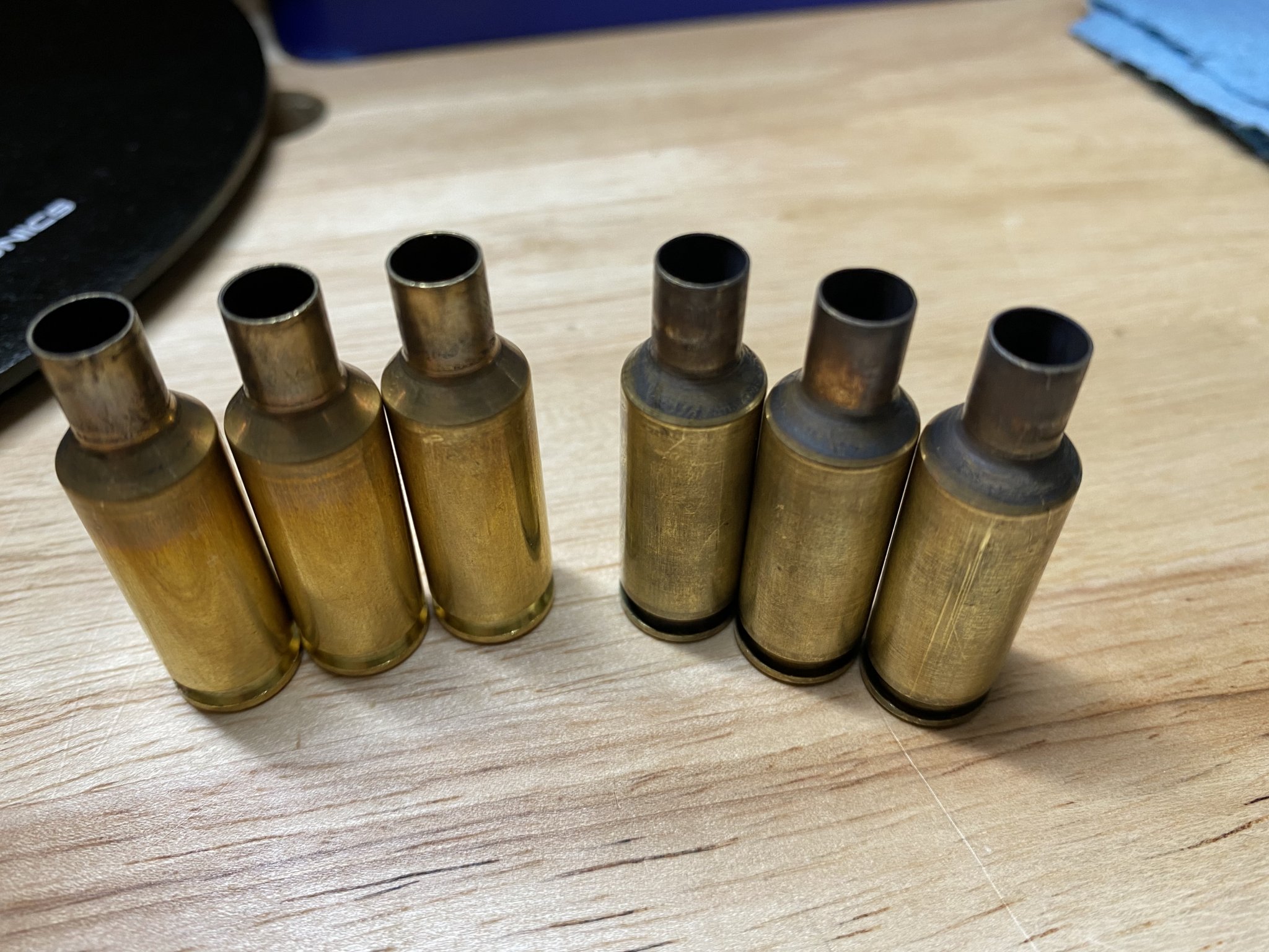

Sorta tough to show in the picture, but the cases on the left were fired around 1500 rounds, and the cases on the right were fired from the same chamber around 2800 rounds. There is decidedly more carbon on the cases to the right.
