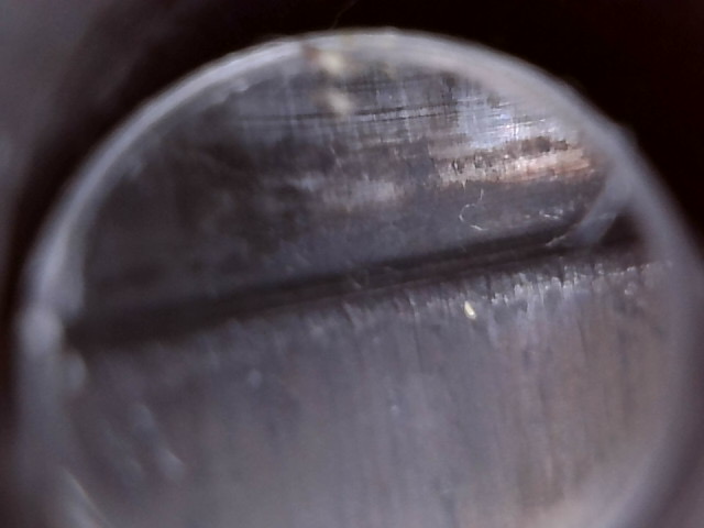

J Jolliec Sergeant of the Hide Full Member Minuteman Supporter May 18, 2018 156 48 Mar 19, 2023 #1 Mar 19, 2023 #1 Is this a carbon ring or just degraded edge of the end of chamber? Attachments IMG_2077.JPG 41.7 KB · Views: 203 IMG_2076.JPG 42.8 KB · Views: 207
spife7980 Luchador Full Member Minuteman Feb 10, 2017 14,143 17,620 Central TX Mar 19, 2023 #2 Mar 19, 2023 #2 That’s an extremely dirty chamber and yes, it’s the neck bore step at the end of the neck that’s eroded and rounded over.

J Jolliec Sergeant of the Hide Full Member Minuteman Supporter May 18, 2018 156 48 Mar 19, 2023 #3 Mar 19, 2023 #3 Do you think its salvageable or should I just replace it?
B BPGuru Private Minuteman Apr 10, 2020 98 45 Mar 19, 2023 #4 Mar 19, 2023 #4 Jolliec said: Do you think its salvageable or should I just replace it? Click to expand... How does it shoot?

Rob01 Super Duper Moderator Staff member Moderator Full Member Minuteman Jul 9, 2001 18,793 16,532 NC Mar 19, 2023 #5 Mar 19, 2023 #5 Give it a good cleaning and then take a couple more pics and see.
J Jolliec Sergeant of the Hide Full Member Minuteman Supporter May 18, 2018 156 48 Mar 19, 2023 #6 Mar 19, 2023 #6 Groups have grown quite a bit and its a bit erratic velocity wise.
J Jolliec Sergeant of the Hide Full Member Minuteman Supporter May 18, 2018 156 48 Mar 19, 2023 #7 Mar 19, 2023 #7 It's soaking in C4 now... Will add pics once I clean it up. Last edited: Mar 20, 2023 Reactions: ShtrRdy, max1840 and deltawiskey
D DocRDS Head Maffs Monkey Full Member Minuteman Feb 21, 2012 4,150 7,934 The Great Beyond Mar 20, 2023 #8 Mar 20, 2023 #8 Is that the chamber? It looks like (very dirty) rifling to my (uneducated) eyes
B brianf Private Full Member Minuteman Apr 8, 2010 8,133 12,024 48 NY Mar 20, 2023 #9 Mar 20, 2023 #9 how long since you last cleaned your barrel?
J Jolliec Sergeant of the Hide Full Member Minuteman Supporter May 18, 2018 156 48 Mar 21, 2023 #10 Mar 21, 2023 #10 Has a few hundred 300 PRC down it. Has not been deep cleaned in a while.
