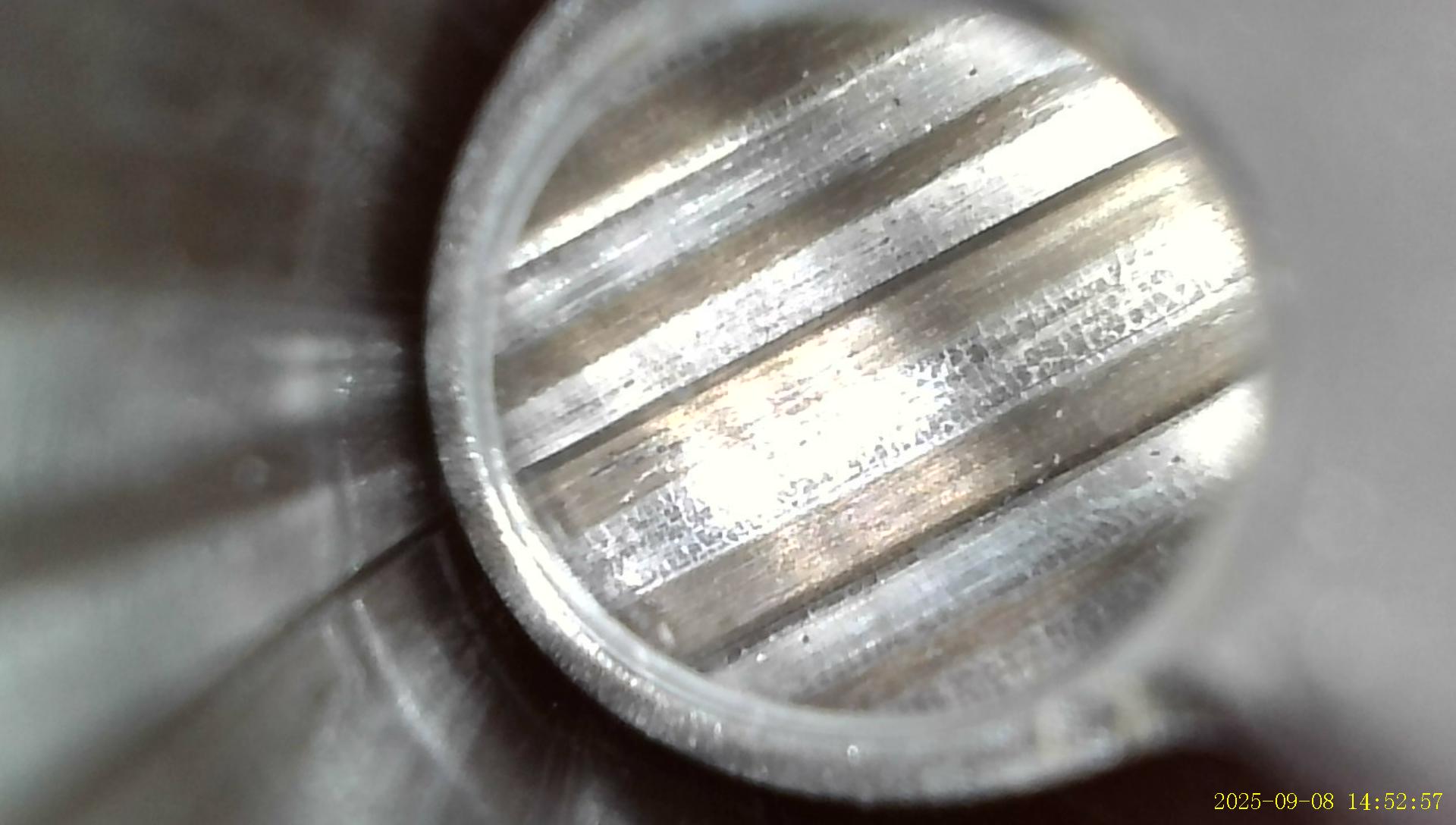

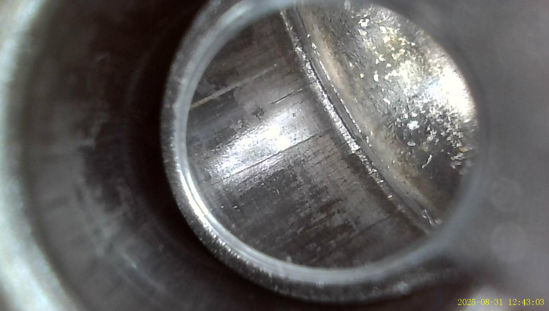

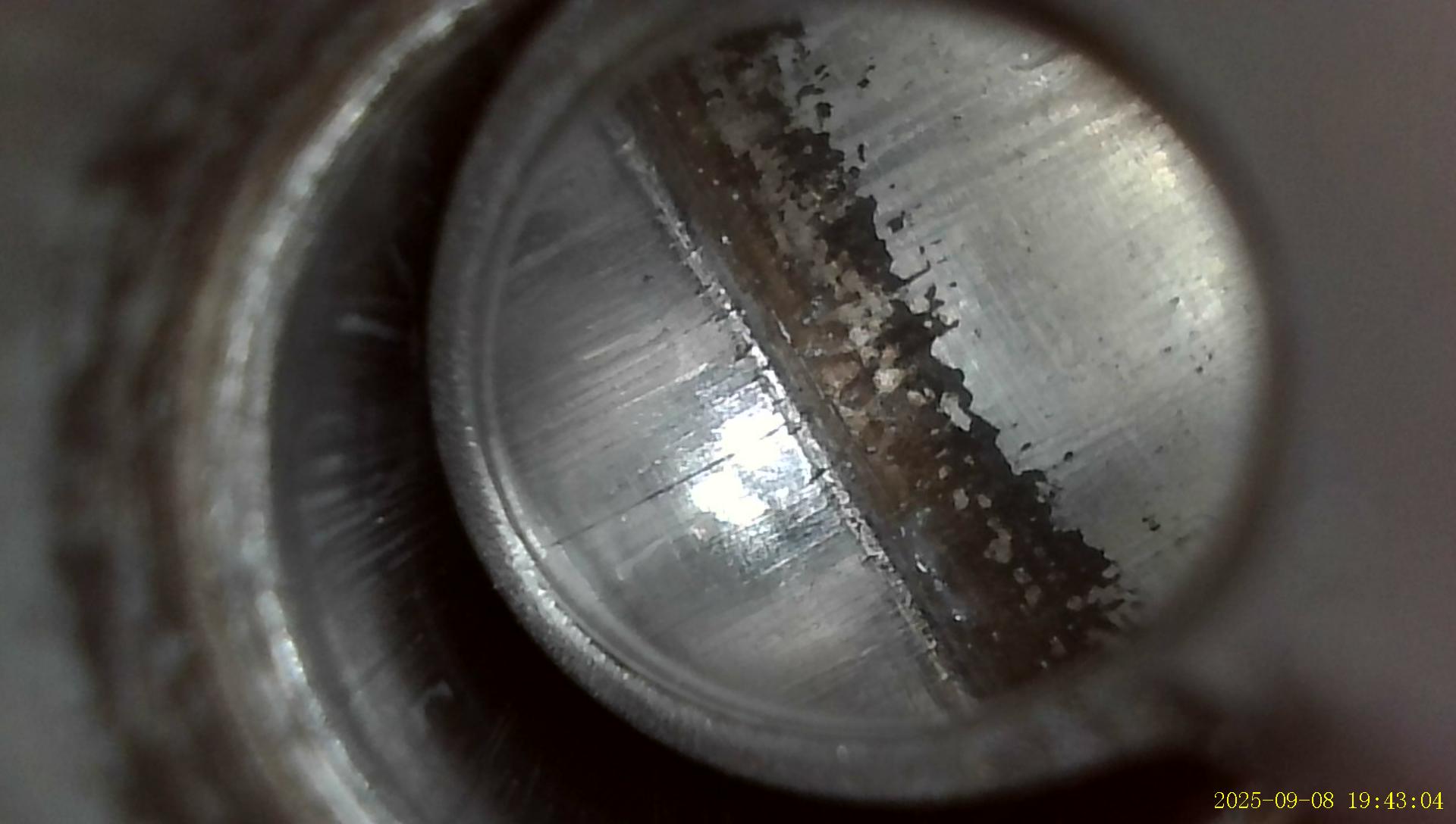

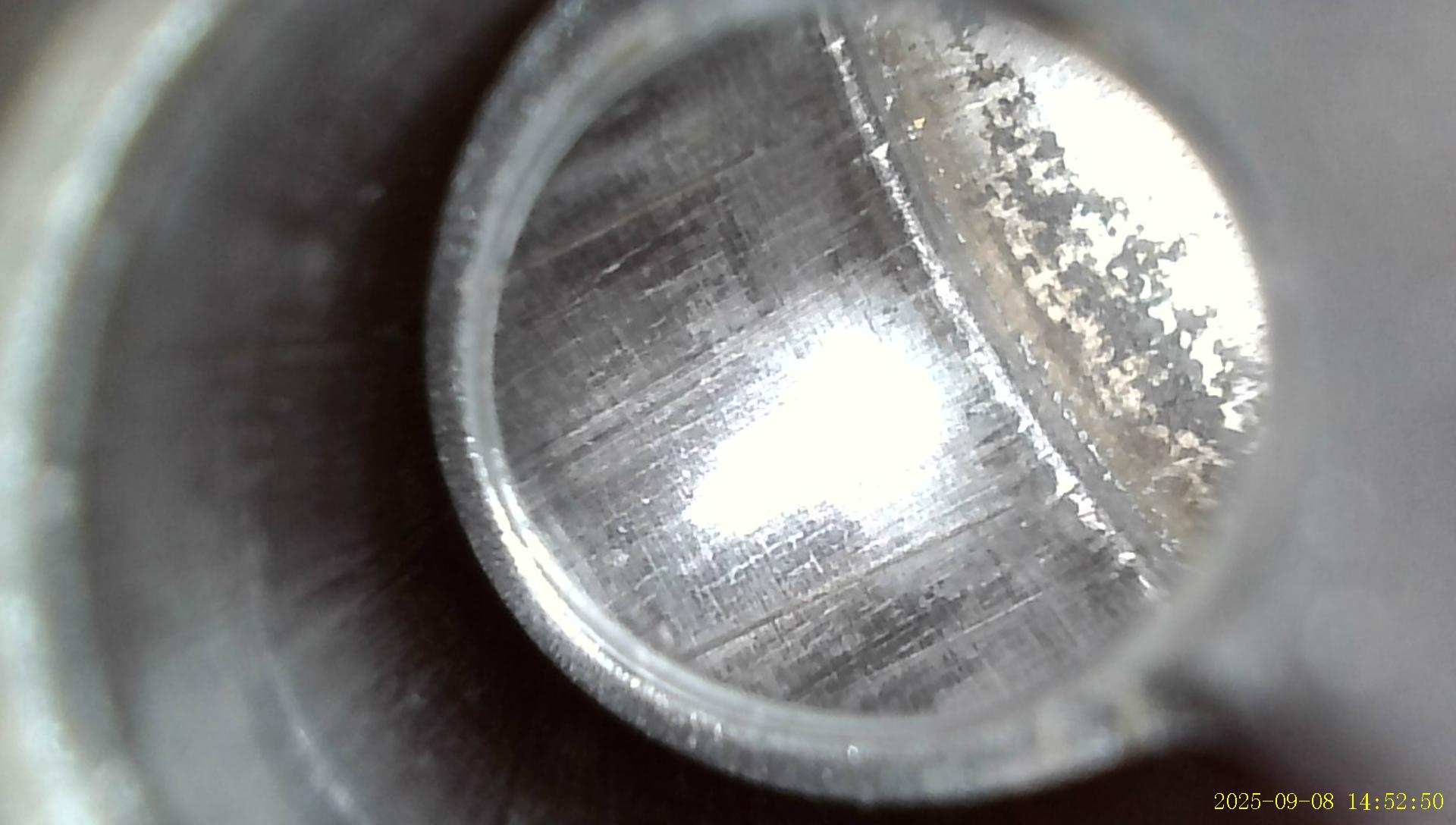

So I got the cleaning kit and wondering how clean is too clean.. Should I completely get rid of the carbon ring or just a mild scrub.. I did 2 x 20 passes with the Thoroclean system and got rid of a lot of carbon. BArrell looks much cleaner. Should I keep going?
I think I will do one more pass of 20-30 and see where I am at.
Here are some before and after pics..
Mike

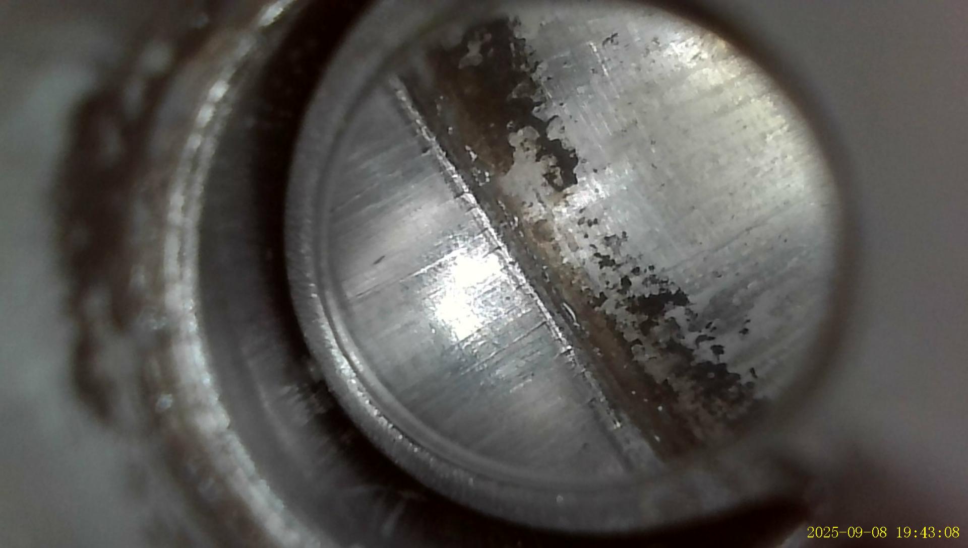

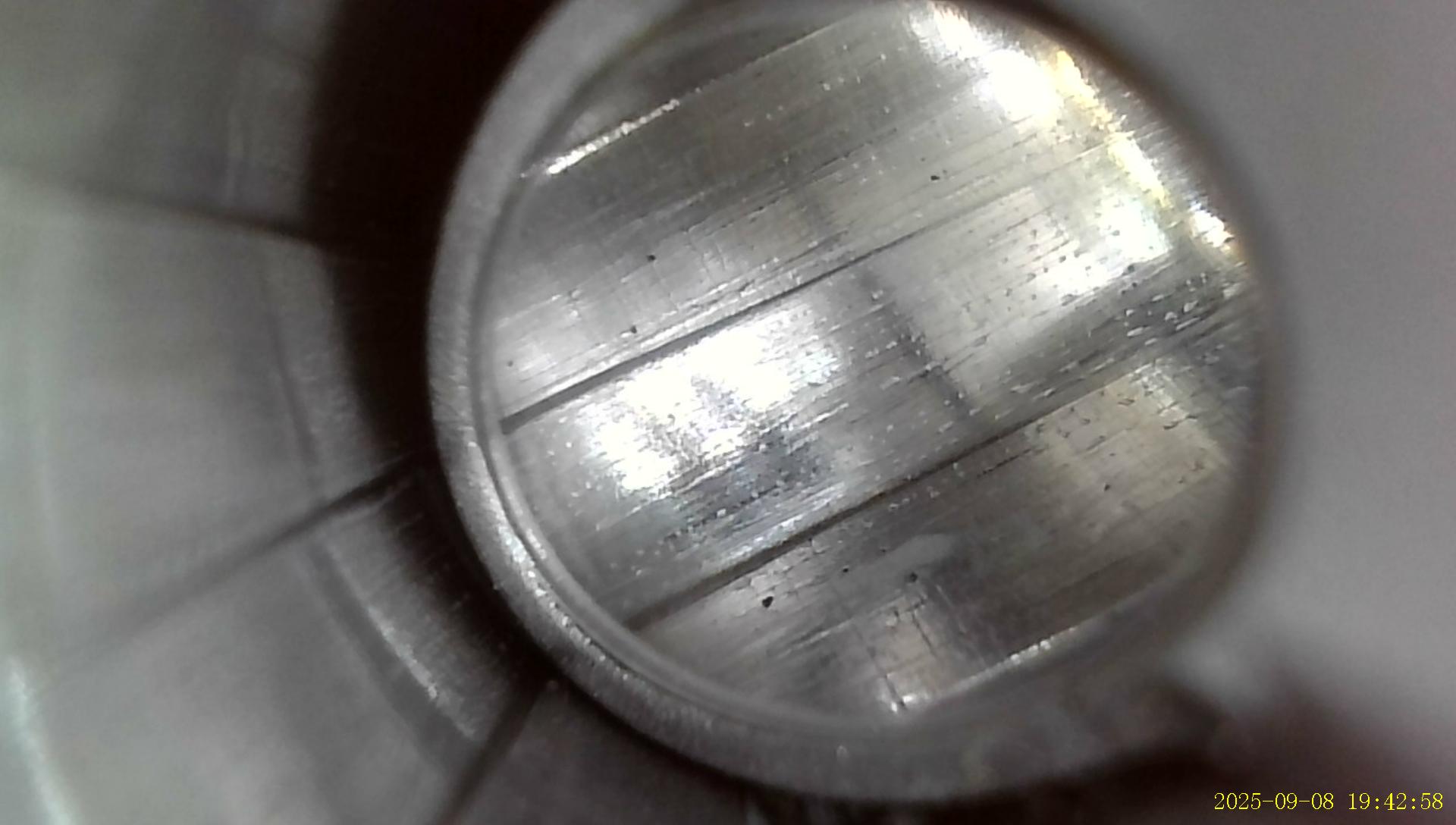

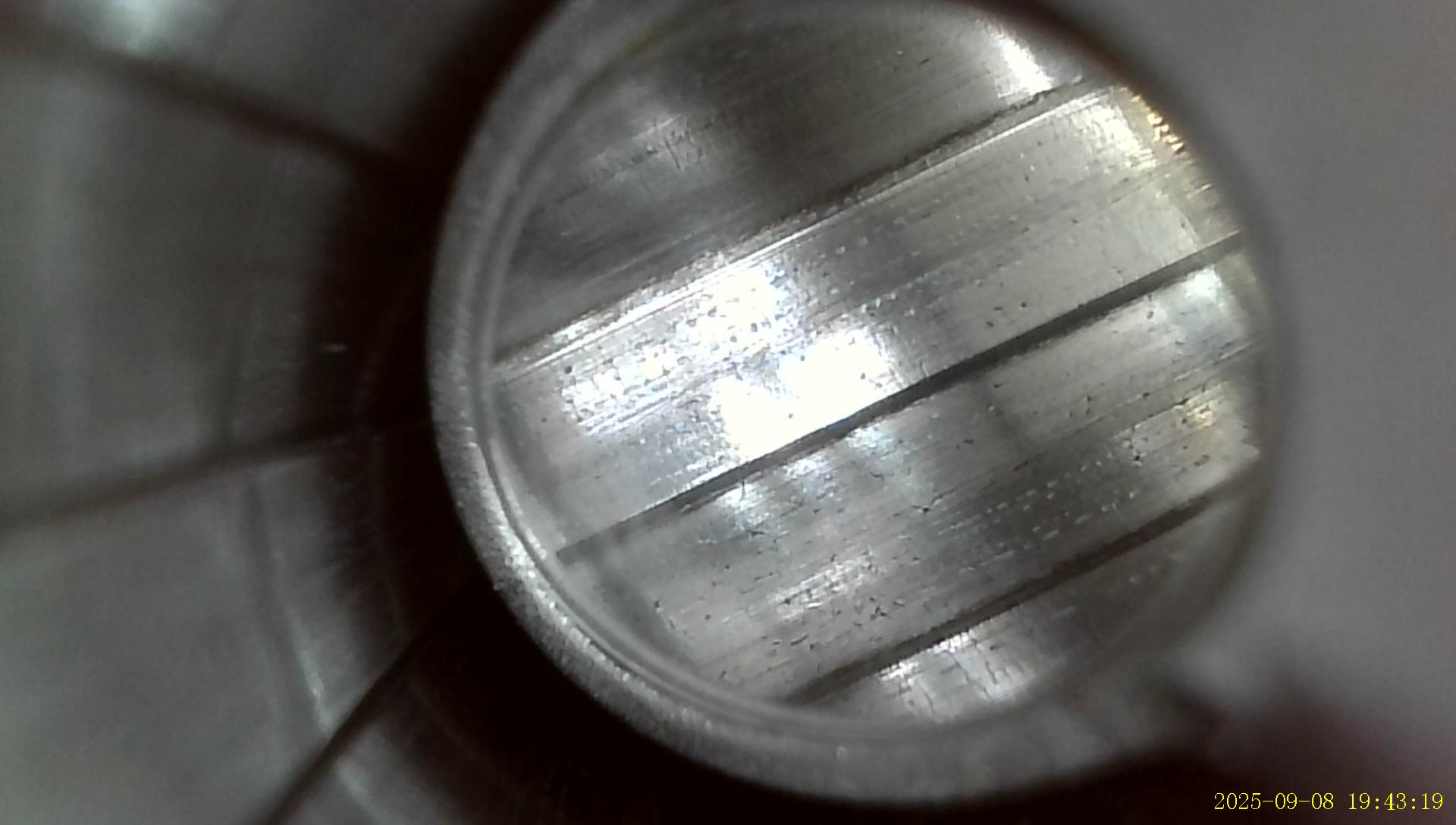

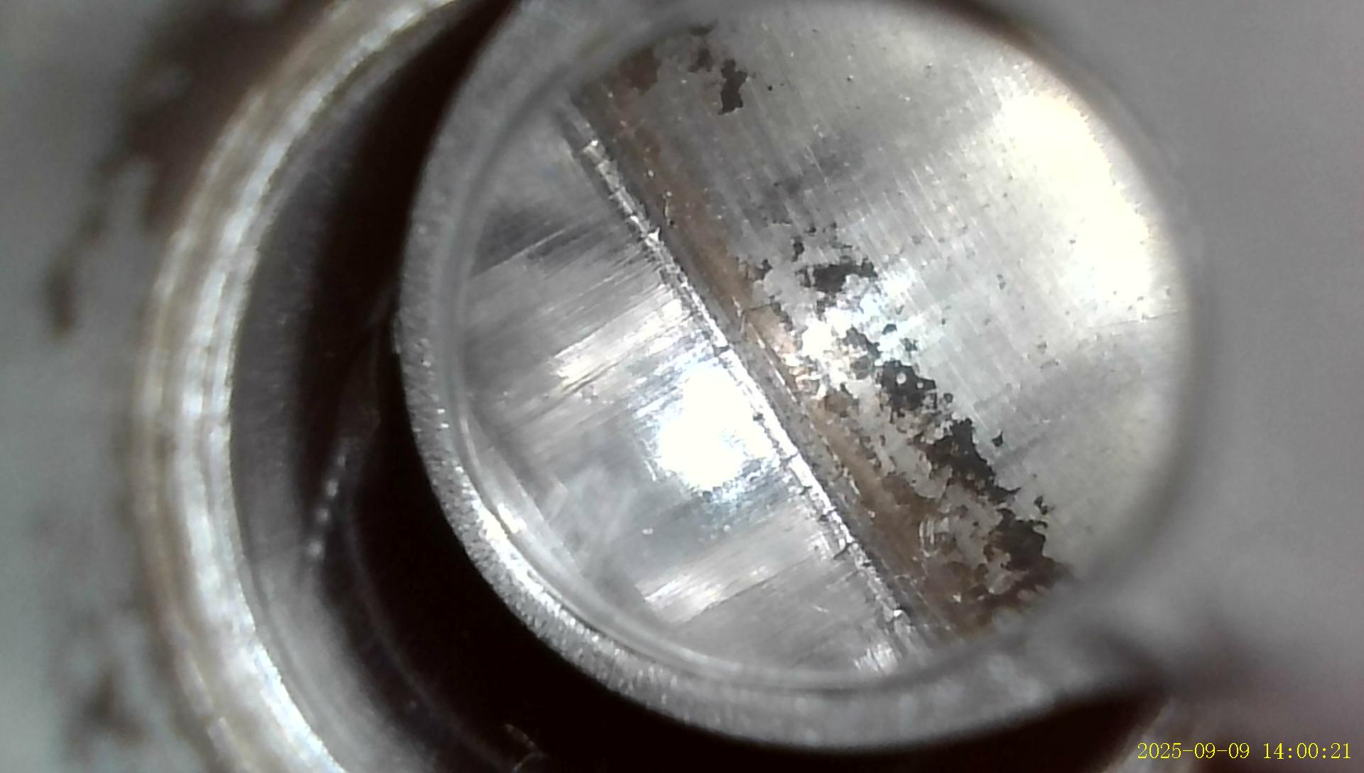

So I managed to run another 40 passes or so.. Barrel came out spotless but I can't get rid of the remnants of the carbon ring. Its much cleaner then it was so I think I am going to leave like this for now.
The carbon is gone from the rifling even from the area where the lands start. Just this ring right before rifling starts.
Mike

I'll try the C4 as I have some on order before entertaining the CLR as I have read a lot of potential issue with it. I am planning on using C4 as my normal maintenance and use the ThoroClean every 300 rounds or so if it looks like it needs it.. Barrell is almost perfect so no need to do more. I stopped once I got 90-95% of the copper out.. Didn't want to overdo it.
I used a Nylon brush as well. Just the carbon ring left.

I used some Balistol to soak the ring a little and scrubbed with a soft Nylon brush. Waiting on some C4 to come in.. Getting there I think.
MIke
