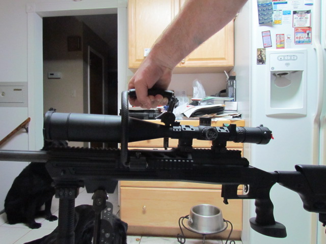

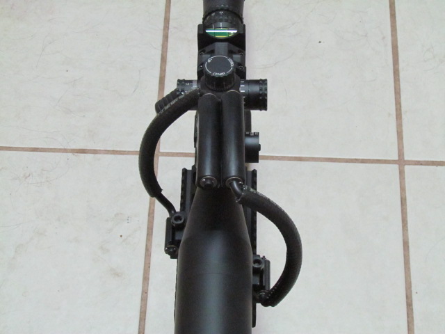

What I wound up doing was having a local gunsmith modify some of those cheap handles you can get on Amazon for your AR into a very stout 2 handle system, replacing the narrow gauge wire with something about 1/4" and tempered once shaped. I added some automotive hose around it to avoid metal to metal chipping on the finish and scope. Here's the result:
The wire curves well out to allow for the scope, or a much larger one like the PON3x78, also with good top clearance for the hand and larger scope.

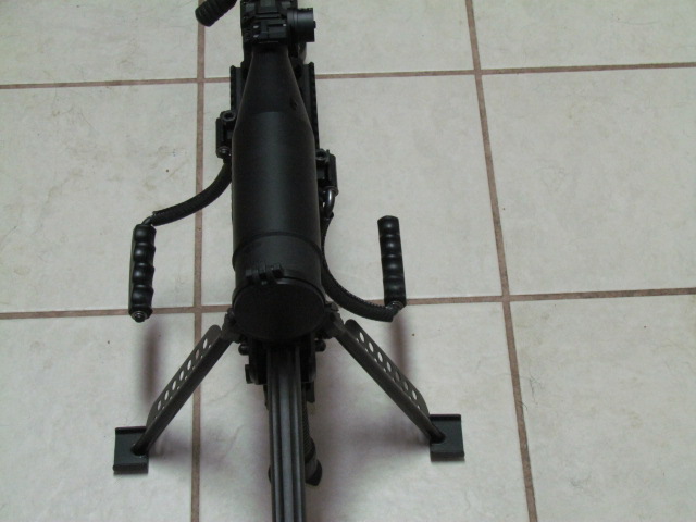

When the gun is set down the handles fall off to the sides out of the way.
