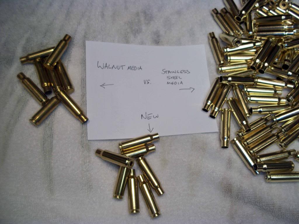

I take the step of shaking the shells out or tapping them on a towel to get water out of the primer pockets and shell bottoms. I tried blowing them out with dubious benefits. Something tells me a low pressure air compressor nozzle would do wonders but I haven't tried it.
1i-Comparison-2_zps006f1450.jpg[\img]

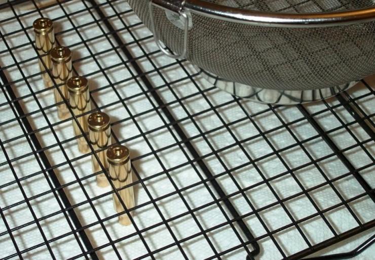

I rinsed my brass and tumble it in a bath towel. Then I place the the cases neck down in a bakers cooling rack (purchased from Wal Mart) on a baking pan covered with paper towels. Then its into a preheated 200 degree oven and turn off the heat. Works great!
If the brass is too short for the cooling rack I'll use a stainless spaghetti strainer.
