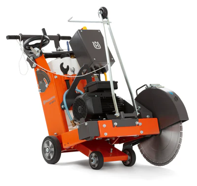

Walk behind for much of it (I would say anything over 10 ft).

That handheld Bauer might get the job done just fine, but you will be on your hands and knees, and the slurry will make a royal mess of your clothes. Unless you plan to do a lot of this in the future (in which case I’d buy a walk behind) then I would rent one and an electric jackhammer. Also, if you have a worm drive skillsaw then you can buy a diamond blade for it and use it and a grinder to finish cuts up to walls if needed. Another thing to keep in mind about concrete saws is that I’ve seen the small ones not cut deep enough. A walk behind with a 16” blade is the way

rent a walk behind, or a gas Stihl like a TS420.
Those electrics can't make 4" in one pass, so you'd have to do it in two cuts. I'd stay away from the battery powered ones as well, they run though batteries and take a very long time.

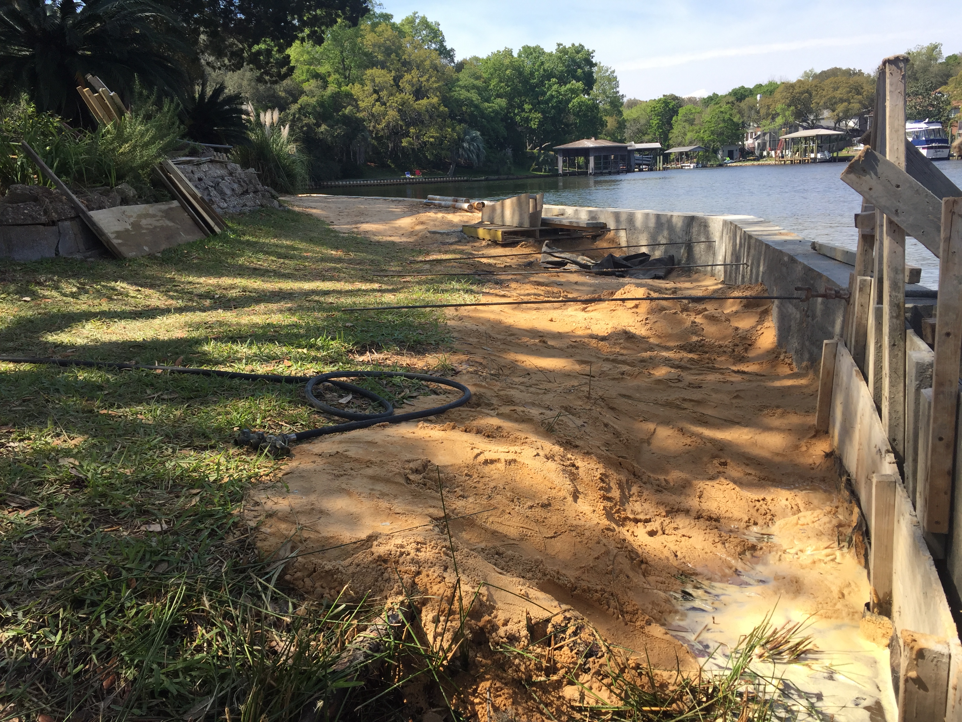

A 450' concrete retaining wall I built by my self.

Rent a walk-behind.

If you're going to do it, cut it wet. A Husqrvarna K760 (gas) would do that in about an hour. The electric variants need about 20-30 amps , mine require a generator connection as most panels don't want to do that load. A rental walk behind is a good idea, as handheld saws will do it, but if you're not in good shape or young, they will beat you up. You don't even need to through cut it as a 16# sledge will crack it up.
