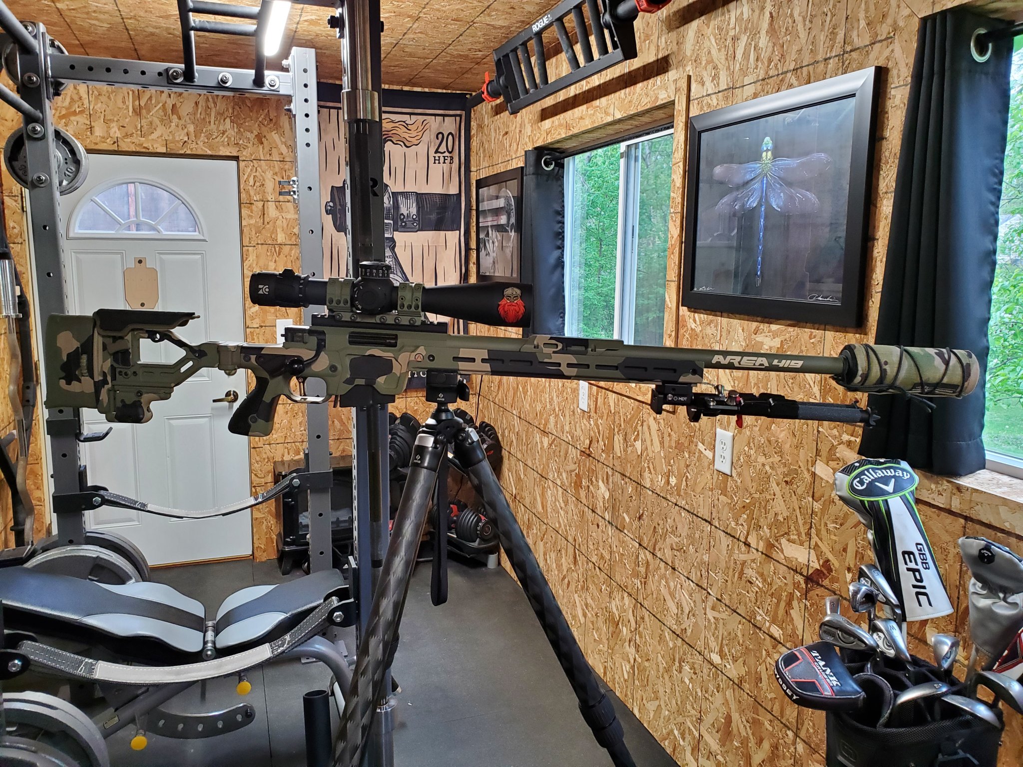

Long story short I sent an atlas bipod and badger maxx mount off to get cerakoated to match my ax in sage green. It wasn’t even close and my bipod came back to me unassembled. I asked for the inside of the rings to be uncoated and left alone. Well they just ignored that and coated them anyway. I then try to just match it with some spray paint and really can’t find a good match.
Anyone have a recommendation who could take on the work and fix my dumb mistakes? Would really like this to all match up.
