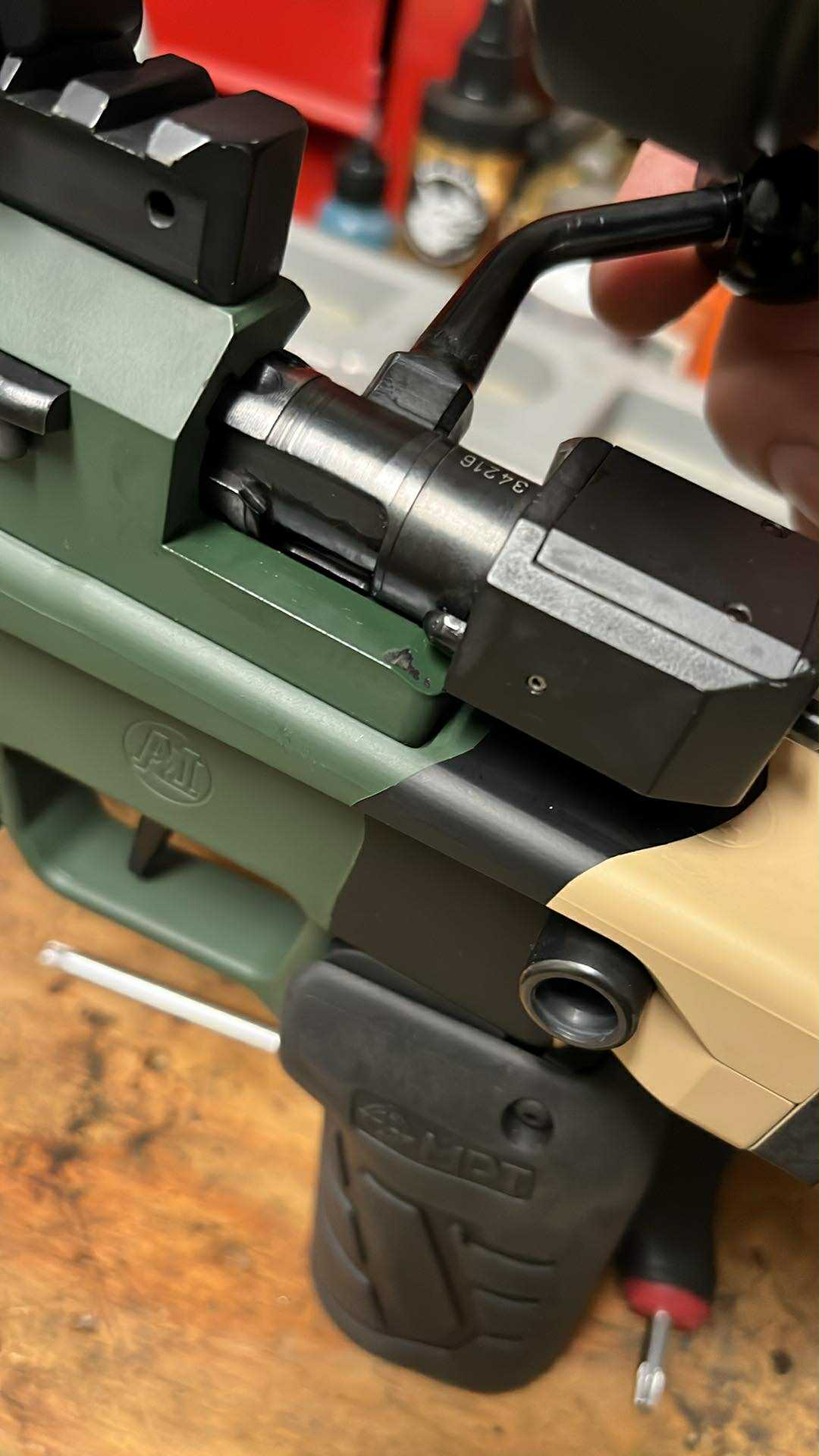

Bolt is sticky/binding some when cycling. What are my options for removing cerakote from inside the action that won't damage the metal underneath? Do I just need to send it off for dlc coating and let them remove it and coat it back?

Is your bolt body coated as well?
Removing CK from inside the bolt raceways will be a PITA.
Only way to remove properly applied CeraKote is surface to surface abrasives or blasting.
Can confirm. Never Cerakote a bolt, at a minimum. I like Cerakote, but I learned to not to apply it to the bolt or the raceways after the first one I did.
My understanding is that salt blasting from a sand blaster can remove cerakote but will not damage most anodized or DLC finishes. I could be wrong but look into that as well. I was looking up how to remove cerakote from some higher end firearms to restore its original look a couple months ago.

Update: crisis seemingly averted. Someone lubed the new prc bolt with grease and the back of the bolt was/is contacting the action. Apparently there are some minor differences in the new AI AT bolts vs old. I cycled it a ton both dry and lubed and it’s nowhere near as bad. Obviously I can make it bind if I get too far off center when pushing the bolt back in, but as long as I’m square behind the rifle it rarely happens. Pic of contact area below.
