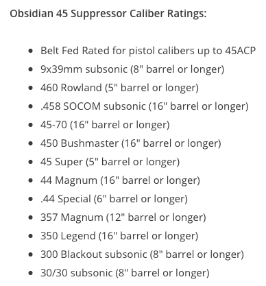

Never shot a CGS pistol can, but I can say that I went with the Rugged Obsidian 45 because it's light, and super strong. It's even rated for 16" .350 Legend, .44 Mag, and .45-70 Gov't. That's a strong pistol can! And the modularity of it was a big plus. Also, rumor has it (never tested myself, so I can't say 100%), that the Obsidian 45 on a 9mm is quieter than most other 9mm specific cans on 9mm pistols... That's what some folks have claimed from their tests...

I honestly don't think you'll be dissapointed with the Obsidian 45... The modularity, sound suppression, weight, strength, warranty, and customer service of Rugged is hard to beat for $699...

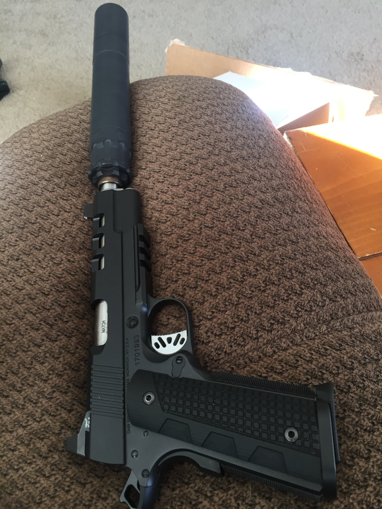

I have the Obsidian 45 and like it. It is a very well designed and manufactured suppressor. To be honest I’ve never done any test for POI shift, but then again I do not to shoot bullseye with it.
