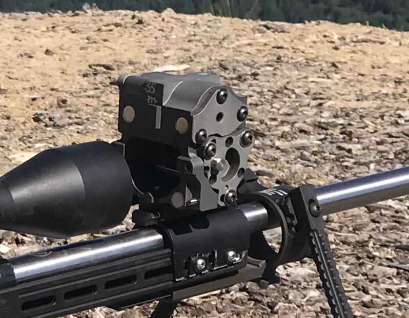

Building up a 37xc and trying to decide between a stock or chassis and one thing that comes to mind when deciding is the best mounting solution for a tarac. Now I know a guy can probably mount a tarac on a NV bridge if going with a traditional stock but that probably isn’t ideal so what is the most solid or tried and proven way? Scope mount it or rail mount it like on an aics AX chassis where you have one long continuous rail. One thing I can see with a rail mount unit is if the rail flexes that could cause issues. Although mounting to the scope objective via magnets or clamp doesn’t look the most repeatable either.
Guys that have one what route did you go and are you happy with it?

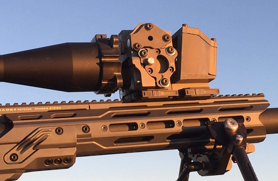

I think I’m going rail mount so I can use it on multiple rifles but the scope mount is super clean and easy.

The easiest way to mount it is the rail mount on a chassis. If you're using the McMillan beast, you have to build a bridge or just use the magnet mount directly to the scope.

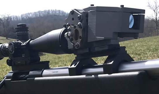

I've spent a little time with a friend's Charlie TARAC. After seeing both mounting options, I would opt for the rail version. Hanging that much weight on the end of my scope would not be my choice.
Hanging a charlie on the scopes objective is not a big deal at all. We ran our first one like that for a year or so. Now mounting the combo charlie/delta on the scope would be a definite no-no!

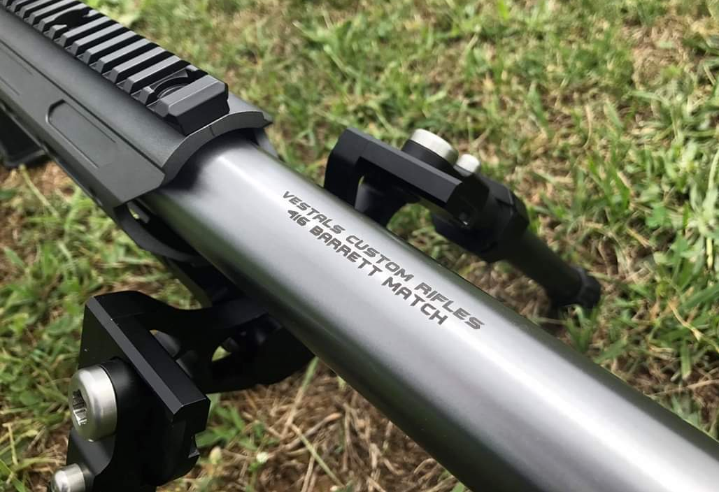

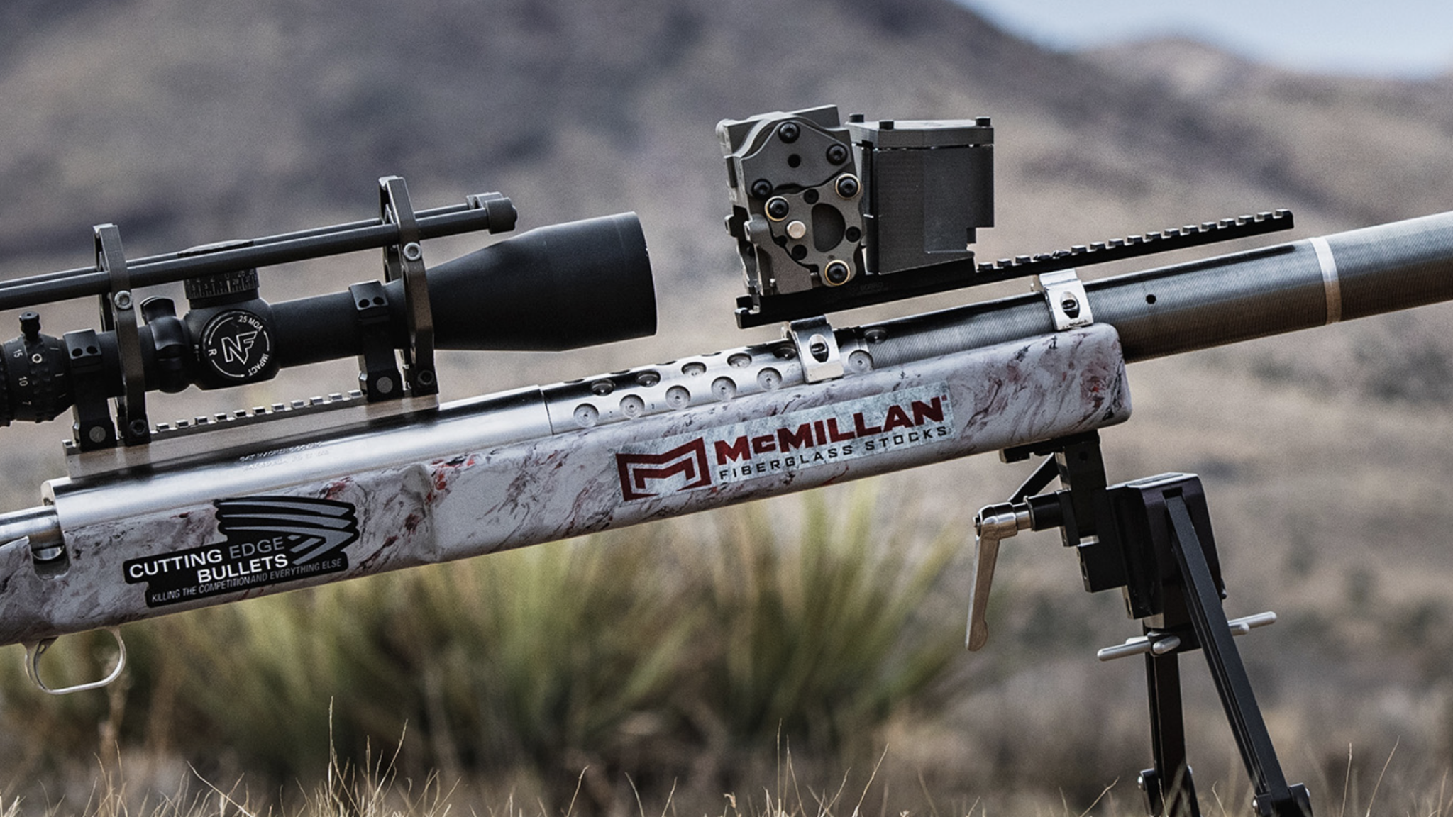

Here’s an option on a McMillan with a pig of a barrel.

Looks like a structured barrel done by tacomhq Is that Paul’s rifle or mikes?

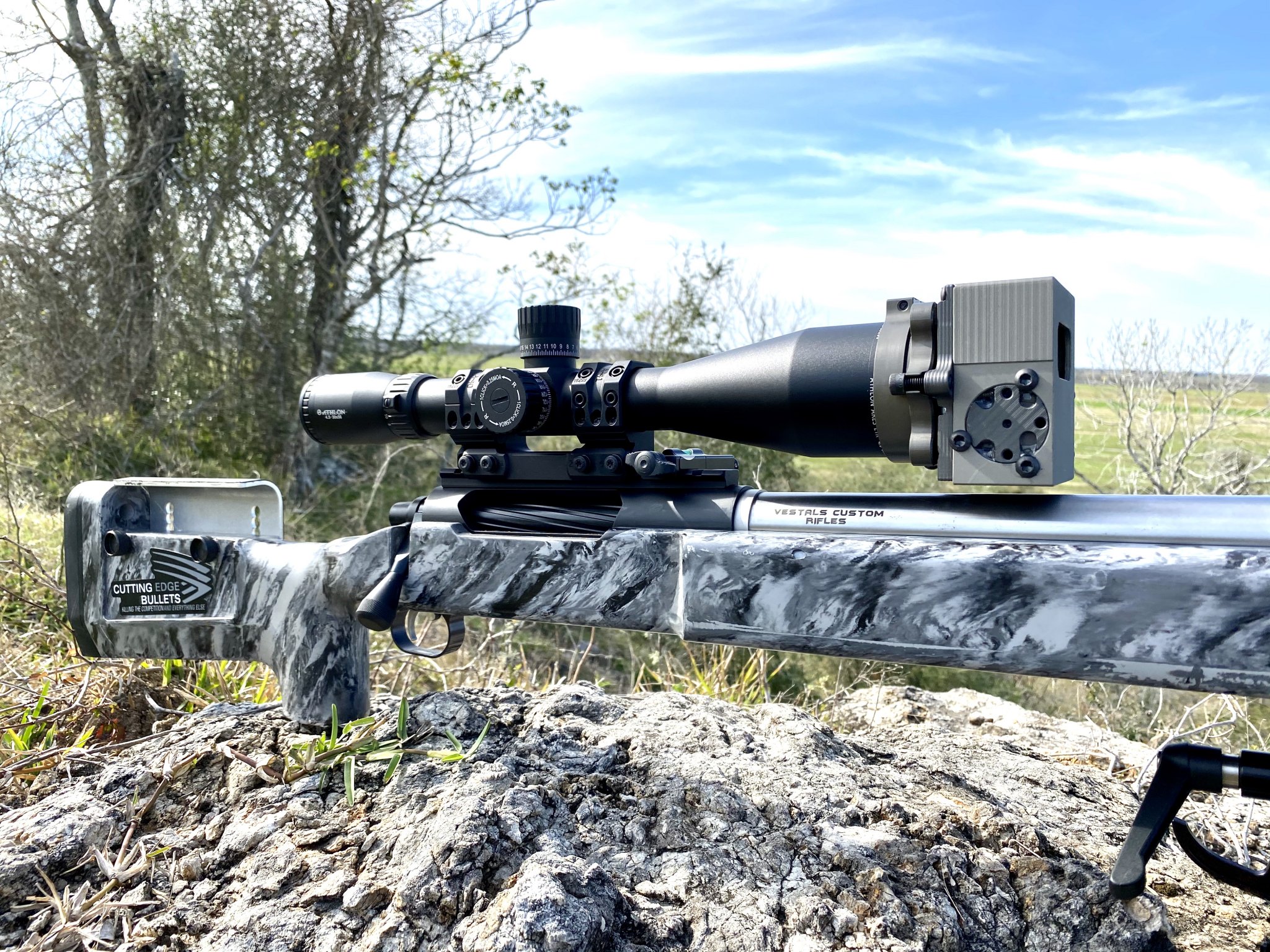

The scope mount is very repeatable and easy to use. I really didn’t want to drill holes in my stock unless I had to.
