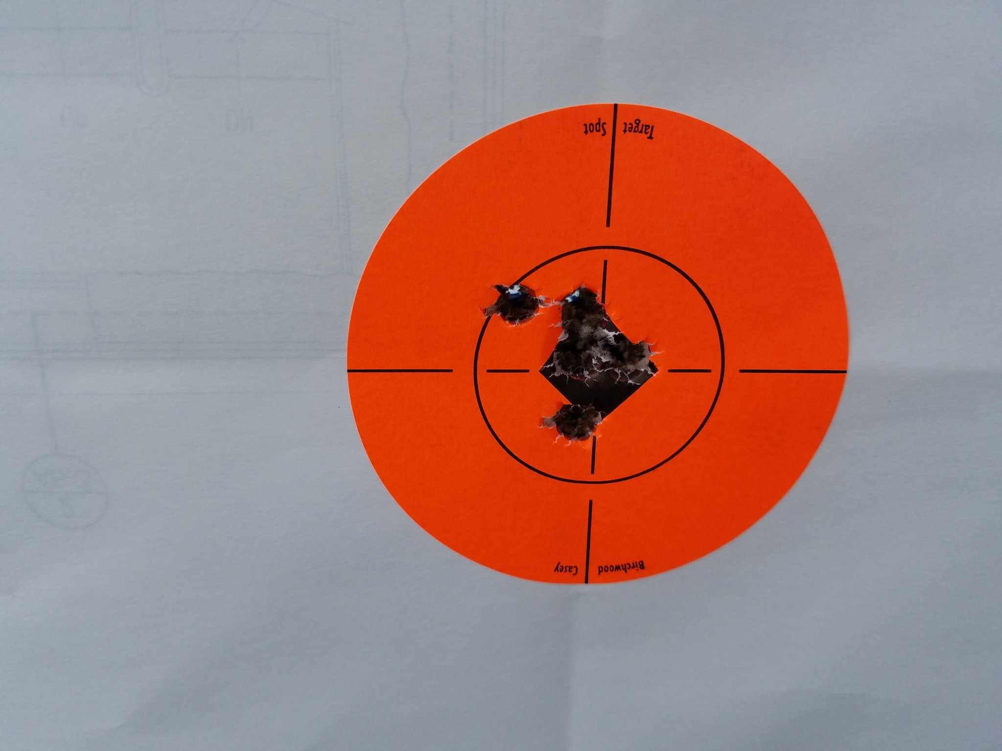

Have you tried to torque tune the Accu-Stock yet?
Below is my creedmoor in the accustock at 300yds. Cold bore is high left. My rifle shot lights out with the front screw @ 35in/lb and the rear at 30 in/lb. That rifle was consistently under .5moa mark shooting 147's @ 2830-2855 with R 26 I started at 2855 then when it seem to speed up I found it shot better with the bullet seated .012 deeper and .3 grains less powder. Cold bore was out when clean or dirty though.
All that being said I would get a chassis with the 3.85 cip cut for the 300 and whatever suits you best for the 308. The ESS from MDT would work. The lss xl or something from XLR if you want lighter for the 308. The magazine upgrade is worth the price of admission with the savage.
