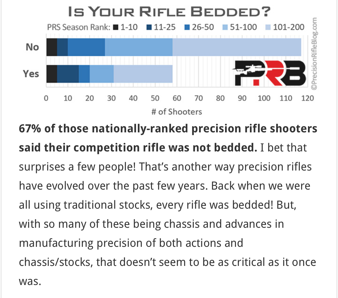

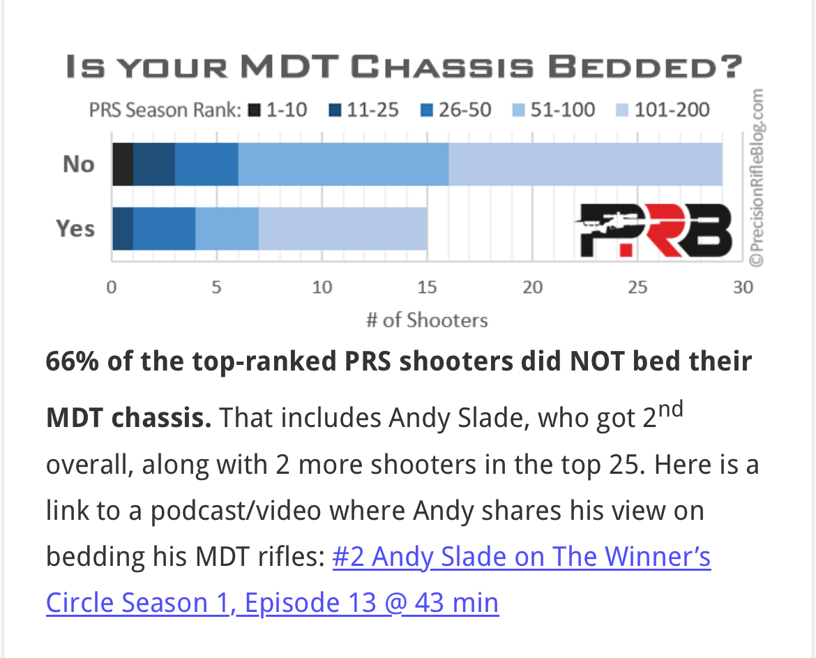

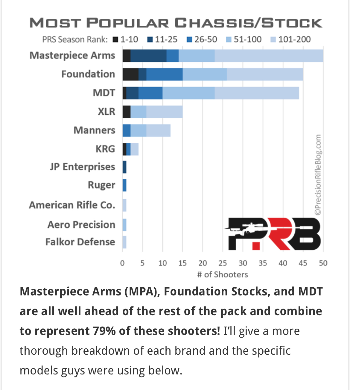

Just throwing out the other graph from the #3 chassis in that article (MPA, foundation, and MDT made up almost 80% of the data)
Between those top 3, it looks like ~93 did not bed and ~36 did bed their chassis/stock.
Below is the graph for all stocks/chassis in the poll

No. I do not see any problem with bedding a chassis.

As mentioned in the second post, it’s unlikely it’s just a better safe than sorry reason. If so, it would be reflected in other chassis/stocks.
It’s not very likely that people using Foundation stocks are less cautious than those using MPA.
Most that bed chassis have done some sort of testing and have seen things like a zero shift from rough handling of the rifle.
The point of referencing the people in the article doing so isn’t the driving reason to do it. It’s just an example of how common it is, compared to how uncommon most expect it to be.
People have been bedding chassis for years. It’s similar to dialing wind. 3-5 years ago, you’d get crucified for telling the internet you dial wind, however many top shooters were dialing.
Joe walls beds anything and also builds a ton of prs rifles I’m sure that would have some play in the bedded foundations.

Would it be fair to say that the vast majority of bedded composite stocks (CF, Fiberglass, Micarta, etc.) are pillared when they are bedded?
I thought the whole premise in justifying a properly pillar bedded stock was to have zero compression.
