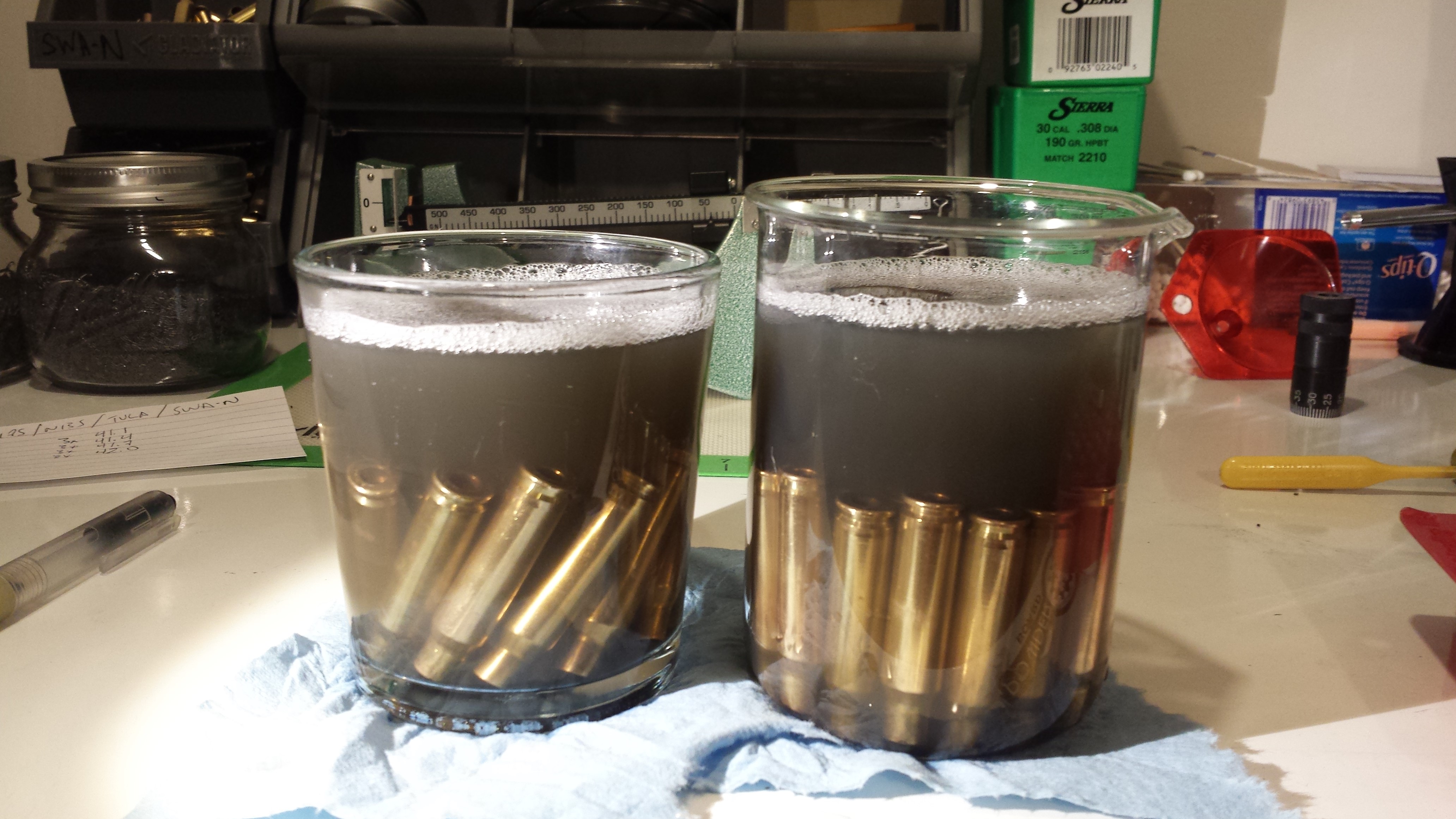

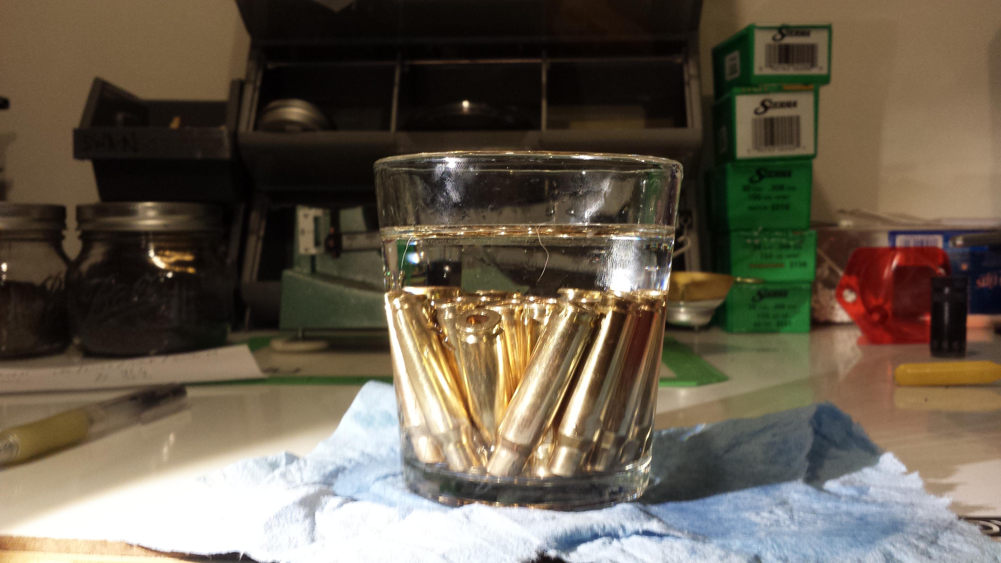

Arnie, not sure if this would work for you but my u.s. routine goes like this...after annealing I put about 20 cases neck down into a glass (started with beakers but went to 8 oz tumbler type glass). I make sure they're all standing upside down. I froth up some dawn for suds, pour in boiling water to fill the glass, then set the glasses in the ultrasonic with water up to the fill line. A shot (tsp/tbsp) of mild citranox solution (maybe 1:30 mix) into the glass right before starting the u.s. If I add the citranox too early it will pink the brass. 15 min run time, the water in the glass is now pitch black. Dump it out and rinse the cases thoroughly in the glass to remove all cleaners, then spread on a cookie sheet to dry. Extremely clean and pretty fast/easy. I stole an electric kettle from my girl and keep it plugged in by the cleaner, I plug it in right after I'm done annealing so it's hot by the time I get the cases in the glass. Pointing them down lets the sludge fall out I think

black liquid is after US; clear is after final rinse
