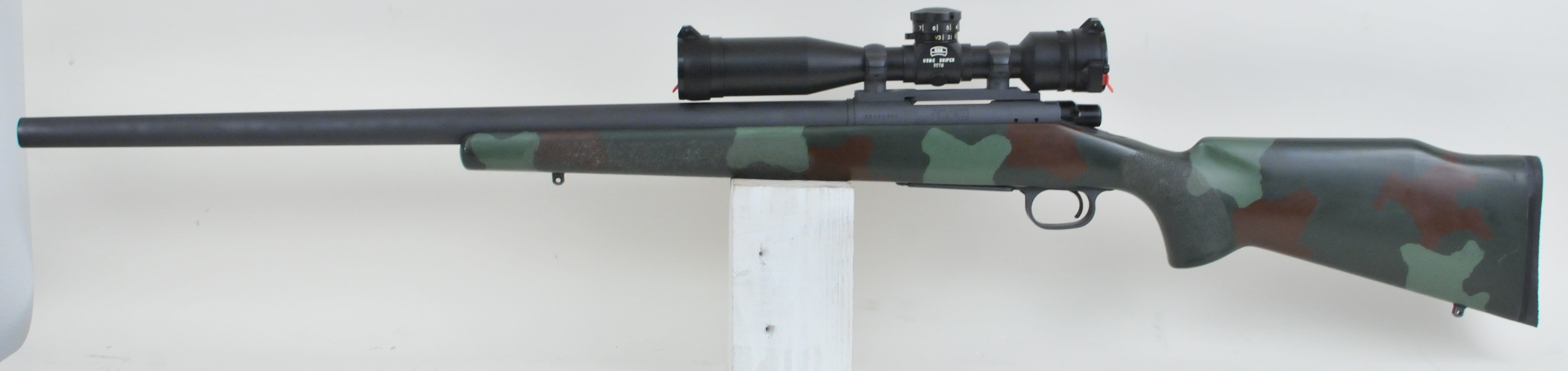

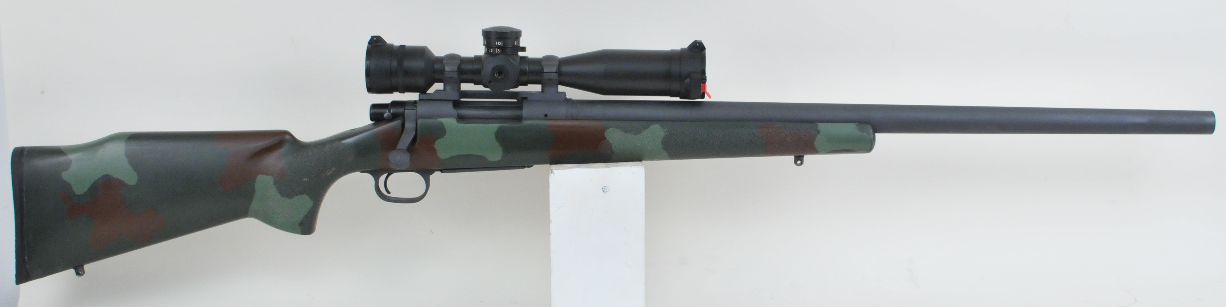

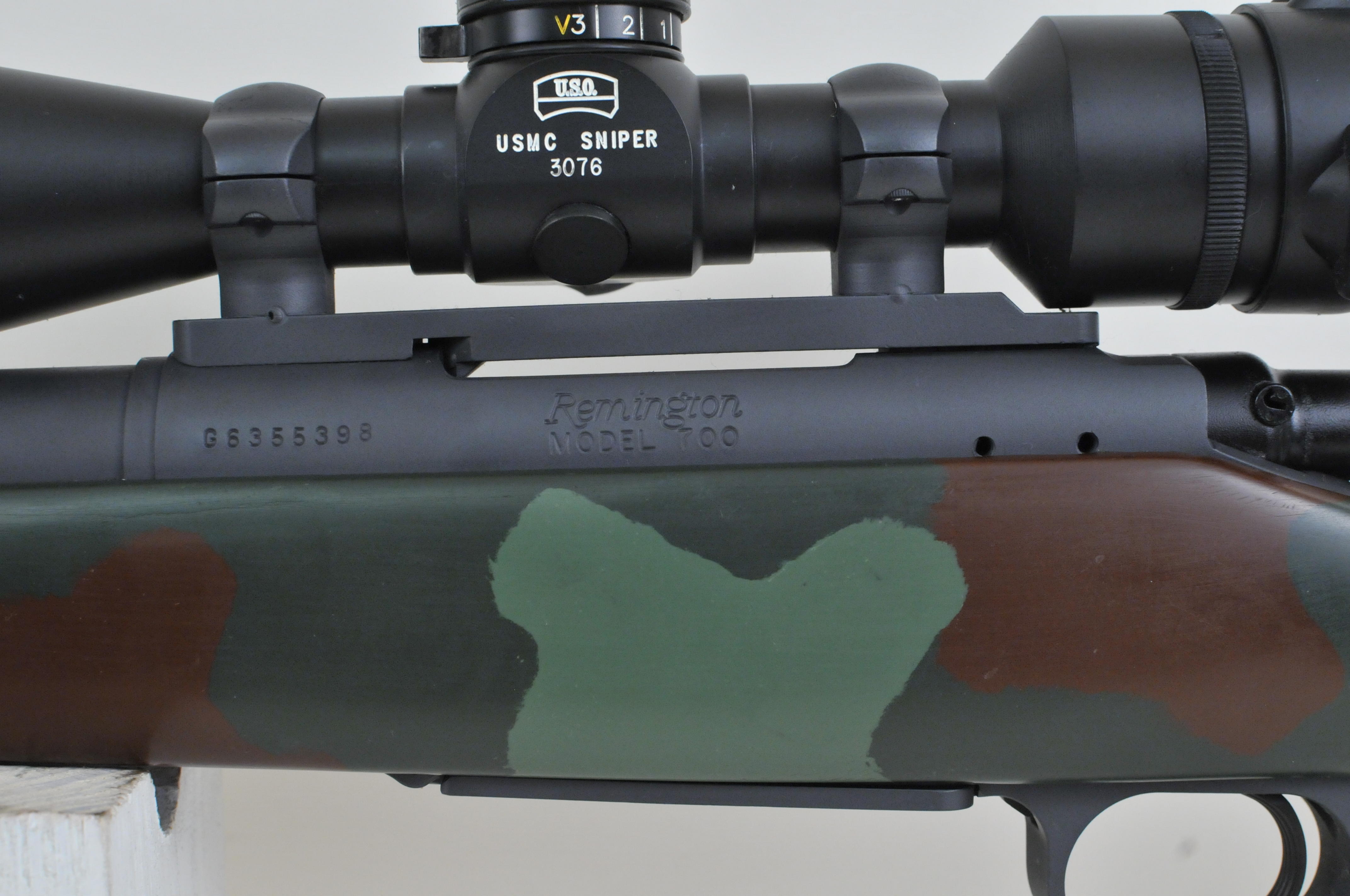

Just wanted to share my rifle with you guys. The rifle was built by an X-Marine armorer. The Unertl scope serial number is only 2 digits off from the one on display at the NRA museum. I have never shot it, but take it out every once and awhile and oil her up!!
Vito
