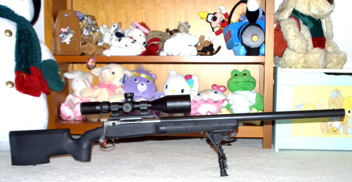

Just cobbled together my 1st Rem700, M24-ish clone, I bedded the action, and base rails w/ JBWeld steel epoxy, added custom action screws for extra threads & strength.
New Parts used:
1. Rem 700 PSS short action, 26” heavy barrel .308Win, 40X trigger system user adjustable.
2. HS Precision stock PST007 w/ adj. LOP & cheek.
3. Millet Tactical TRS1 4x16_50 MilDotBar Illuminated reticule scope.
4. Burris Xtreme 30mm rings
5. Leupold steel 20moa base
6. Weight - 13lbs
Can't wait to break it in...
Hopefully, it will shoot close to as good as my Savage Precision Target I cobbled together awhile back...
