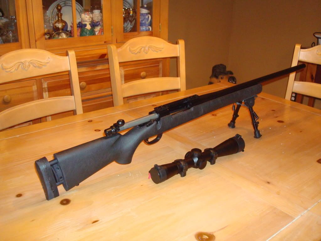

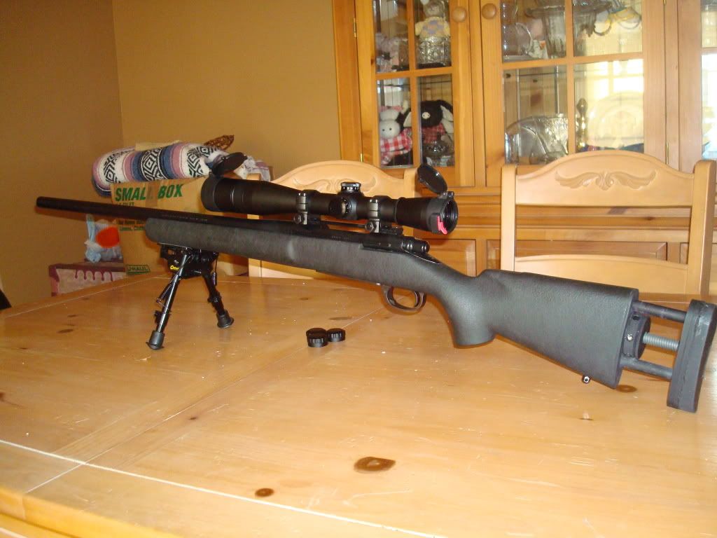

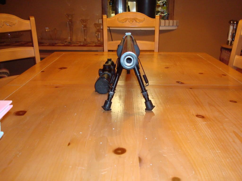

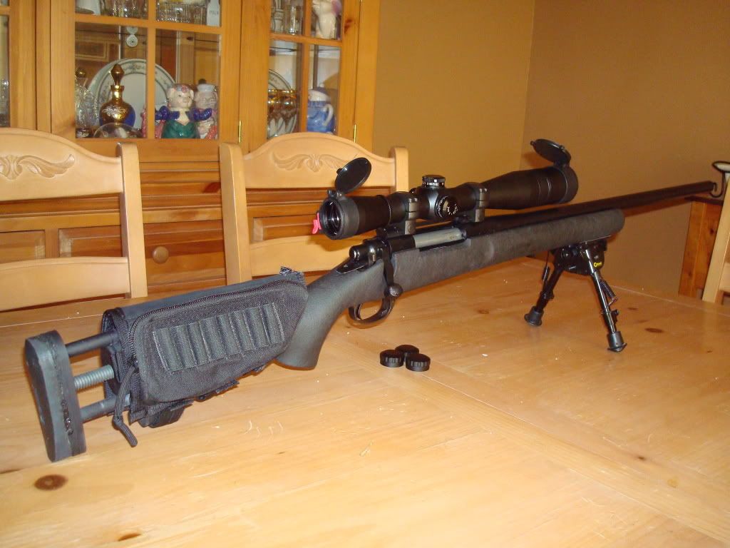

Hi

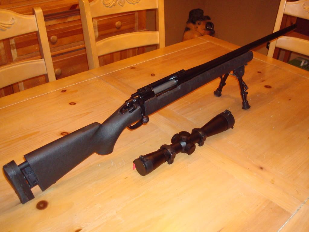

It has been a long year but it is done(for now).
Thanks to everybody on the hide who helped me aquire the parts and gave advice.
Here are the specs and some pics.
-Remington 700 Long action .308 drilled and tapped for redfield iron sight base.
-Hs precision Pst011 Bedded action with devcon and shortend recoil pad left it a little bit longer than spec.
-Rem700 .308 varmint pss barrel cut to 24 with M24 crown until i can get the action trued and squared and a rock M24 barrel.
-Williams Steel triggerguard had dakota but didnt like how thin it was on the bow. I might upgrade to sunny hill later but the williams is top notch.
-Badger ordnance M24 spec one piece base
-Leupold mark 4 low rings Steel
-Leupold Mark 4 M3 m118Lr cap on the way soon.
-40X trigger with adj. screw in the trigger shoe. Flat safey once i used it i couldnt switch it to the new style safty.
Pics
http://i1003.photobucket.com/albums/af160/Curnow_26/DSC04230.jpg
http://i1003.photobucket.com/albums/af160/Curnow_26/DSC04229.jpg
http://i1003.photobucket.com/albums/af160/Curnow_26/DSC04228.jpg
http://i1003.photobucket.com/albums/af160/Curnow_26/DSC04226.jpg
Im planning on getting a roedale brake (clamp on type) to make the extended range times more enjoyable.
Thanks again everybody.

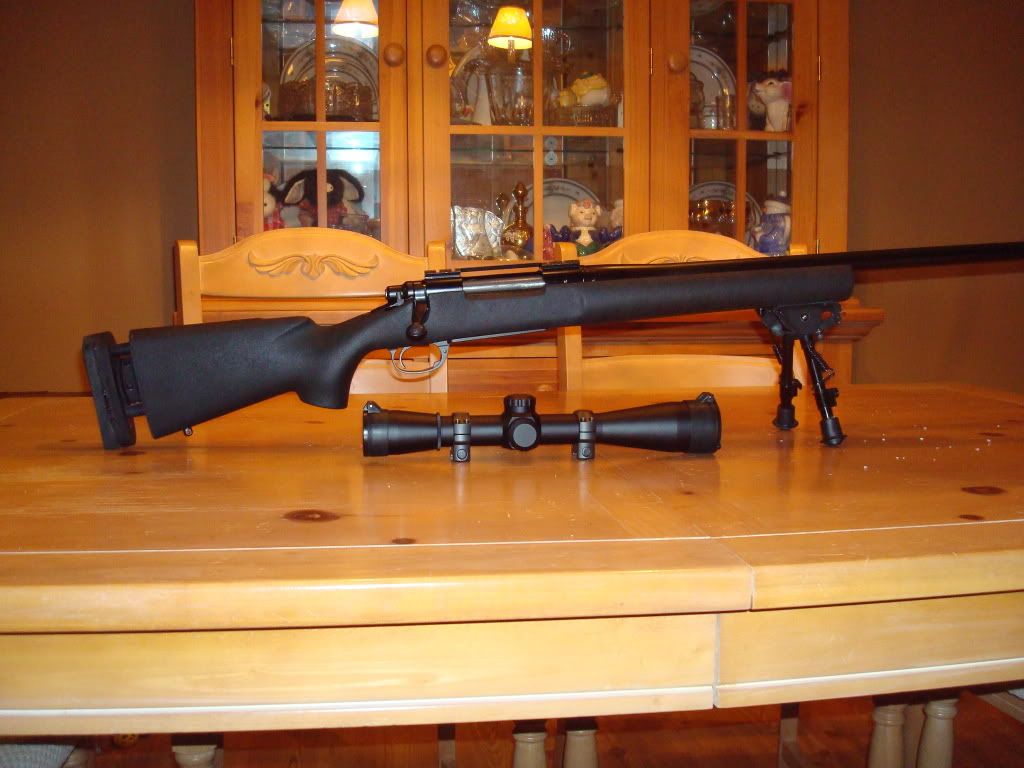

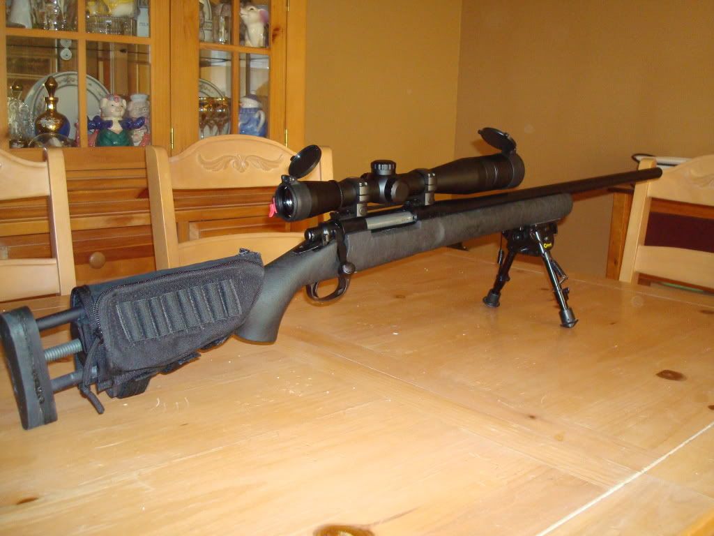

I will post a range report after I make it there. Thanks again every body. I know it does not compare to alot of the high end builds on here, but this has been somthing i have been waiting to do for a few years.
Here are a few more of the 24 ready to go and patiently waiting for me to take it down to the range!
http://i1003.photobucket.com/albums/af160/Curnow_26/DSC04234.jpg
http://i1003.photobucket.com/albums/af160/Curnow_26/DSC04237.jpg
http://i1003.photobucket.com/albums/af160/Curnow_26/DSC04235.jpg
