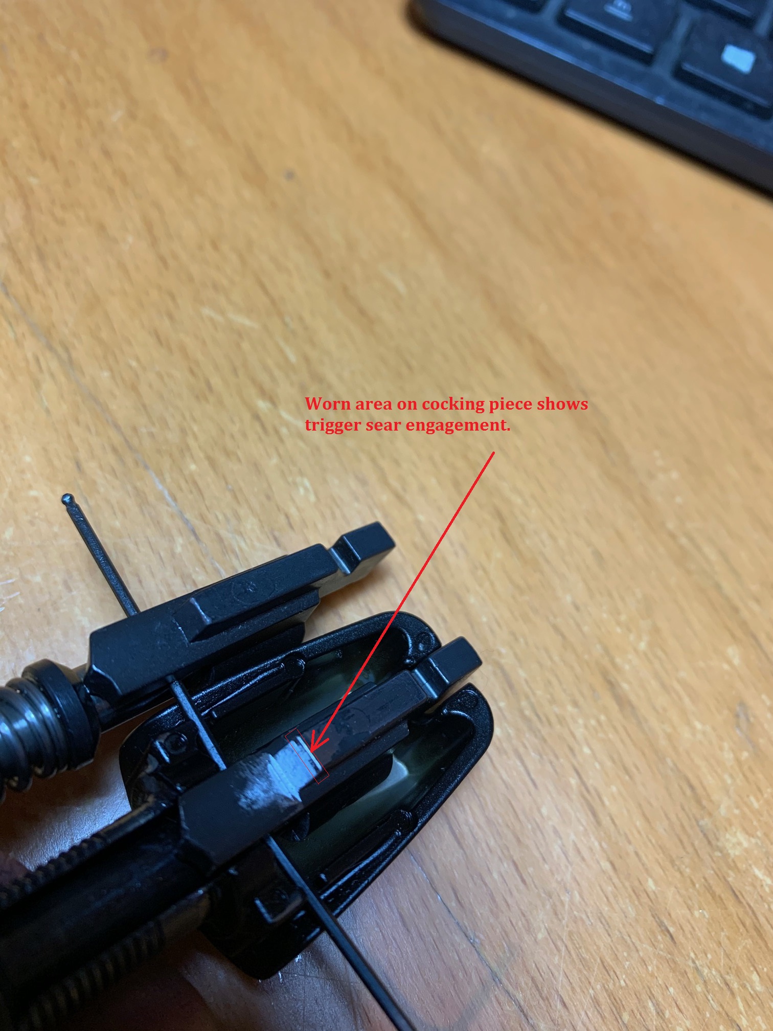

The picture below is the cocking piece from a Bergara B14R rimfire. Since this is a Rem 700 footprint action and takes 700 triggers notice the same angle as shown in OP on your 700 cocking pc.
I modified this via cutting it back to remove .070 cock on close, but I maintained the factory angle. You can see the dark wear mark on the shinny machined spot. This shows how much engagement I have with the Huber 700 trigger sear.
