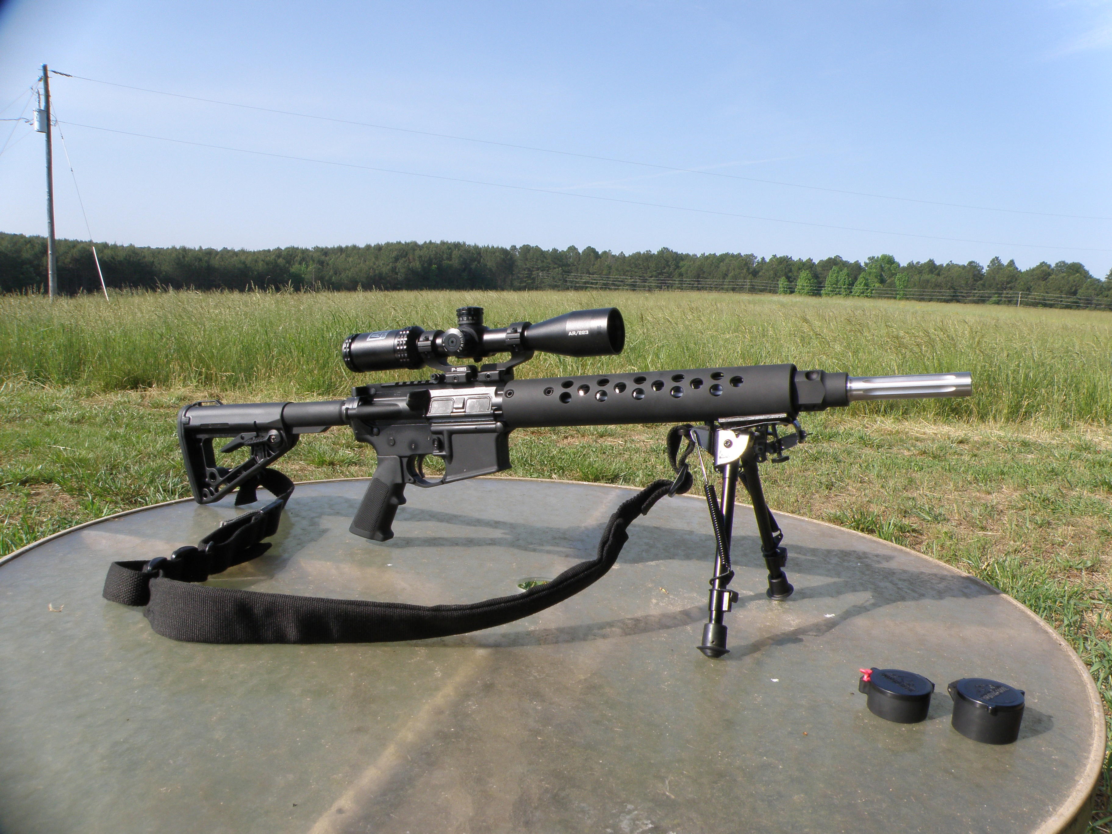

I paid 1149 + 230 for SSA-E then 732 for a WOA 18" varmint upper with 1 in 7" twist and had it fluted. Then I sold the Colt upper for 500. Final cost is $1511 not counting scope, mounts, bipod and sling. Scope is a Bushnell 4.5-18x40mm which I got on sale for 174. It tracks as accurate and repeatable as my Vortex 6-24 PST FFP MOA scope.
