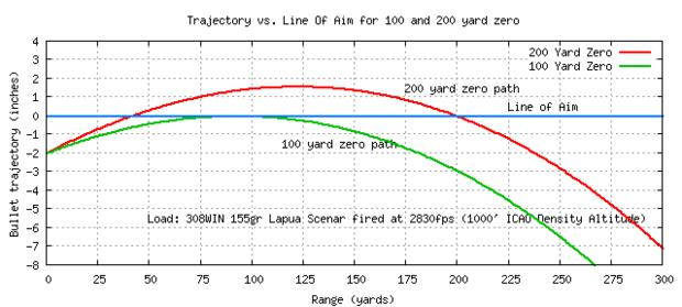

This is turning into a spitting hairs argument. MOST bullet paths will indeed intersect the line of sight twice. However some paths will rise on their arc from the bore axis only to touch the line of sight without going above it. The picture I posted earlier from Demigod's article is one example. The 100yd zero only touches the line of sight once at the 100yd zero distance. The 200yd zero is on the downward arc intersecting the line of sight twice. I think most of us have answered the OPs original question and I am not interested in getting super analitical. Safe shooting everyone, I'm out.
Well, I agree it is splitting hairs but it was you that asked me to explain.
