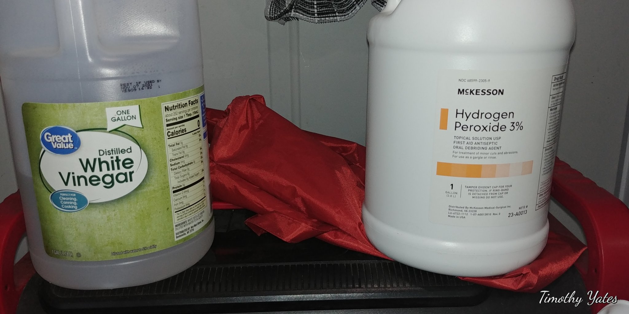

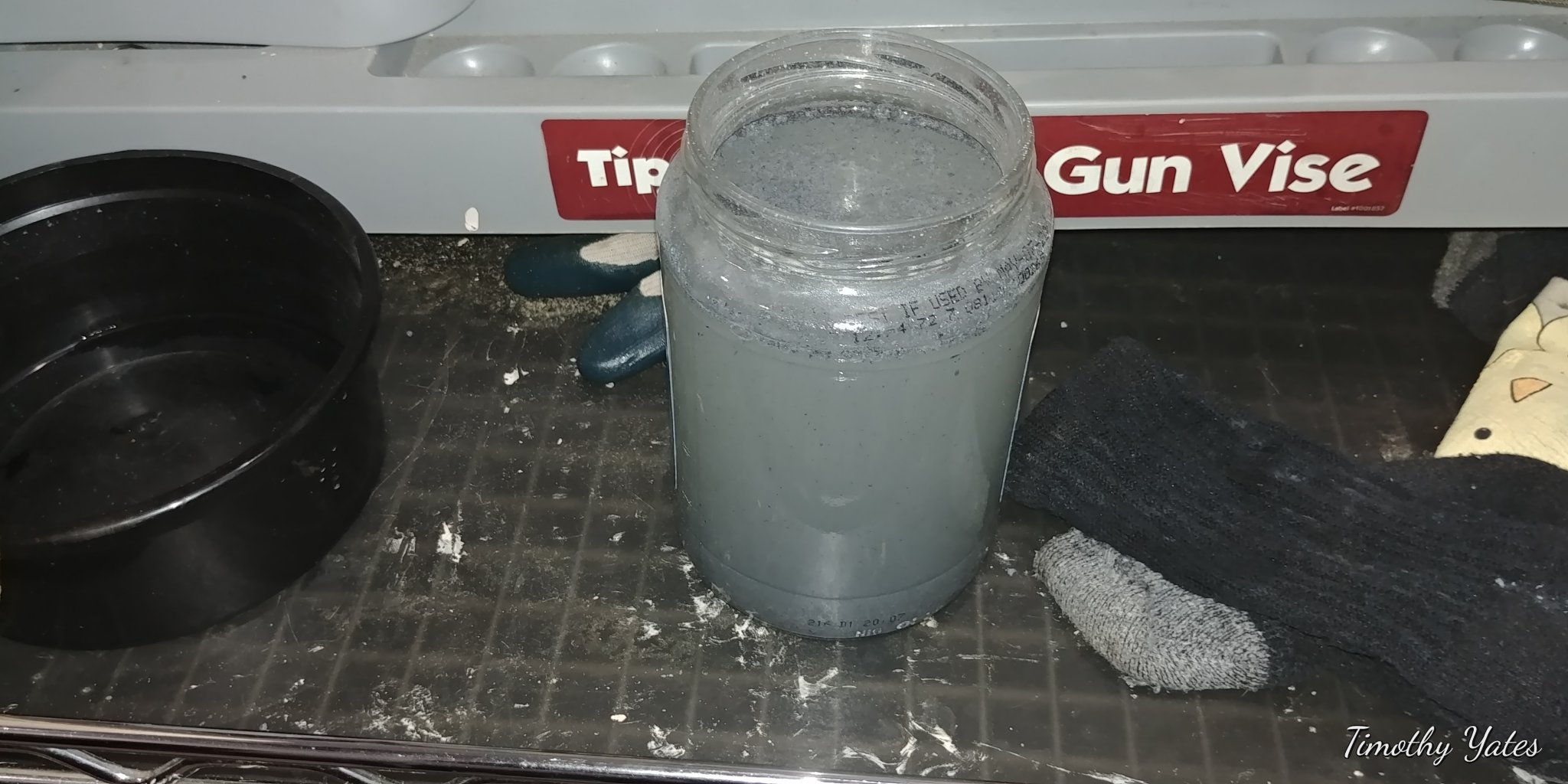

I use the DIP all the time. Be smart, careful and wear rubber gloves. Use your head and it's no big deal. I have never had an accident/spill.
View attachment 7502193View attachment 7502194
How long are you letting the mixture in the can?

I let mine sit overnight, I'm never in a hurry to get it done.
I rinse it off with plain tap water in my 1/2 bath sink.
I pour the mix in an old stainless steel cooking pan and let the sun evaporate it.
When I said I "use it all the time" what I mean is it's the only method I use. I did not mean I use it once a month or "frequently" in fact I probably clean the suppressor 3 - 4 times a year.
The photo shows a pickle jar being used, I now use a slim olive jar that's probably half the size in volume of the pickle jar.
