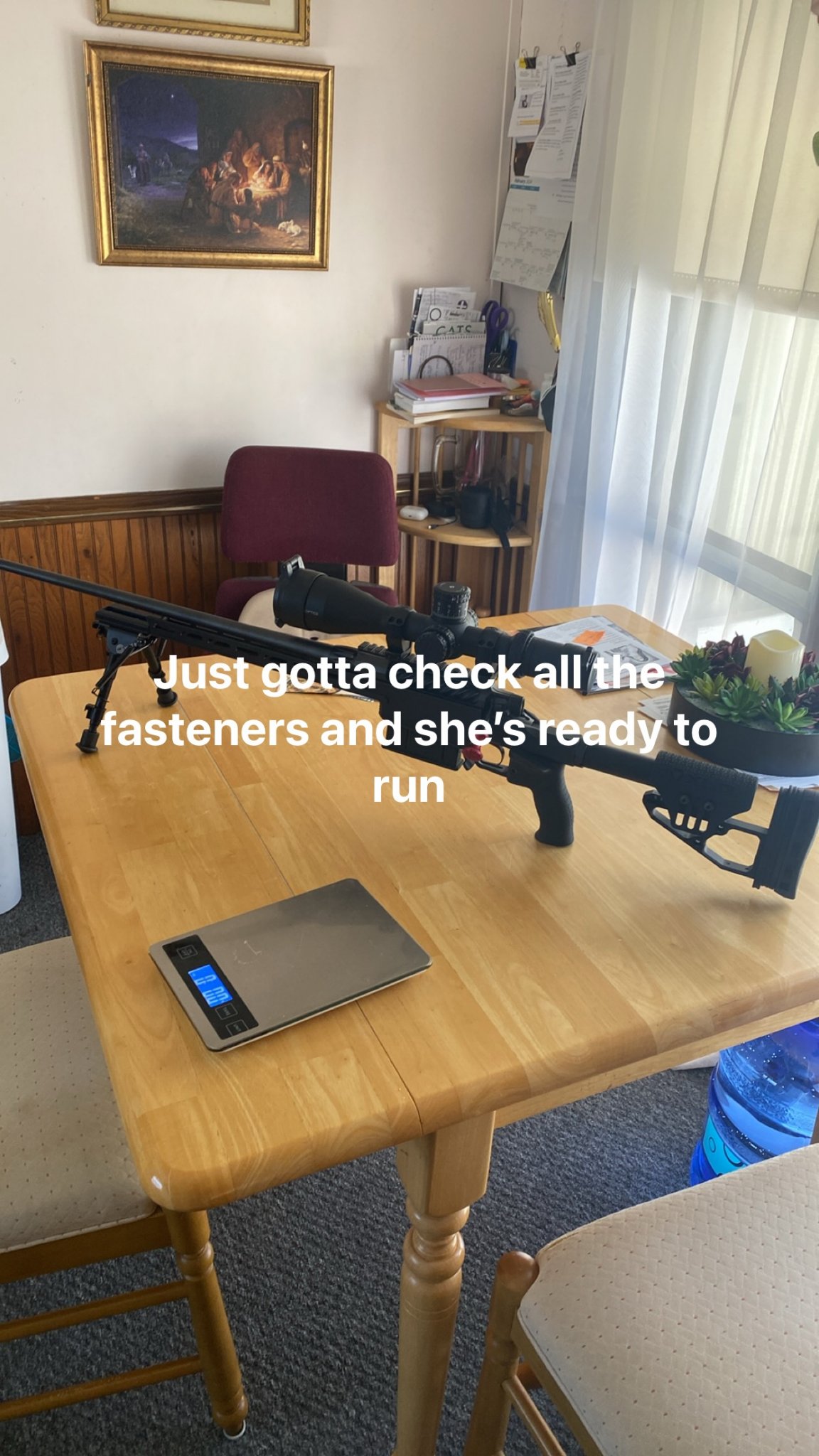

Finally got it all together after solving some manufacturing issues with the chassis. As a LA 223Rem it runs better than I thought it would, but you definitely have to put some intention into closing the bolt.
All in all it’s pretty much everything I want, and the couple changes I have thought of are certainly possible.

View attachment 8354063Finally got it all together after solving some manufacturing issues with the chassis. As a LA 223Rem it runs better than I thought it would, but you definitely have to put some intention into closing the bolt.
Long Action? Interesting.
Reactions: The D
Yes, switch barrel rig is what I’m building with it. Started with a couple take off Savage barrels (22” 223 that’s on it currently, and a 24” LRH 300WM) because I got them cheap, but I’m gonna go shouldered Prefit from now on. 223-37XC on the same platform… sounds damn good to me!
The 223 ammo I tested feeding with was just some Remington PSP factory fodder so not like I tailored a long hand load to the chamber either… the soft lead tips were a little flattened after repeated chambering but I think that had more to do with the couple hang ups running it slow and lazy than normal chambering
Yeah I bet if you started loading some 80+gr at > 2.500” it’ll feed much better.
Buddy of mine did the same thing. 6 BR via AICS long action sled switch barrel to 300 PRC on a Archmedes LA in a Xylo chassis.
Yeah it definitely should, 80gr ELD should be a pretty good match with this.

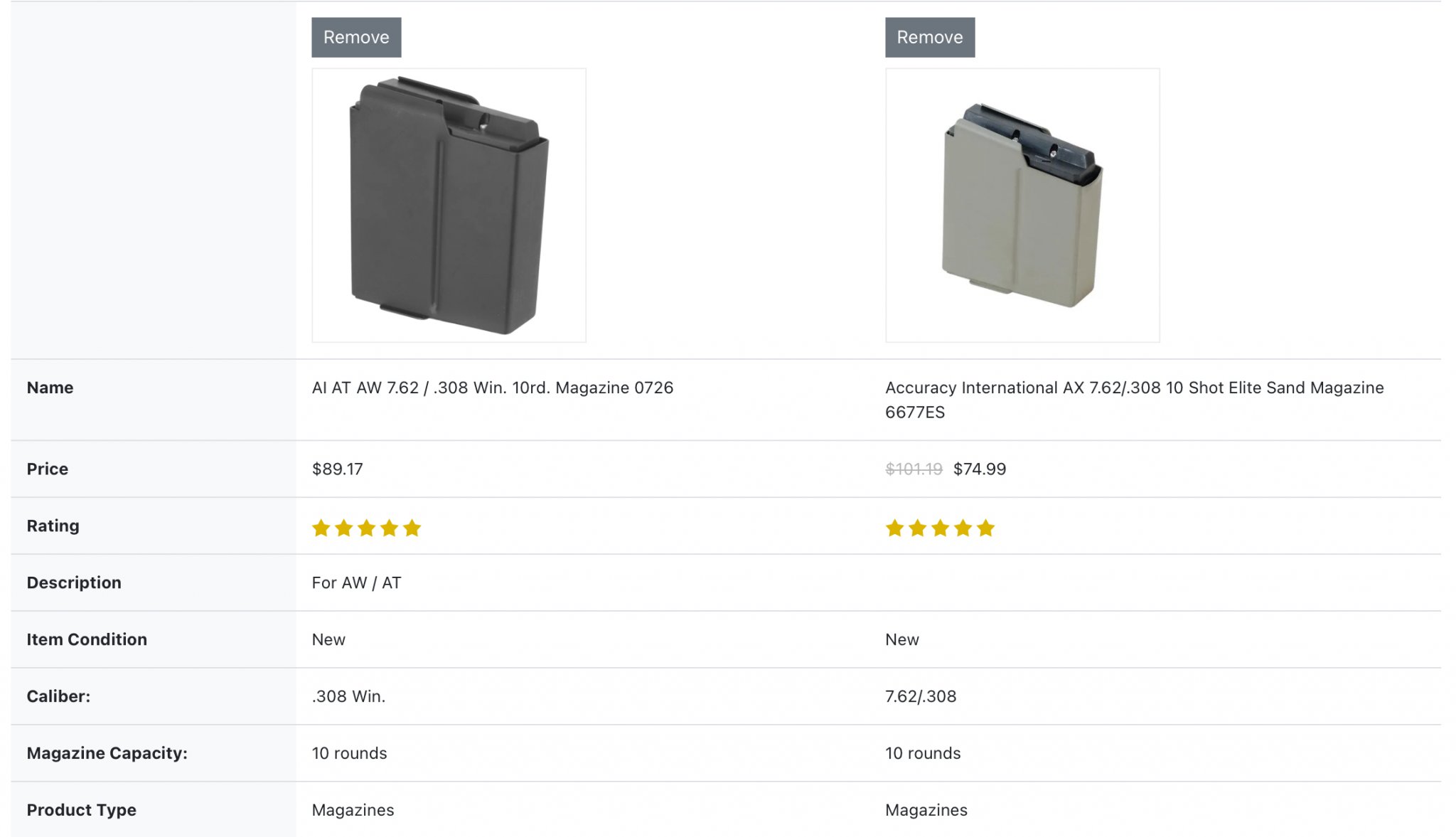

Just pay the premium for AX mags if you get desperate? Better than running single shot, and they’re in stock all over.
Forgive my ignorance, how do they differ from AW ?
(I am thankfully outa the woods on the single shot contingency )
They’ve got a little lip on the front that you just hammer flat and voila - instant expensive AW magazine!
