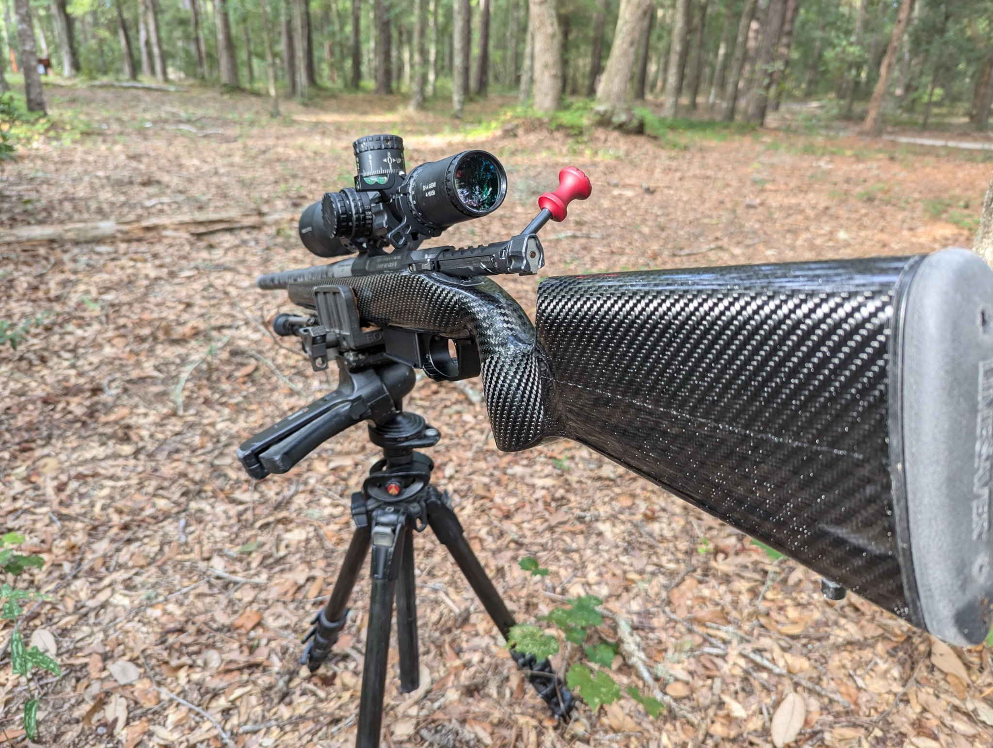

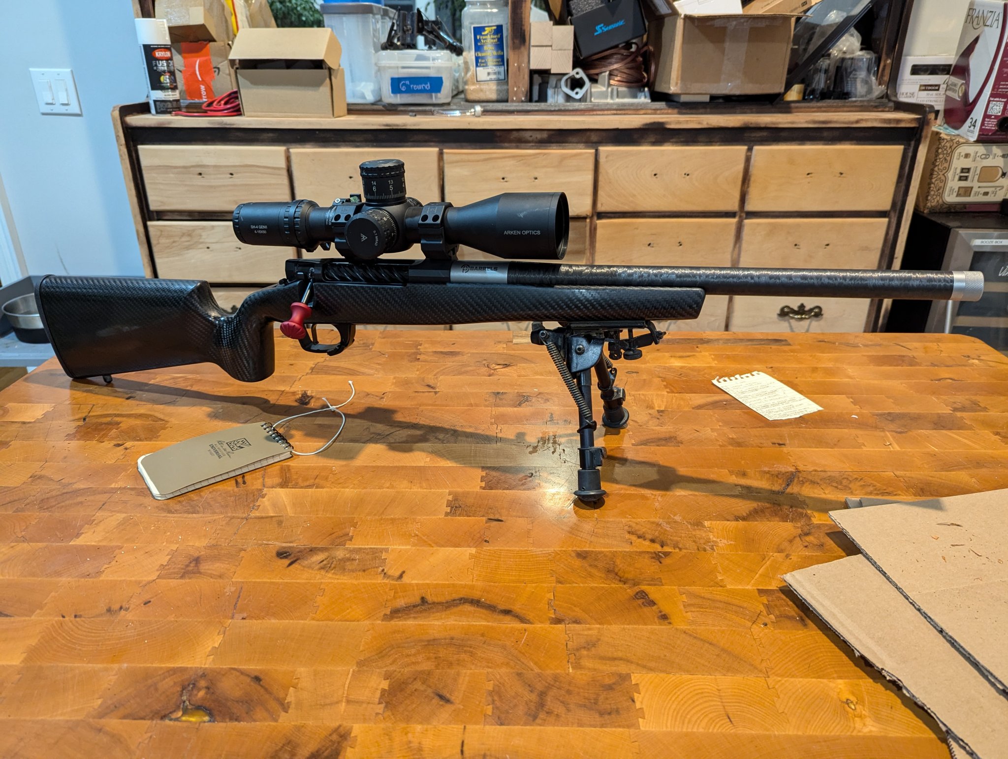

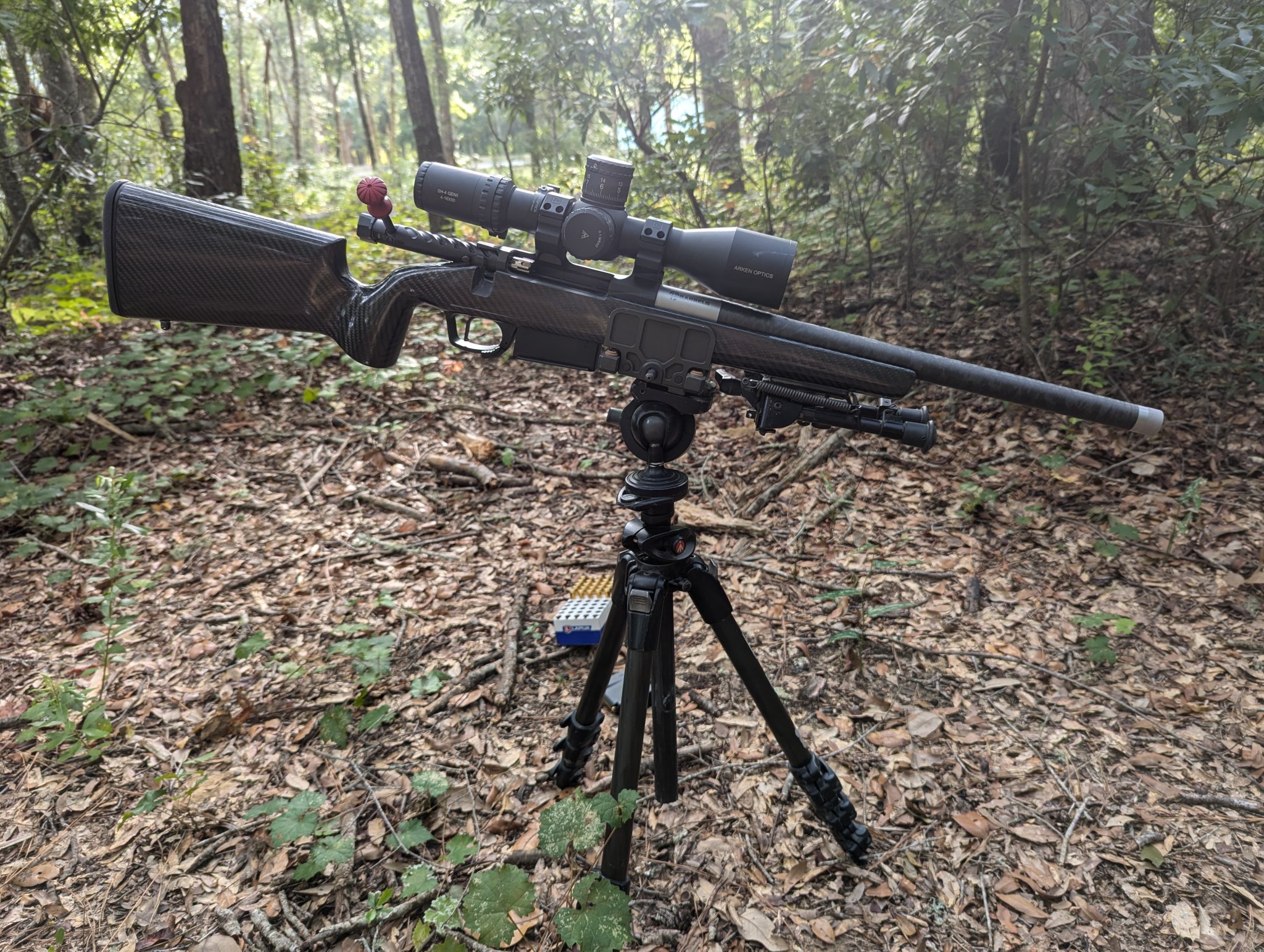

It's been a minute, I got the action and barrel in, I was wanting to hold off until I complete it. Bedding and probably an optic change as the scope I had on the shelf kind of ruins the whole thing. (Weight).
CDG LW
Bartin 18" 223 AI barrel
Stocky Hunter VG (modified slightly)
Trigger tech 2 stage
Atlas bottom metal (doesn't perfectly fit the stocky inlet, have to modify)
AM 00100-0037
As of right now arken SH4.
This adventure has also lead me to mess around in cad for a AW style mag for 233 since there's an off the shelf action in the US. Is there anyone else who would at least like to see what one would look like?

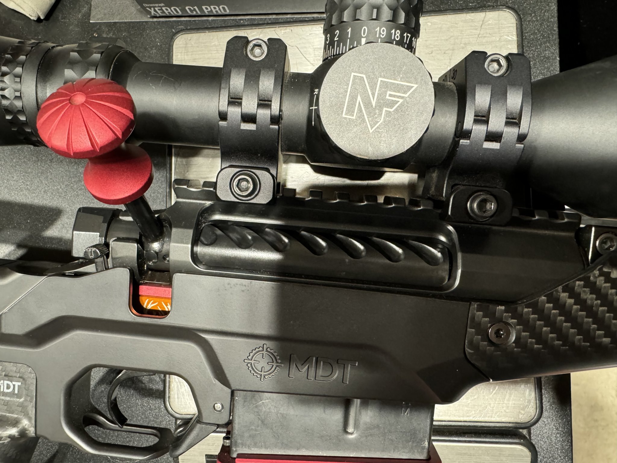

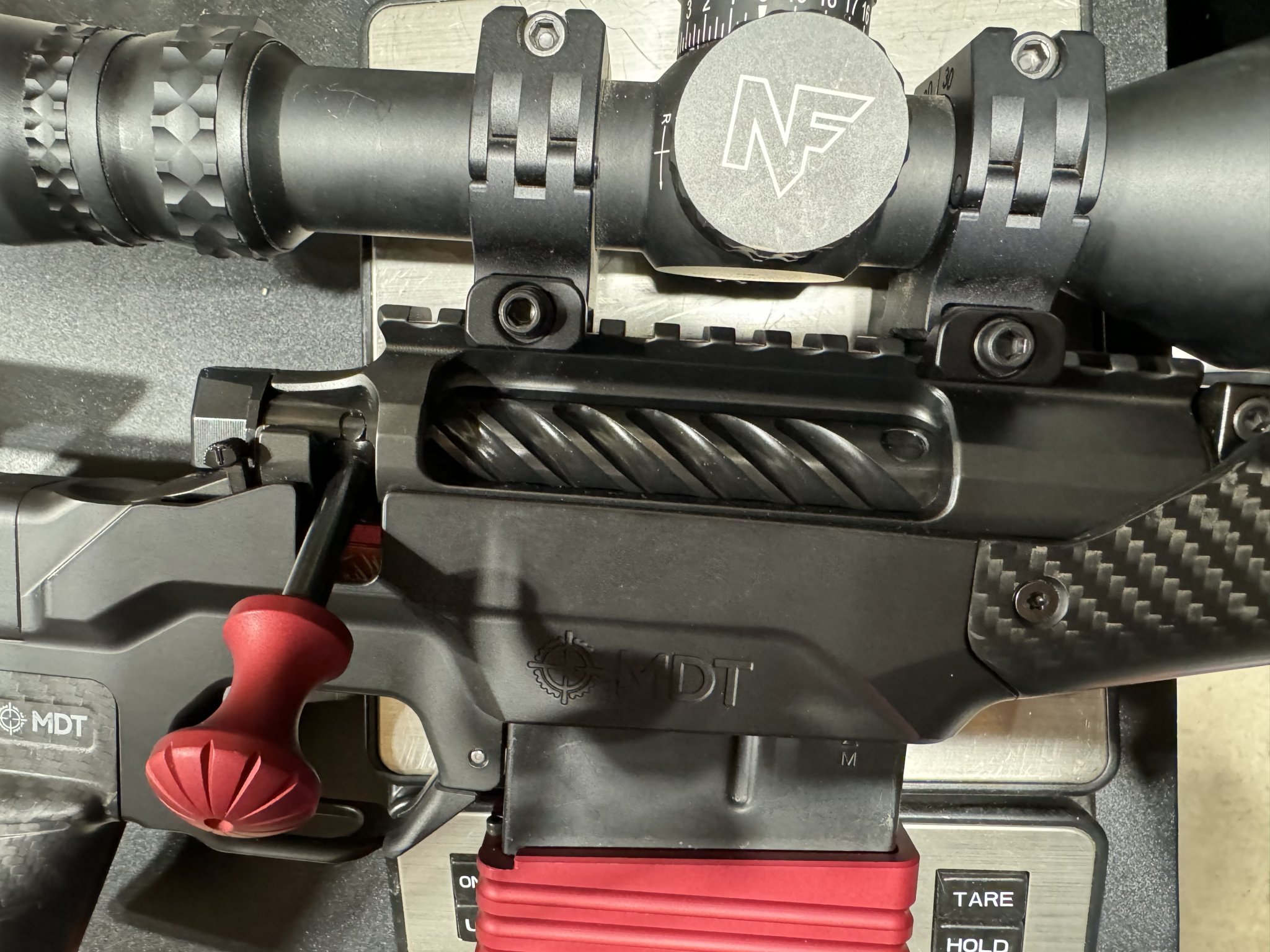

I'm a bit confused by this CDG action picture as it doesn't look like the current bolt fluting. Has it changed over time?
Looks right to me. If you close the bolt you will see all the fluting area shown. The bottom of the bolt is smooth so that it slides over the cartridge case smoothly.
Okay...I must just be looking at it wrong. Hopefully I'll know in a week or so.
I'd have rather had a smooth bolt but you get what you get when you miss the direct order option before the price increase and have to go elsewhere.
I think you will like the fluting. It looks good without being loud and in your face. The bolt works very smoothly using the AW mags.
In the picture the bolt is raised which rotates the fluting to the inside of the action.
The fluting is purely for aesthetics with the bolt closed, the rest of the bolt is smooth.

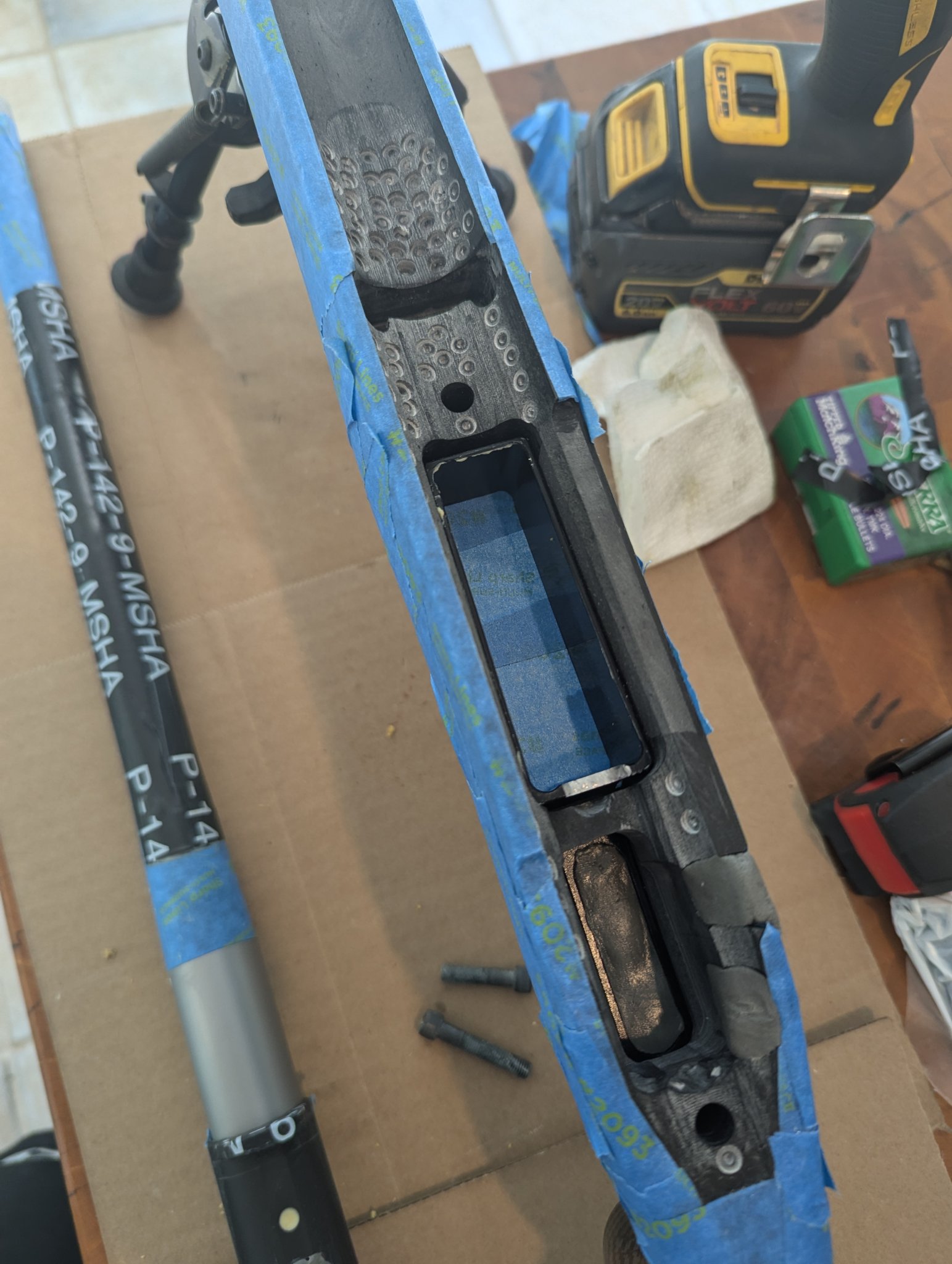

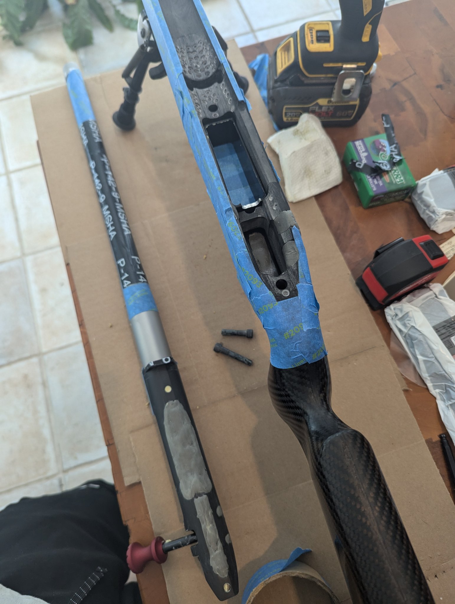

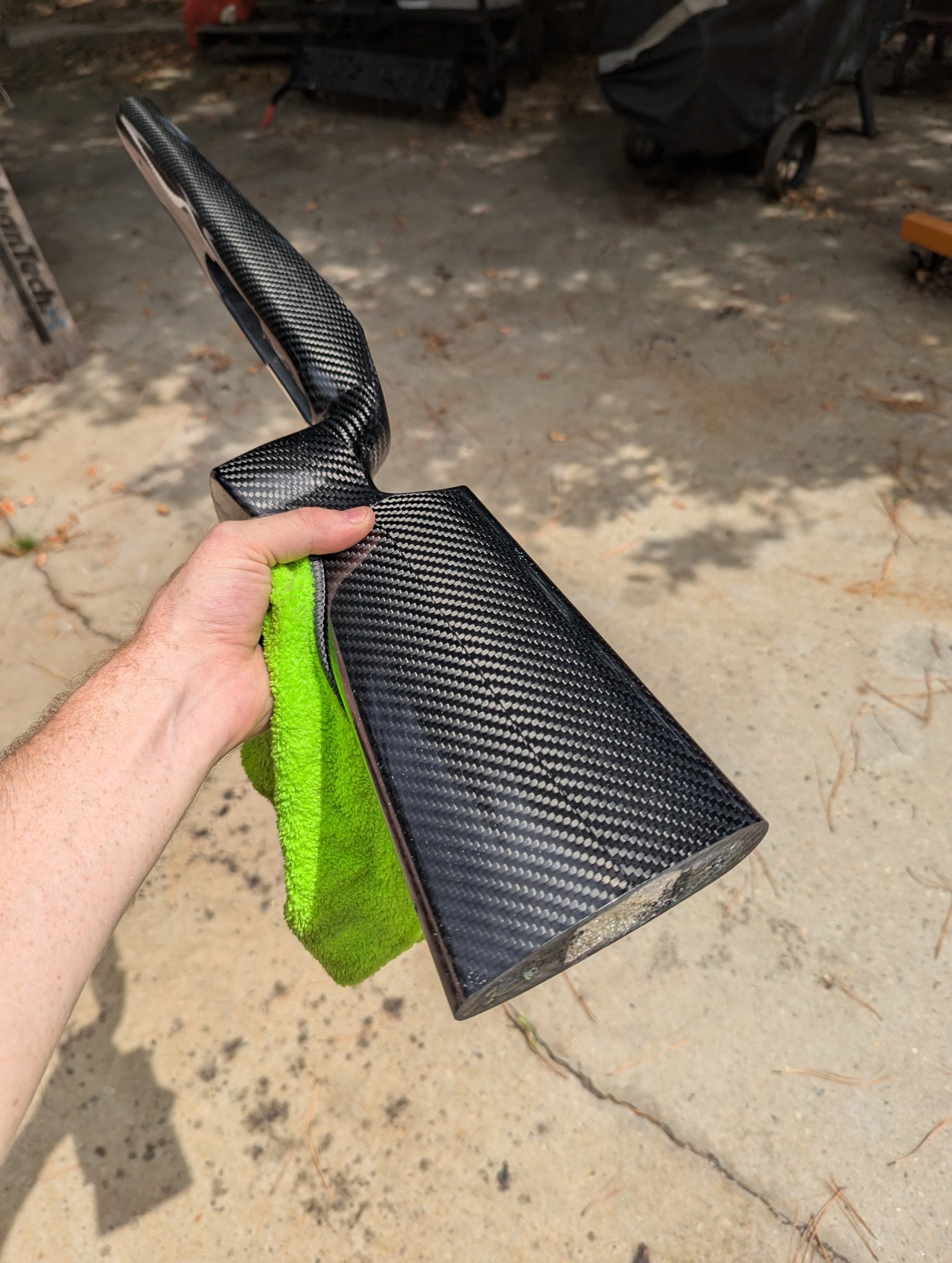

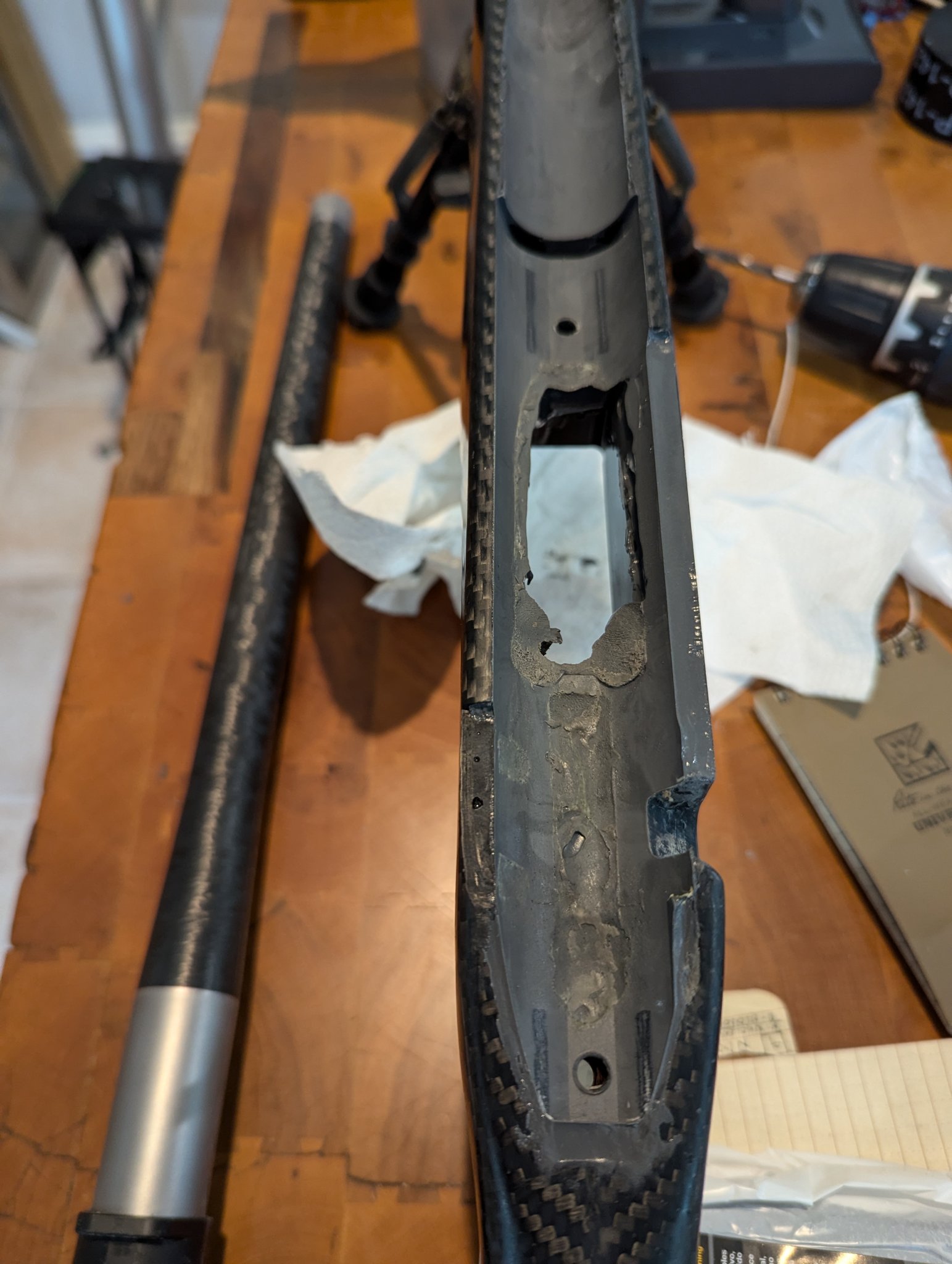

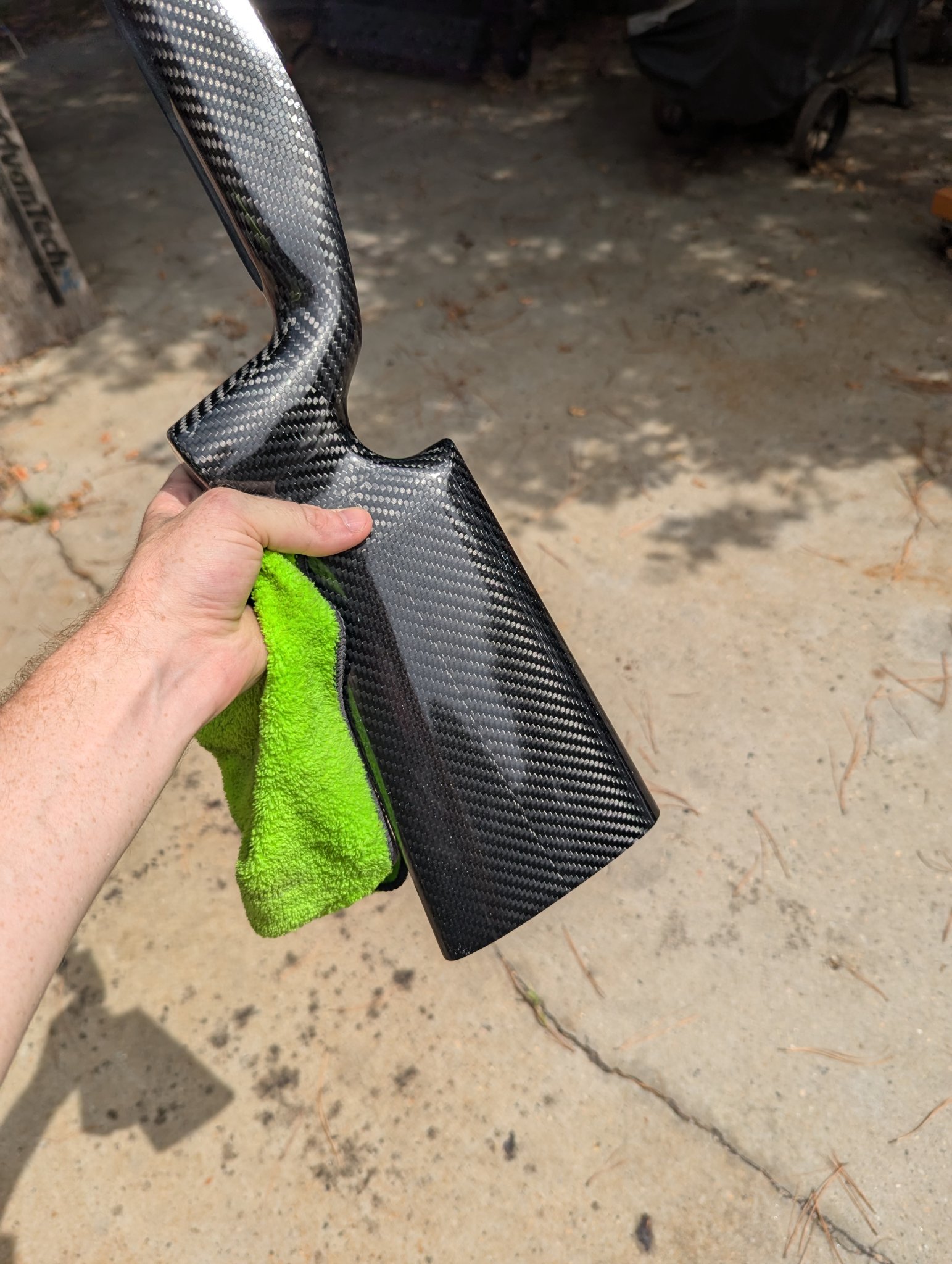

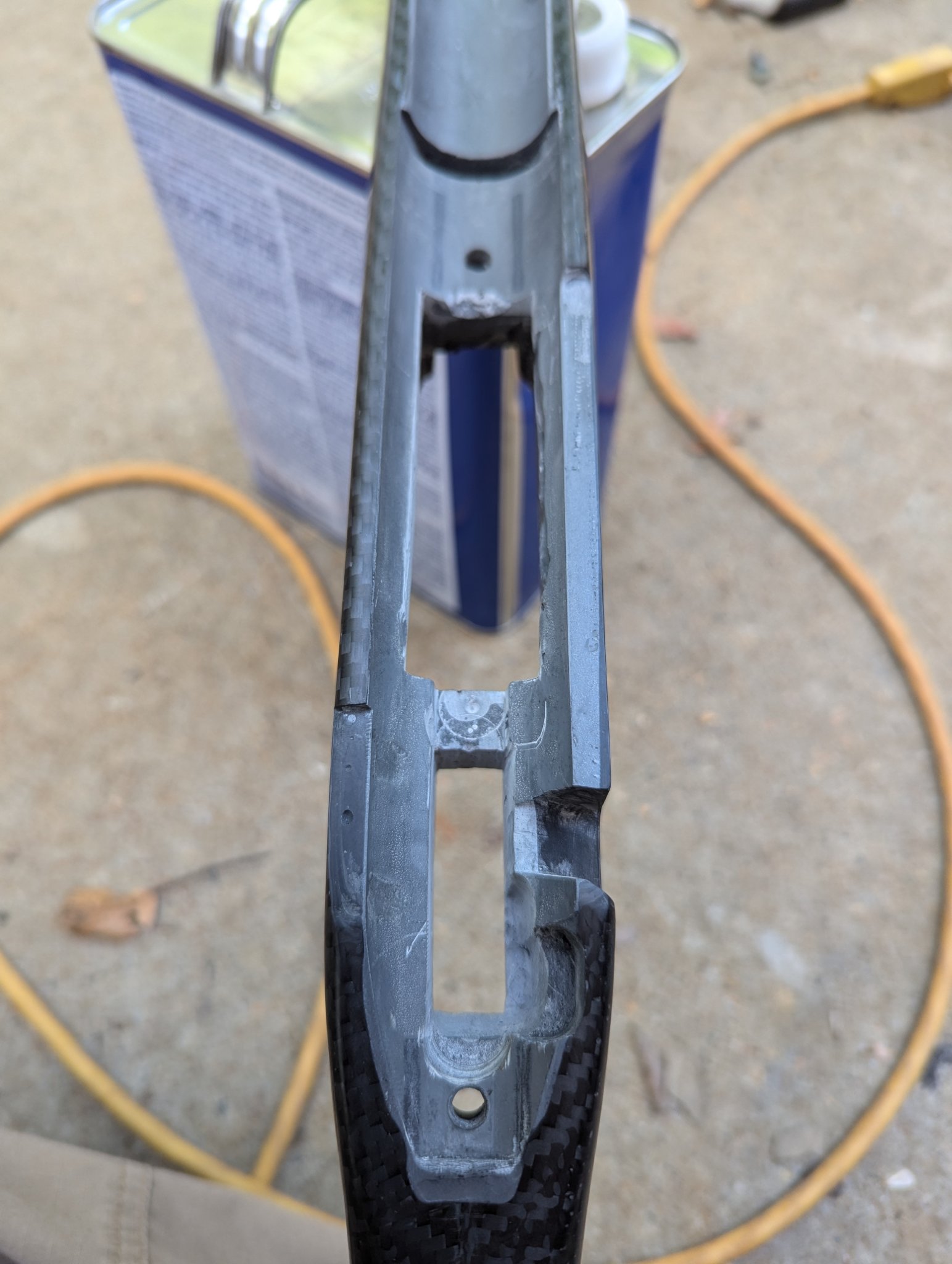

I finished the bedding on the stock. I'm not sure what stocky uses an epoxy/resin for their stocks. But it buffs out super easily.
The reason I ended up buffing it was there is extra epoxy/resin clumps on the stock so I took 1000grit to remove most of then followed up with 2000grit. Once the excess was removed I blended everything with cutting compound then polish.

I went to fireform the brass tonight since everything is finished. All I can say is I'm excited to do a ladder load she's gonna shoot.
