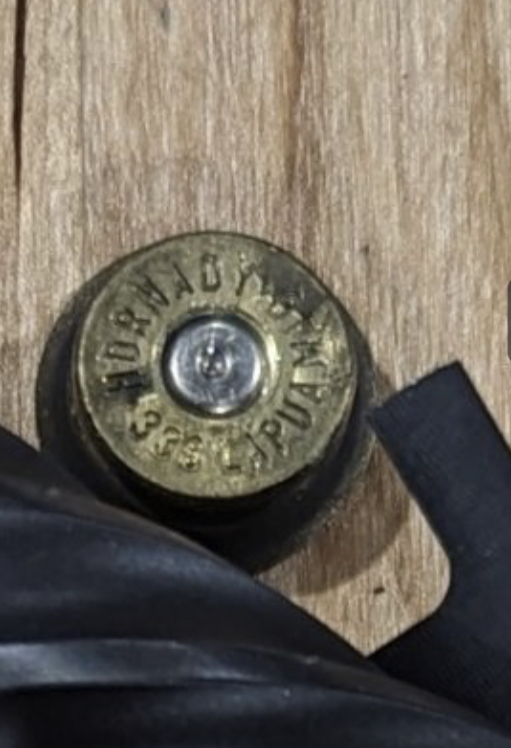

That cases was intentionally cut to ensure that the case would not contain pressure. Our aim was to pressurize the receiver in order to see if it would blow apart. We're testing the mechanical properties of the receiver during these tests, its metallurgy essentially.

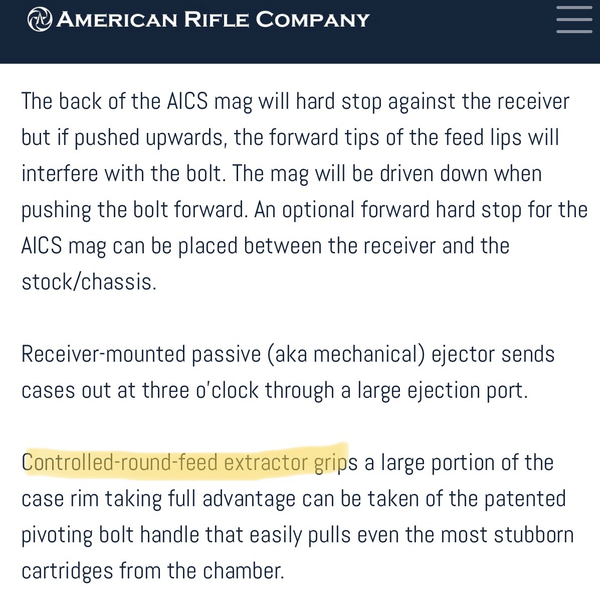

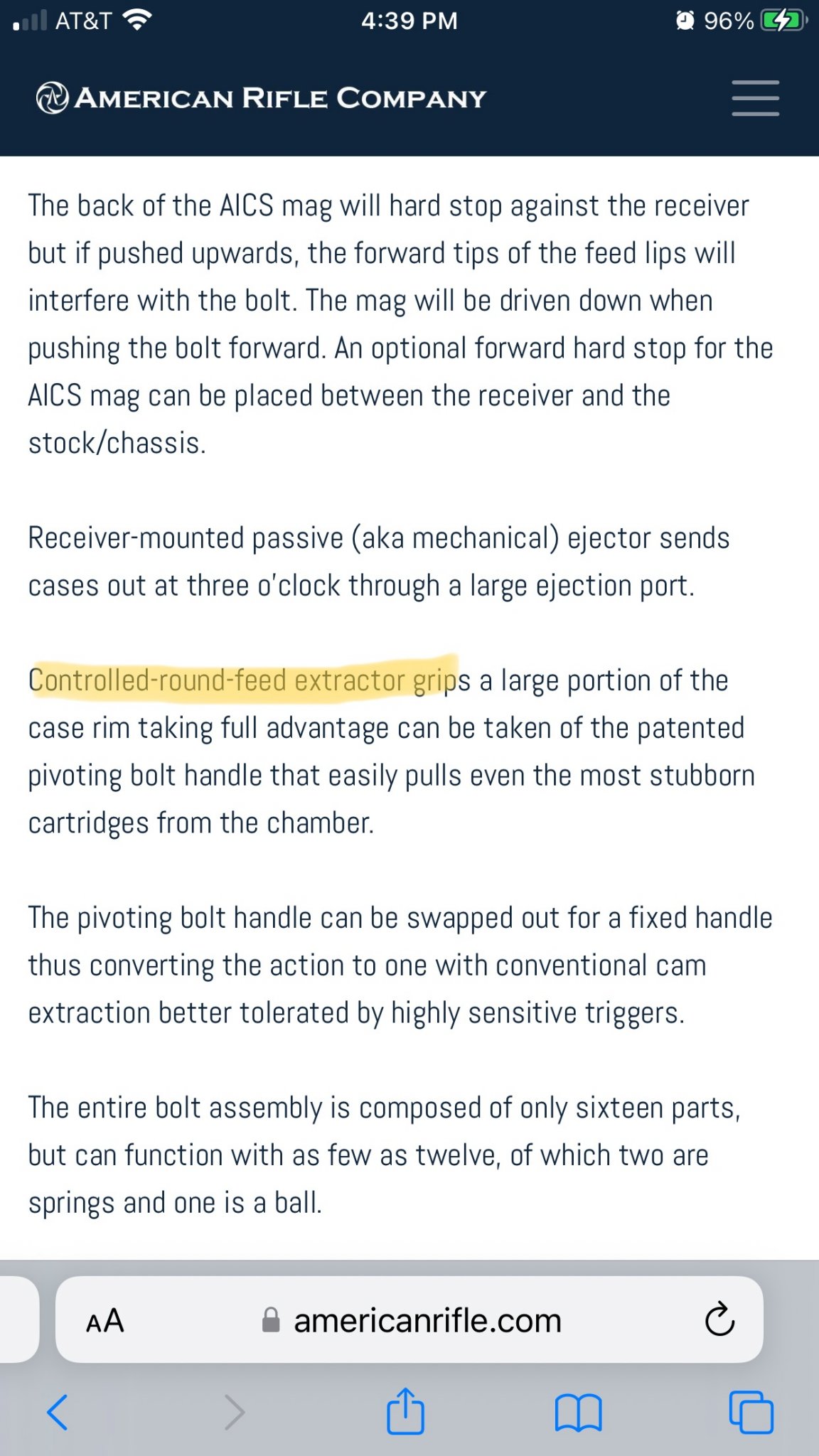

Alright fellas, point and laugh if you must, I'm likely earning with this:
Do you still get CRF w AW mags? I can't picture how that would work.
I was wondering same thing.. Read the description again, and sure enough there it was:
Maybe an industry first(?)

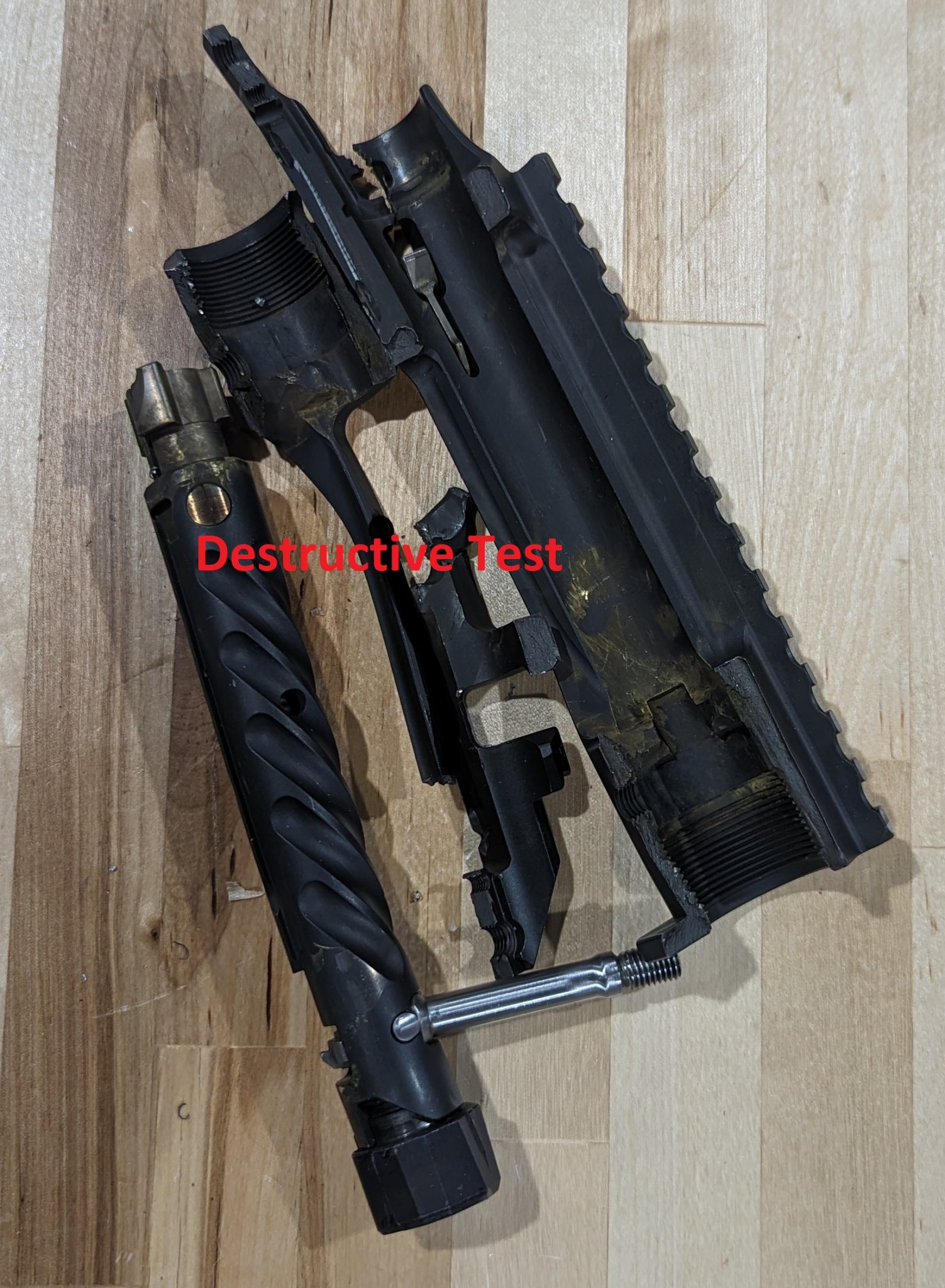

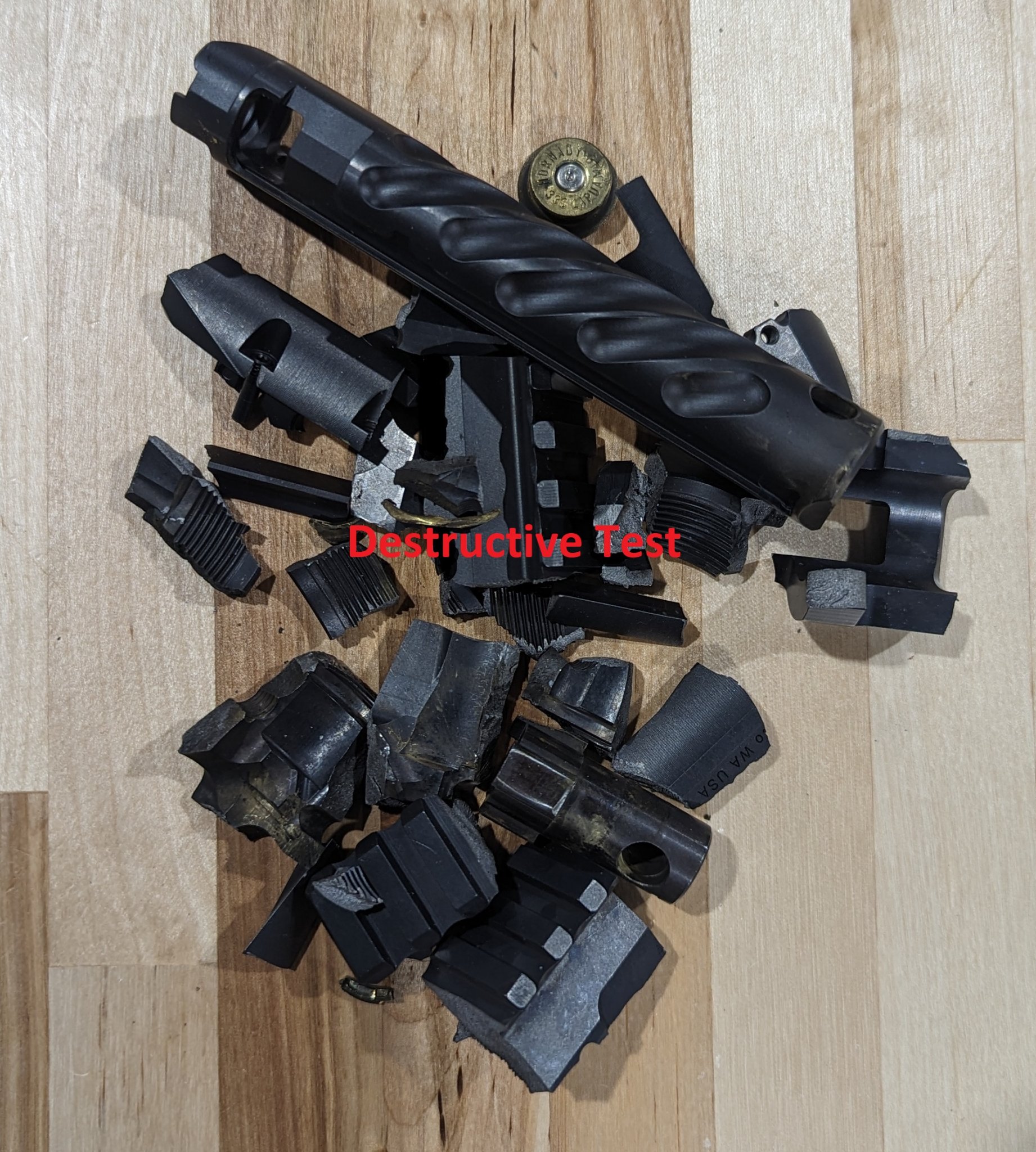

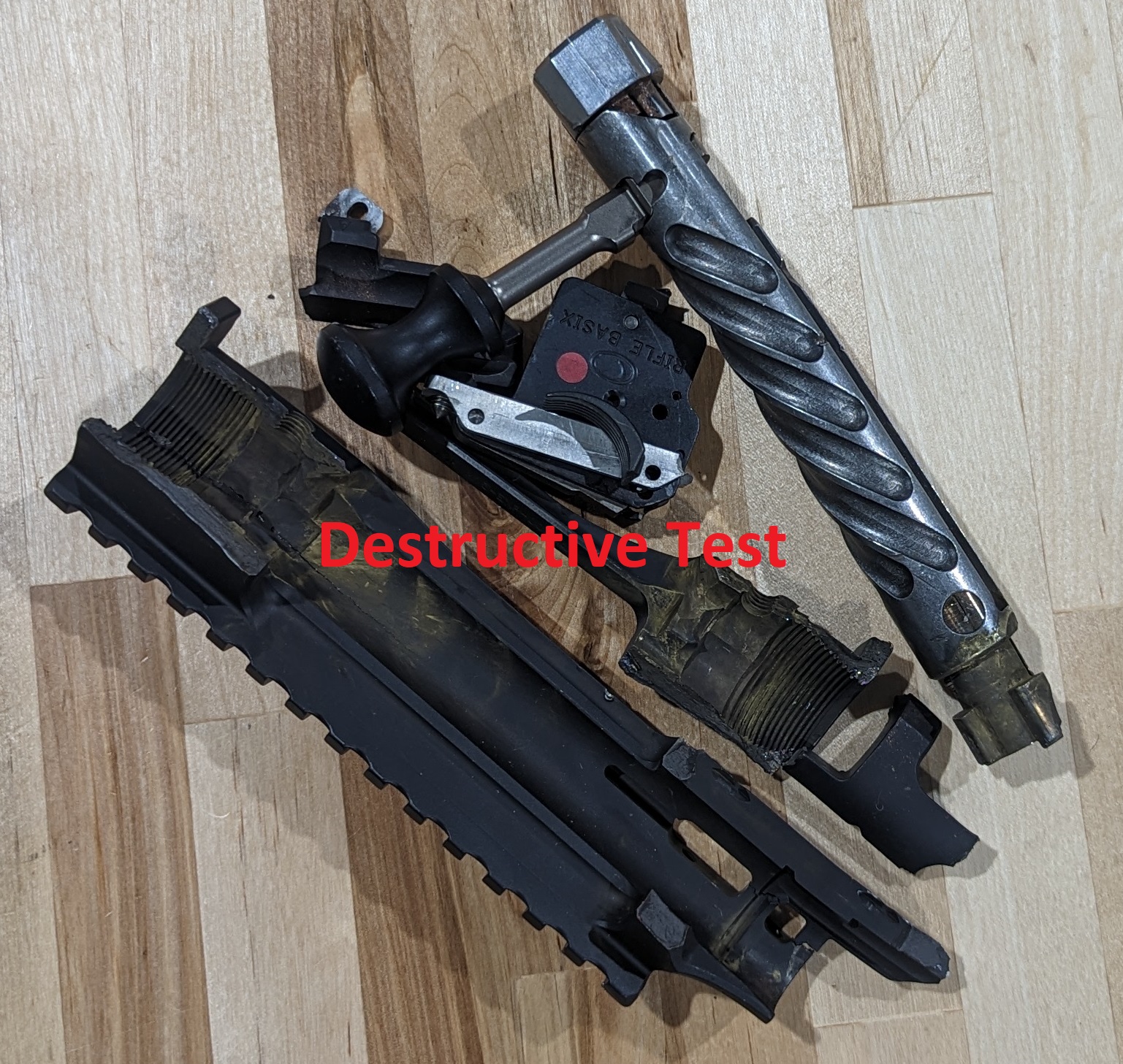

Over the years, many people have asked us for this. I've been reluctant to do it because I don't want my customers blowing their faces off in the event that they drank to much whisky while handloading and carelessly dumped a bunch of Varget into a 300 WM or 338 LM.
We blow actions up during obstructed chamber tests to ensure they stay together after people make mistakes. The ensuing blasts are terrifying and if your head is in close proximity to fragmenting receiver, well it's like the YouTube video says, "It was at this moment that Jackson knew, he fucked up!"
Thus left-port right-handle worries me. I'd need to talk this over with a good attorney before offering such a thing for sale. Same goes for aluminum receivers and switch-barrels with split receivers, with the notable exception of Accuracy International. Those guys smartly do obstructed chamber tests. Aluminum receivers are obviously used in millions of AR-15s but the majority of those guns shoot a tiny 223. Bolt actions are different. They're often used with big cartridges that release enormous amounts energy.
I normally don't do this but I decided to attached three pictures of actions blown apart while testing materials, heat treatment, and finishing. Take this seriously. Handloading mistakes can result in serious injury or death to you and to bystanders. We work hard to make these as safe as possible and to safeguard against carless errors made by shooters but there are limits to what we can do.
Enjoy the pics and be careful. Don't be like Jackson.

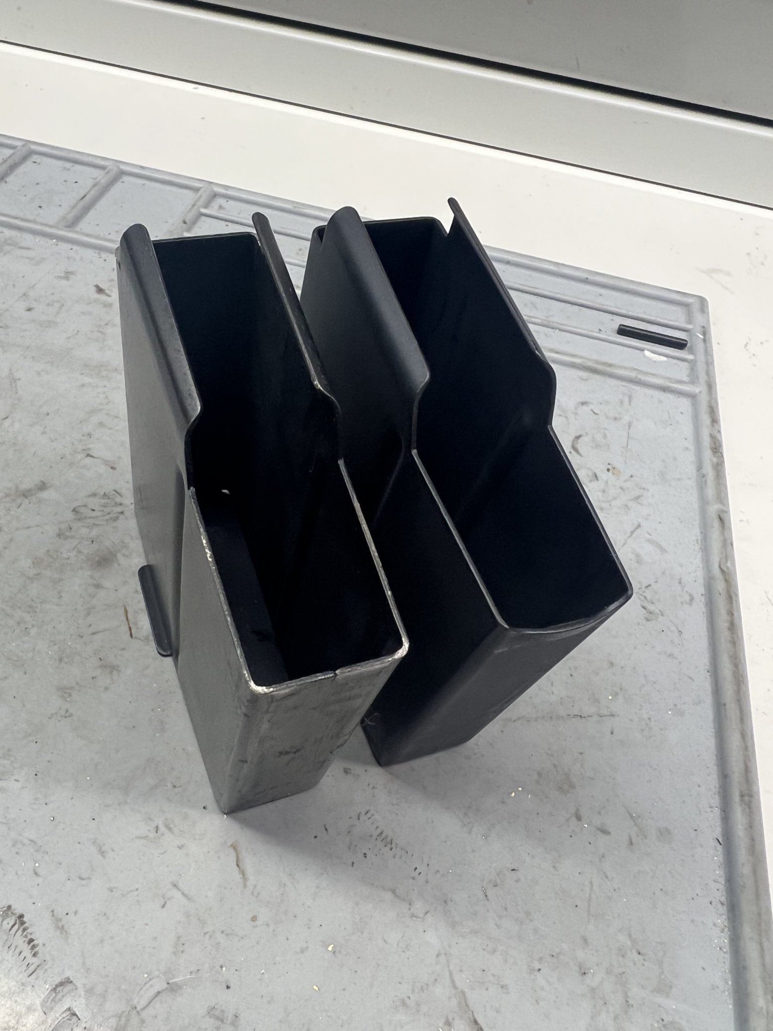

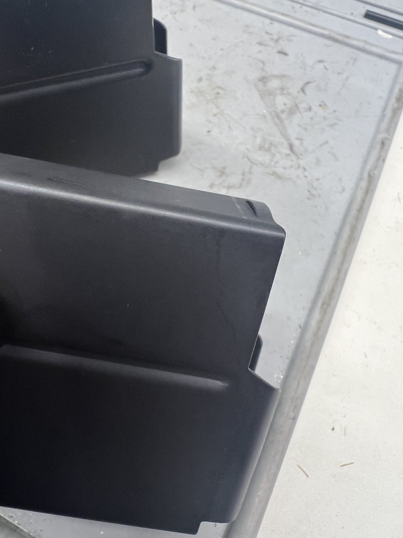

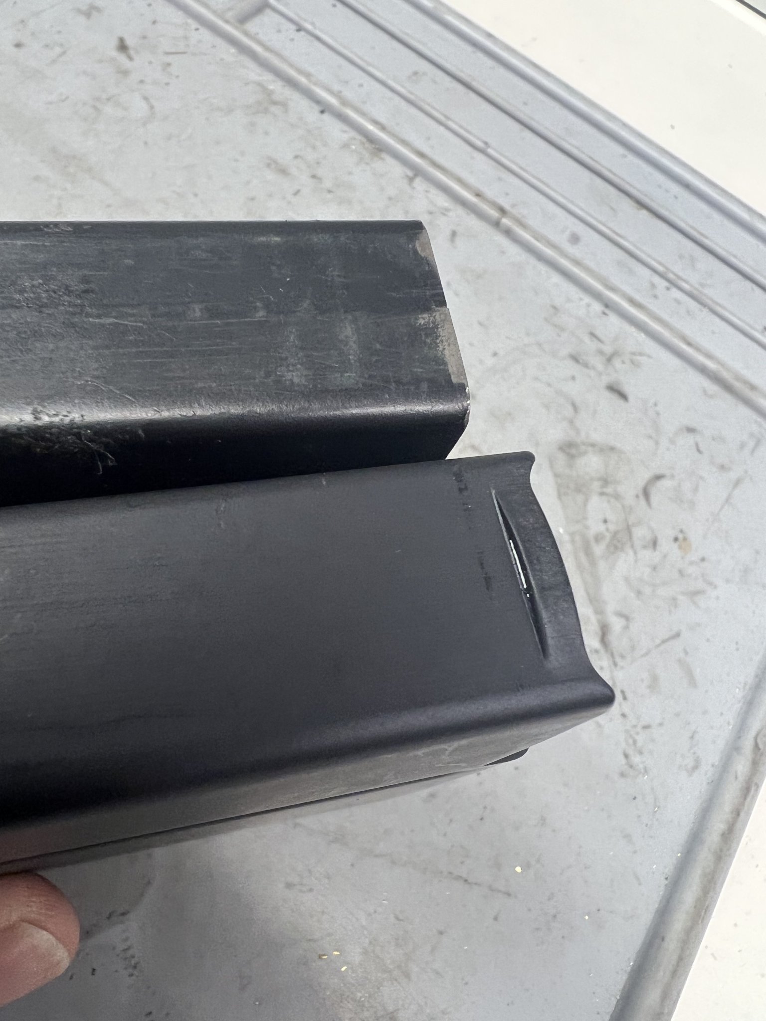

@karagias Does the CDG require AW mags, or will AX mags also work?
AIAW and AICS or equivalent mags will work. The AX mag will not work because of a lug that protrudes from its forward face. You can see the difference in the attached pictures.
