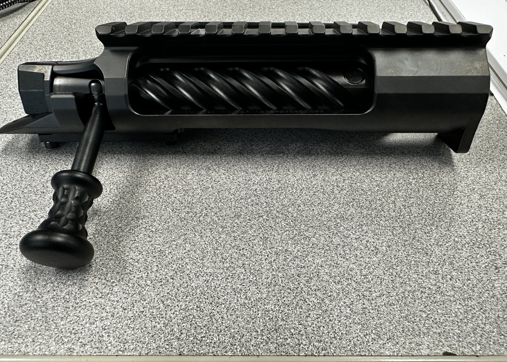

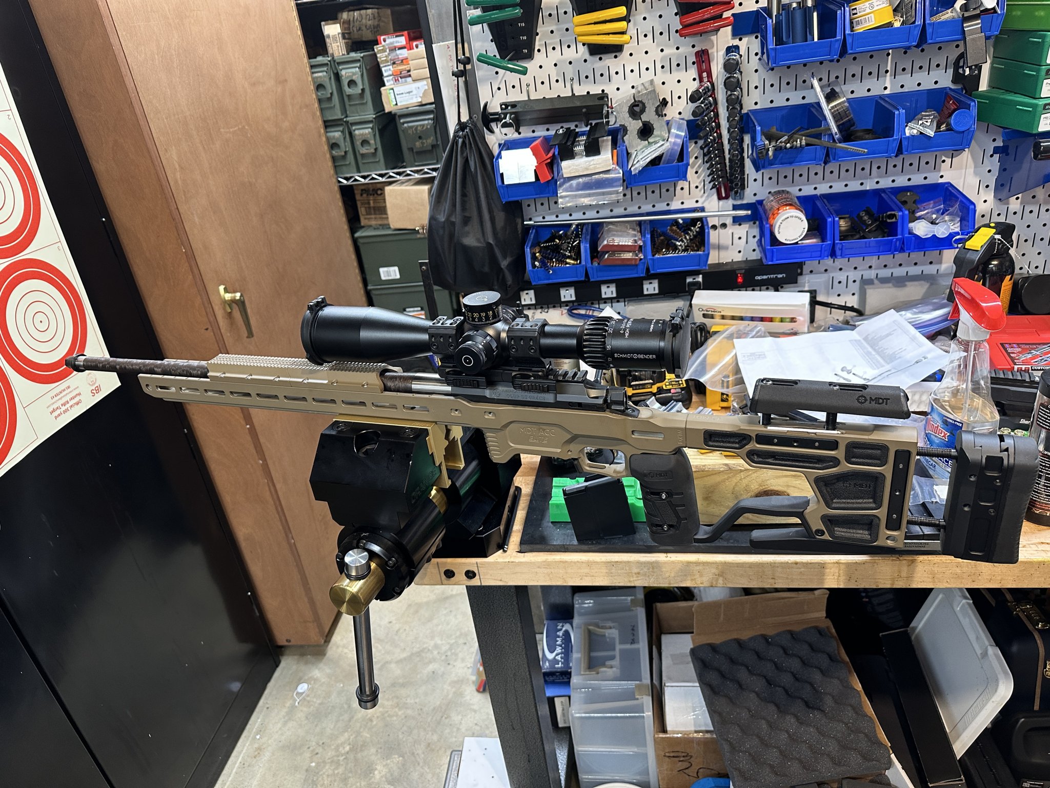

It’s a 22inch Proof carbon fiber in sendero profile. Sent the blank to PVA. Chambered in .308 because I didn’t want any issues with the AW Mags. Also, I’m not planning on going past 800 with this gun. Just meant as the dream hunting rig.What barrel is that? Caliber and length?

I got the same barrel. Lights out with Hammer 137HH and 154HHT! Most lethal hunting round I've tried.It’s a 22inch Proof carbon fiber in sendero profile. Sent the blank to PVA. Chambered in .308 because I didn’t want any issues with the AW Mags. Also, I’m not planning on going past 800 with this gun. Just meant as the dream hunting rig.

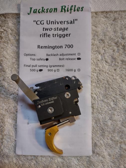

Not knowing anything about the CG Universal, from the picture, it looks like you may have to do some work to make it fit, due to the safety lever and the bolt release. Again, just a guess.I've been following this thread since the beginning and I have a long action on order. Sorry If this has already been discusses and I missed it, but has anyone attempted a CG universal 2-stage yet? Or know if there's any reason its a no go?

Awesome thank you. Was curious who did the blank.It’s a 22inch Proof carbon fiber in sendero profile. Sent the blank to PVA. Chambered in .308 because I didn’t want any issues with the AW Mags. Also, I’m not planning on going past 800 with this gun. Just meant as the dream hunting rig.
You just use normal single stack WSM magazines.Awesome thank you. Was curious who did the blank.

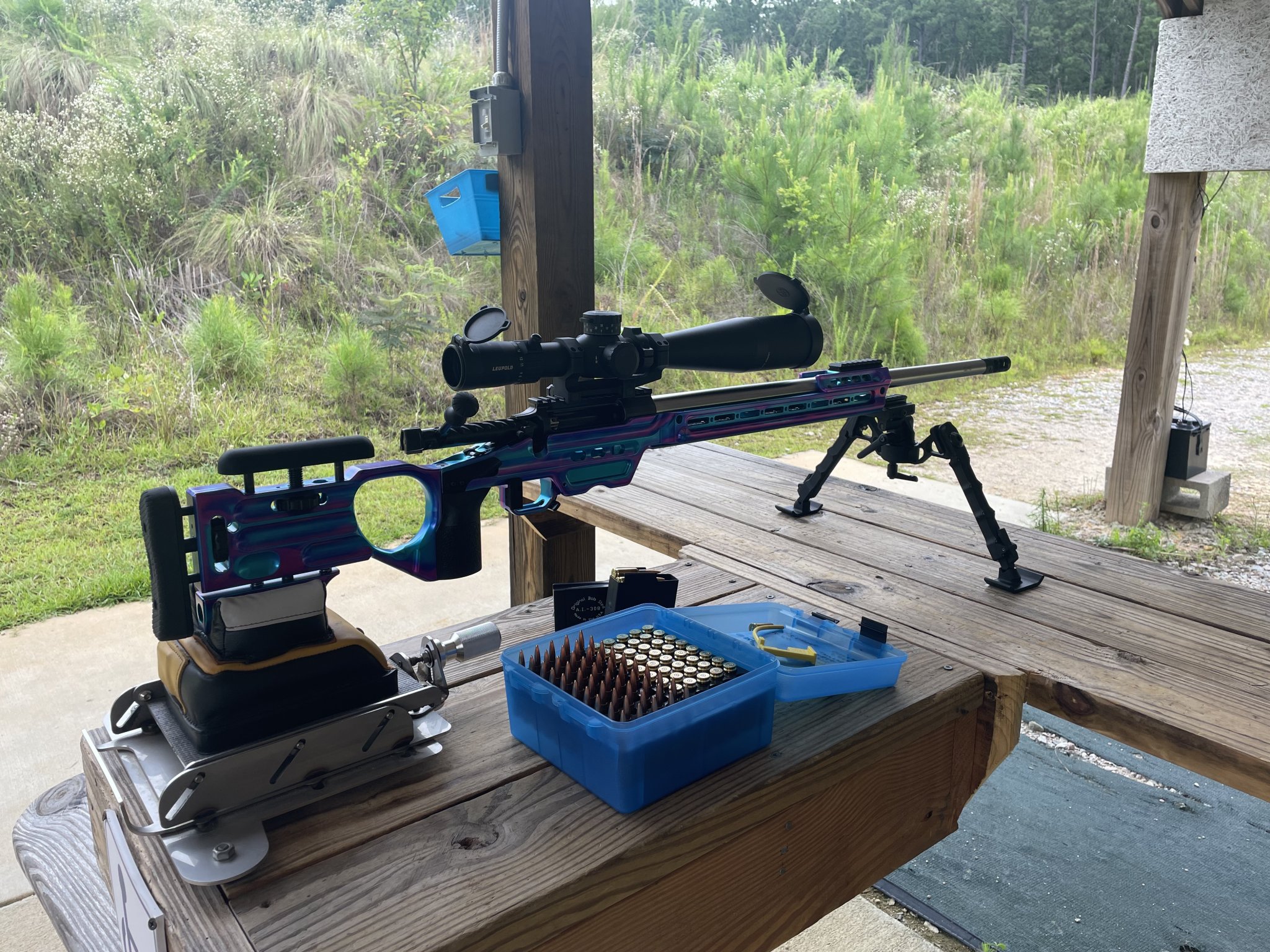

people got secondhand ones? jellyFinally got to shoot my second hand CDG... OMG I love it.. looked down bore to get reticle as close as possible. One shot for a start point clicked in windage and elv correction then stacked round after round. it's better than 1/2moa shooting factory 140eld-m 6.5cm.
Now need to do some load development.
cgd .473bf 30moa
pva 26' proof 6.5cm
hellfire match
tt diamond ssf factory settings
xylo chassis
aw 10rnd 308 mag
accutac- br4 g2
vortex venom ff
arc m-rings med
